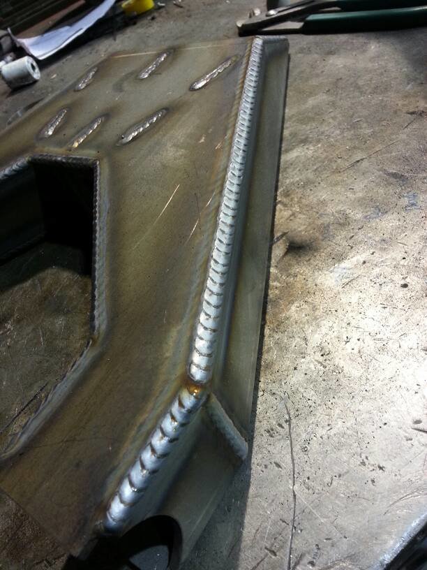

    Another day at the office9use6uza_43ca8d5d3ad9012c39827b0df776b6fb1207d3f5.jpg

    Very nice!! the heat and travel speed is spot on! I'm personally a fan of a tighter bead pattern but that looks damn good!

    Cool, you can make some pretty welds with argon mix. Im betting the LCA above was welded with 75/25.

    Nice TIG welding. What is that you are building?:confused: Can't quite make out what it is going to be:(. How about a shot of it from the other side, and an overall pic of it too? Or maybe a completed pic if you have gotten that far yet.:)

    Pretty certain it's MIG on a LT LCA

    Agreed. Definitely mig

    Its MIG welding. And they are correct, its a lower arm for the 1st gen Tacoma kits I offer
