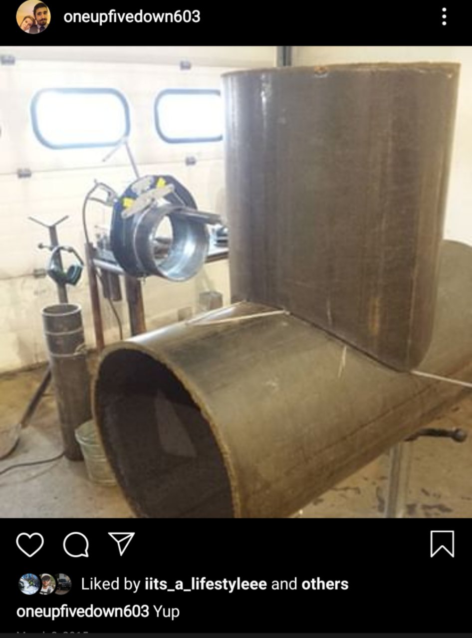

    I was.
    I guess I might not know the whole picture. I'll go back and read what you've got going on.
    But if it's just square tube doing 90*, 45*, 30* bends then it's not bad.
    @81Trekker I did it daily for the better part of my welding career making skids for pipe assemblies. It's not too bad. A wire wheel and air hose cleans it up fine.

    Gotcha. You can still do it with a torch. Just keep perpendicular to the pipe. But if you can swing a notcher go for it.
    I just like to tools that make multiple processes more efficient.
    For layout too, if you haven't already you can look up pipe wraps for fishmouths. They work well and you can draw / print your own.

    Hahaha I cheat, it's a lot bigger so it's much easier.

    I'd like to see a video of someone doing this on 1.75 MS or 1.625 CM tube. This is 18" pipeline technique.

    Not really. I've done plenty of 2" xx tests this way.
    And per your request.
    https://youtu.be/uYFBJEJTuOY

    Like the guy in the video said, for fence work I could see it off the back of a weld truck. Most of what we're talking about here is fit up with a +/- 0.1875 tolerance. Gap fill needs to be less here and in CM, no gap at all. Trust me I've seen magicians with O/A and I'm good freehand with plasma. I'd use a grinder if I was in a pinch. (pinch meaning my hole saw has 6 broken teeth and I'm using a quart of cutting fluid and a half a fire extingusher every cope)...lol
