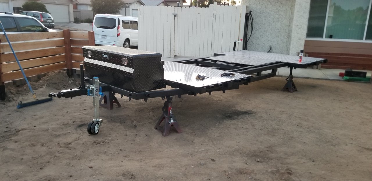

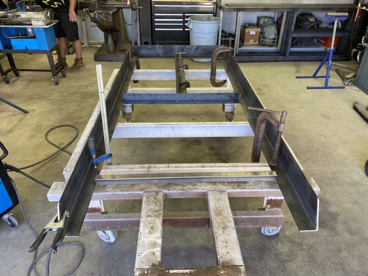

    Almost at the finish line on the trailer..

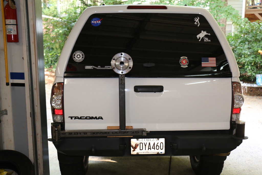

    After read what all you guys are building, I started building my tire carrier/swingout (after way too many years...)
    I have an angled brace to cut and install, then I need to decide how to latch it. I currently have 2 ideas I'm working with.
    Quick question - can I cut with a hole saw on only 1 side of the saw? I need to cut a curve in the end of a piece of square tube (for the angle brace), and only need to cut through 1 layer of steel.
    I don't think you can (safely) but I thought I'd ask.

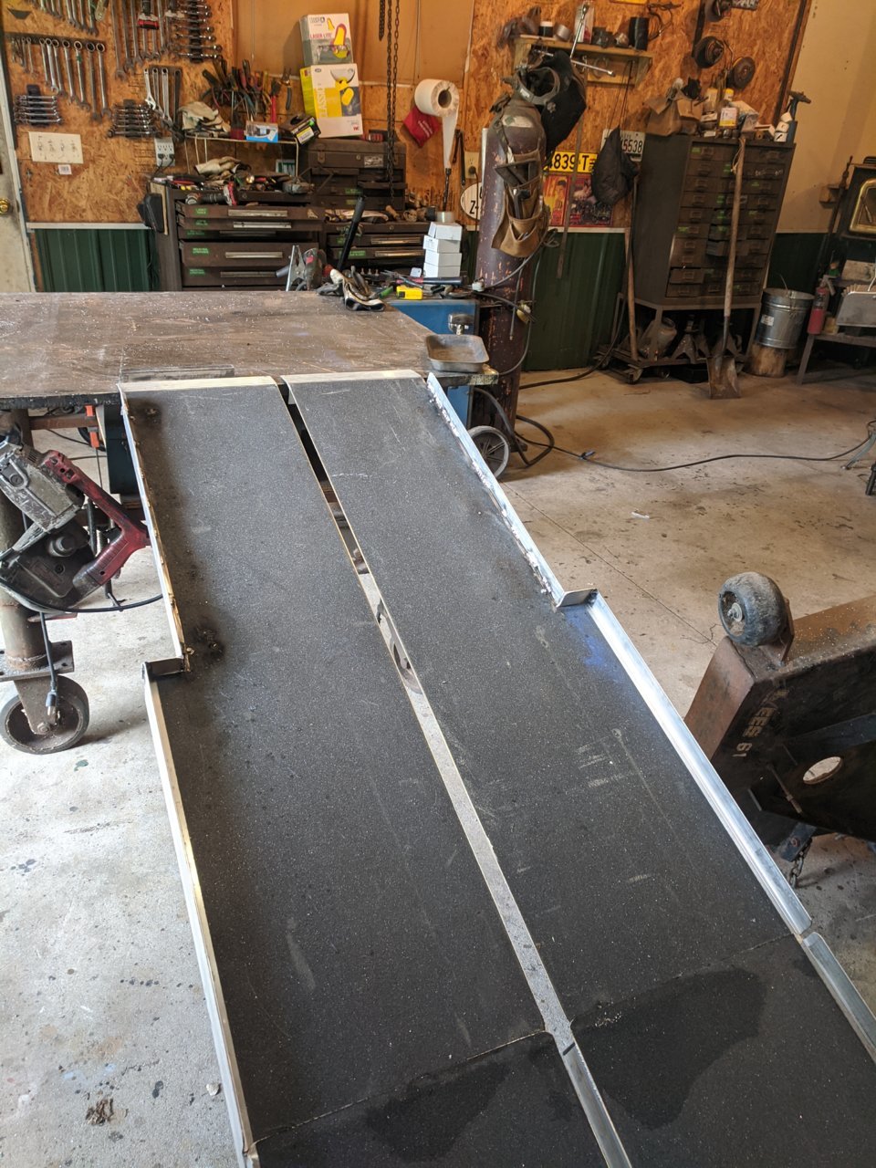

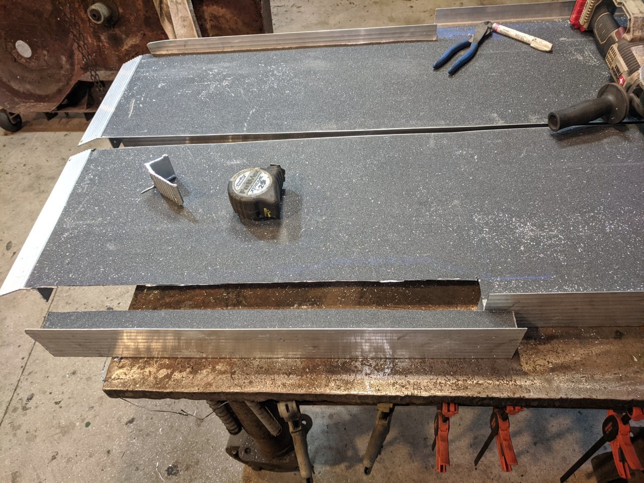

    Reserected from the dead.
    Handy cap ramp modification. Needs to be wide enough for the wheel chair, but narrow enough to fit thru the motor home door.IMG_20200719_100518.jpg IMG_20200719_115339.jpg

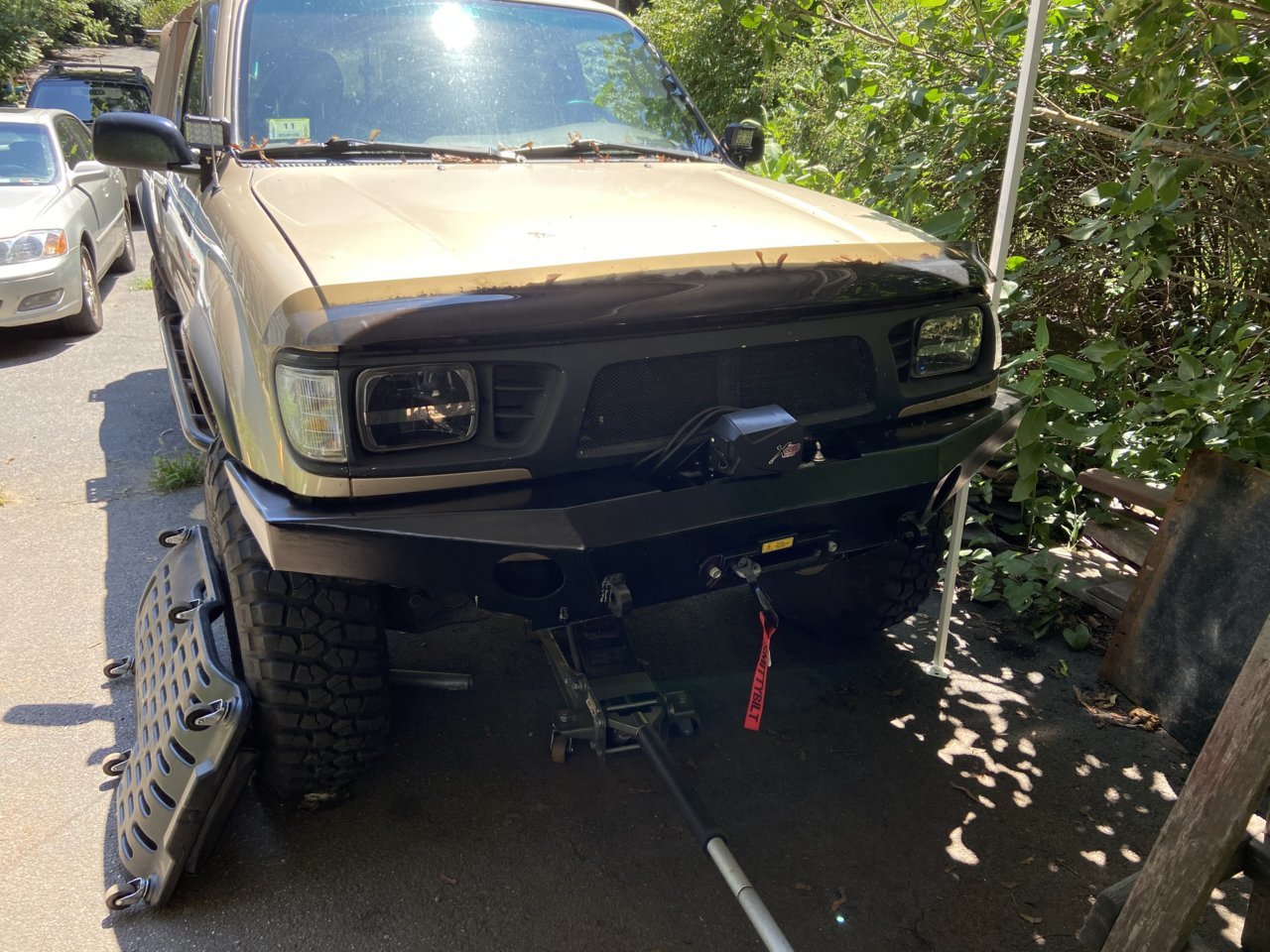

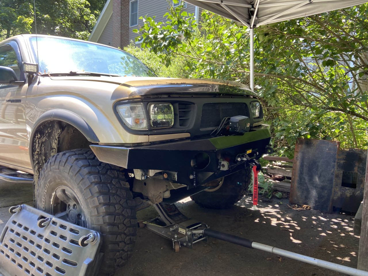

    "finished" my bumper redo... I will need to go back and weld on some tabs to mount my fog lights. I'm on a serious time crunch to get the truck wrapped up to make the Toyota Takeover on Friday.
    now I'm throwing together a skid plate. I think the paint will dry on the drive down to PA :rofl:

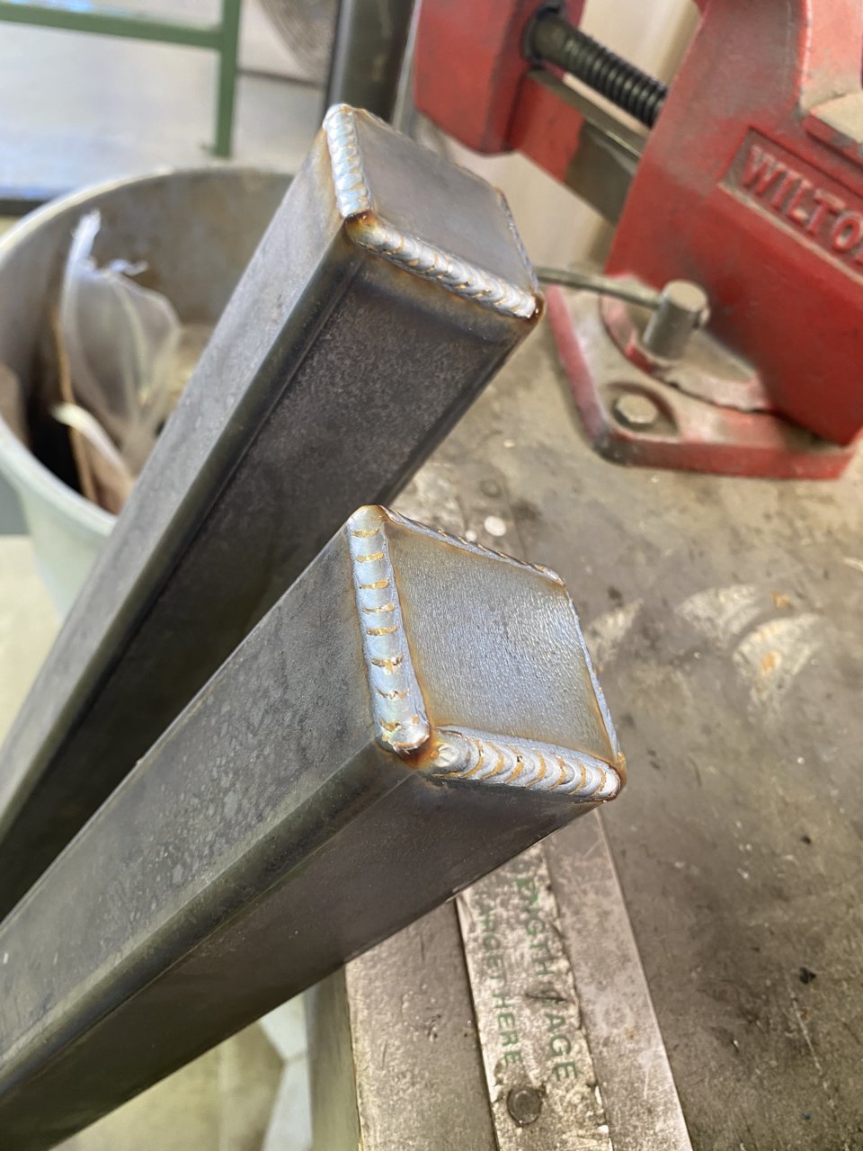

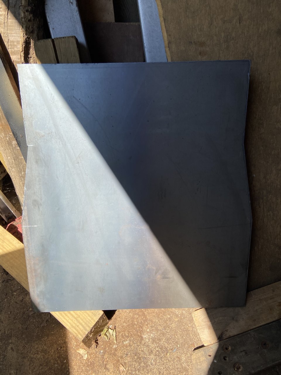

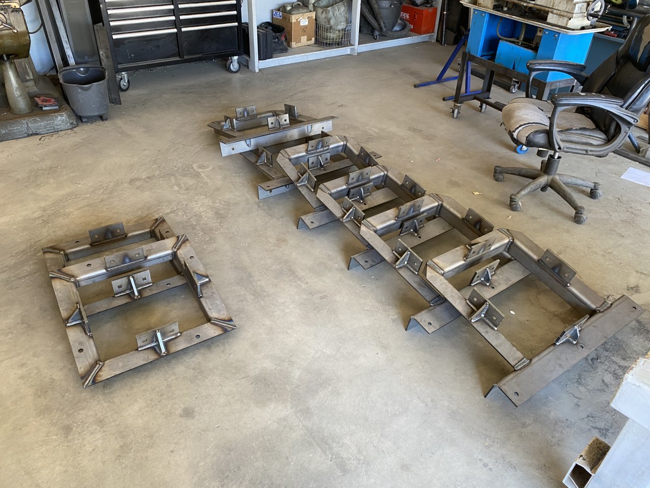

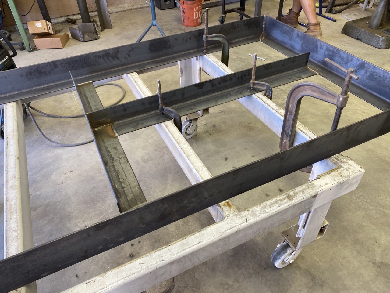

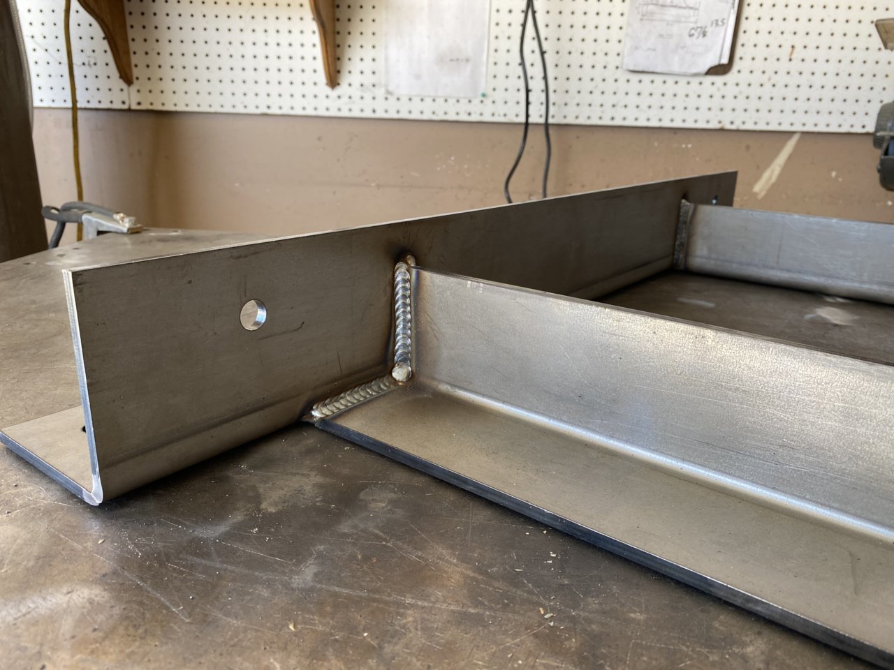

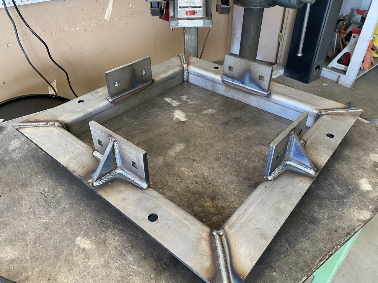

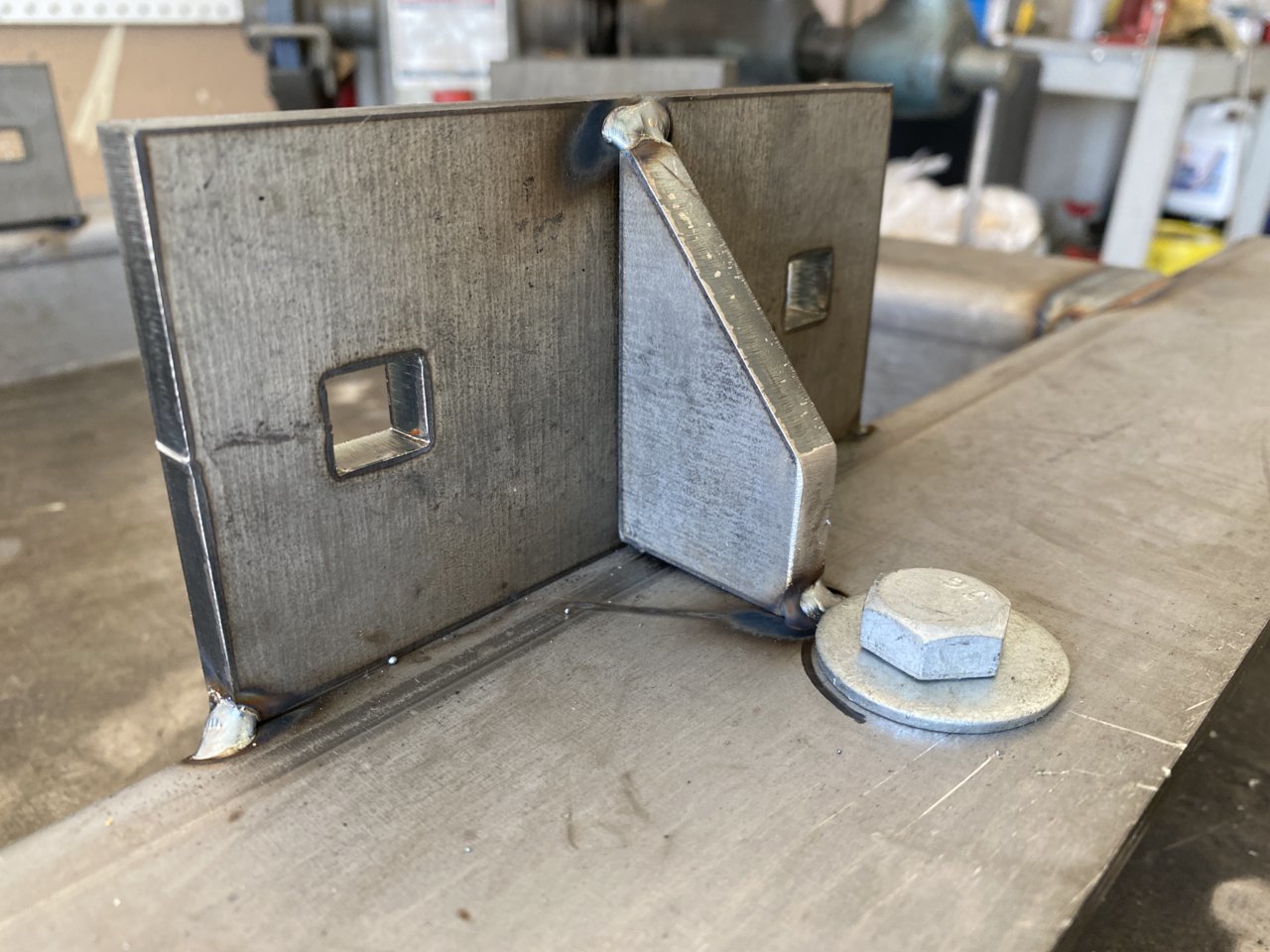

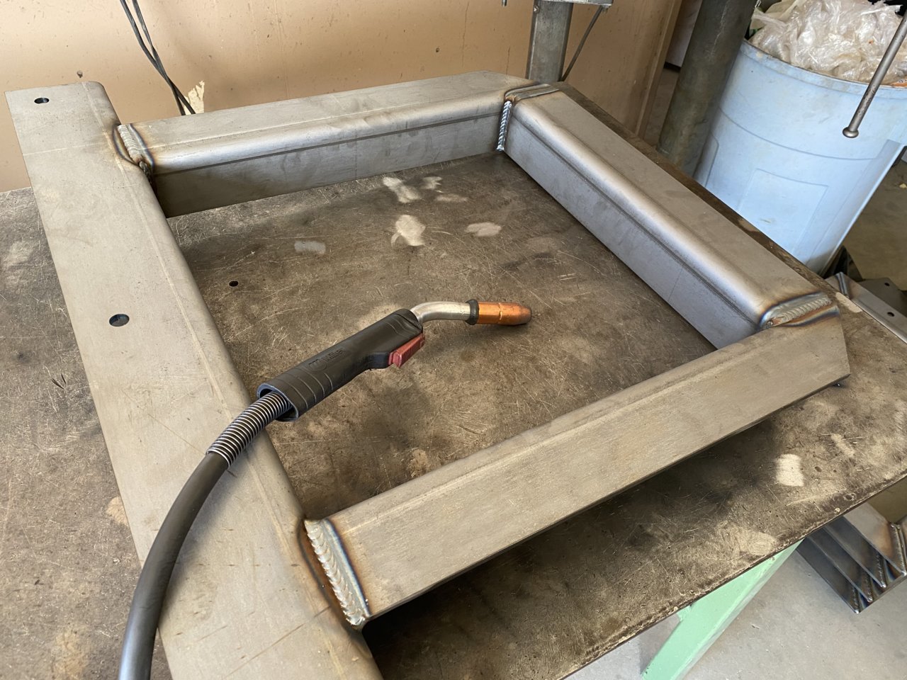

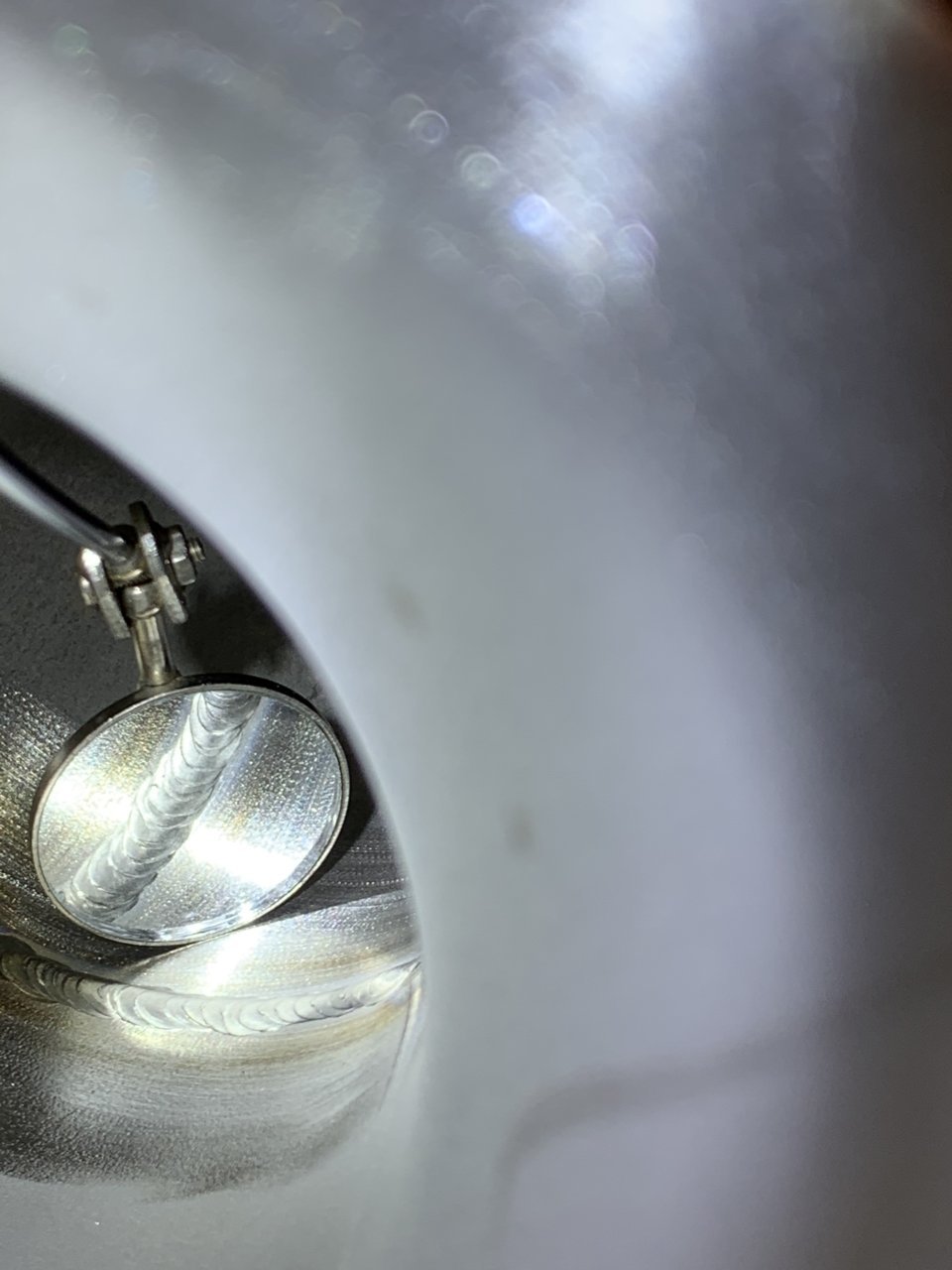

    Busy busy busy over the last week. Random pics because the threads been slowwwww
    28F9867D-C3AC-4D31-B4C9-B7059766DEF3.jpg 908FF4F8-0C24-4648-B84C-FD93B9F7B799.jpg AF5EA884-8767-470E-A877-32ABDDC53D01.jpg 9CFC6E7E-9CA4-4FE3-99F7-5ECD7283D5BB.jpg 825750BF-0198-4D21-B743-BEC5ACE824BF.jpg 970322C7-401E-4F02-9349-BCB291E11677.jpg 09C34B5B-56F5-4D1F-9C41-72C9AF88DCF0.jpg CD499C87-6B21-4BAA-B433-7D8067AB4AA1.jpg B6C00A2A-0038-4575-8BDA-B2E273E6138D.jpg 9A093F8A-15E8-4F2B-8F14-6CD3F2B33FB3.jpg 8C9A5369-FD54-4511-B617-2863C627D256.jpg

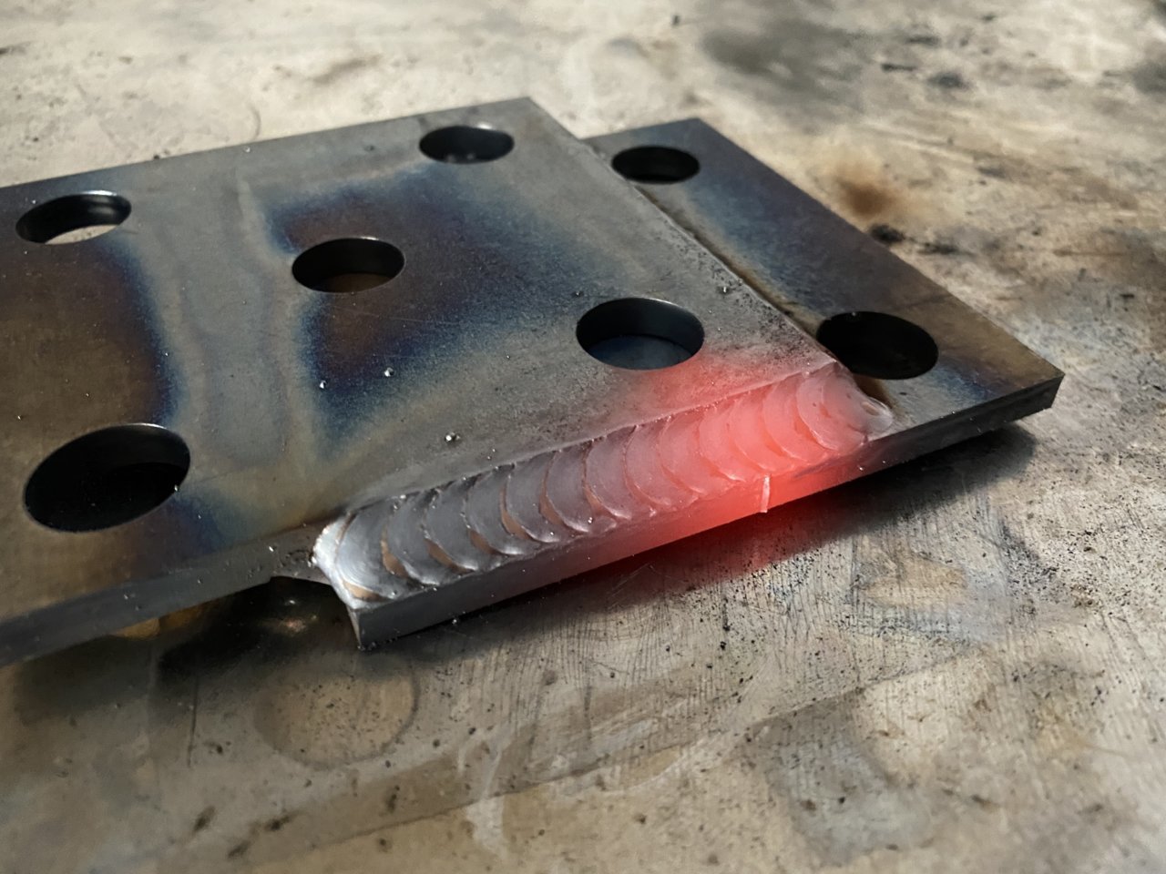

    Drop bracket lift and booger welds
    For these, I am assuming you are turning the piece to get the weld in ideal position every time? Or are you that good that you can make a vert not look like a vert lol

    Those are all vertical welds where it looks like. I just tack everything and spin it clockwise on the table welding everything.... when you do a bunch of them you start to feel pretty comfortable on all the joints

    Downhill I assume?

    Looking at the pattern, they are downhill welds.

    That's what I thought as well. I love welding vertical downhill. That's the easiest for me to get a nice looking weld.
