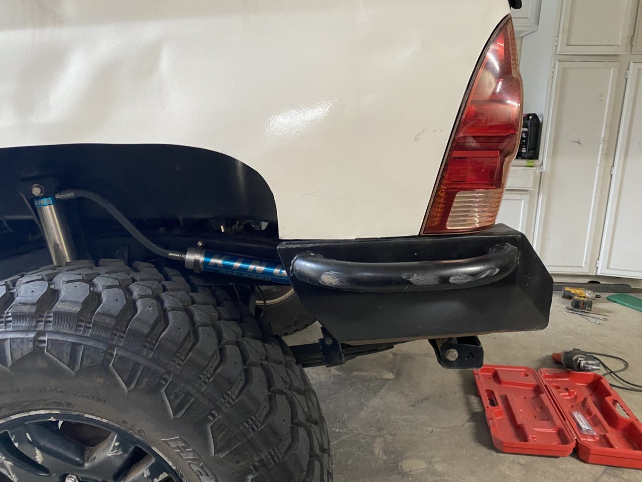

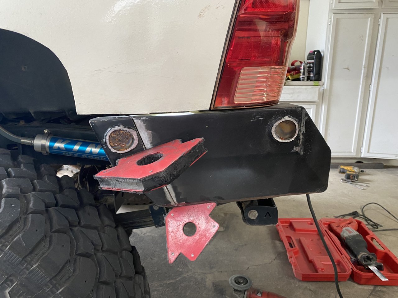

    Well I WAS shortening my bumper by 1” but ran out of wire right as I got it tacked up. This was the fastest I‘ve went through a 10lb spool, only 2 months.

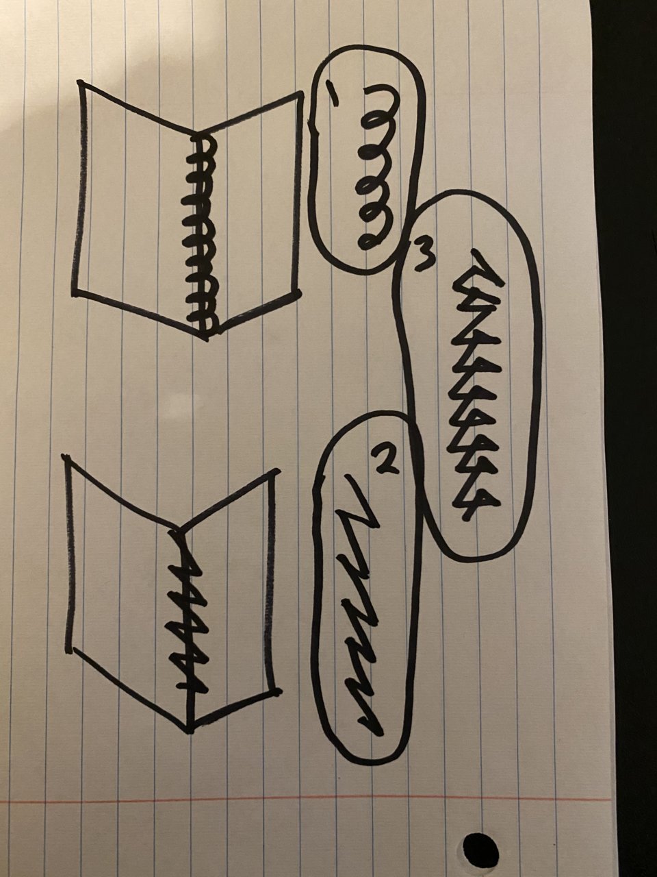

    I’ll use one of these 3 usually. Depending on hot hot the welder is, how thick the material, and how the material is welding. I wasn’t officially taught any specific way but these seem to work the best for what I do E1C5A03A-F8F4-464E-955F-93E9FCEA973C.jpg

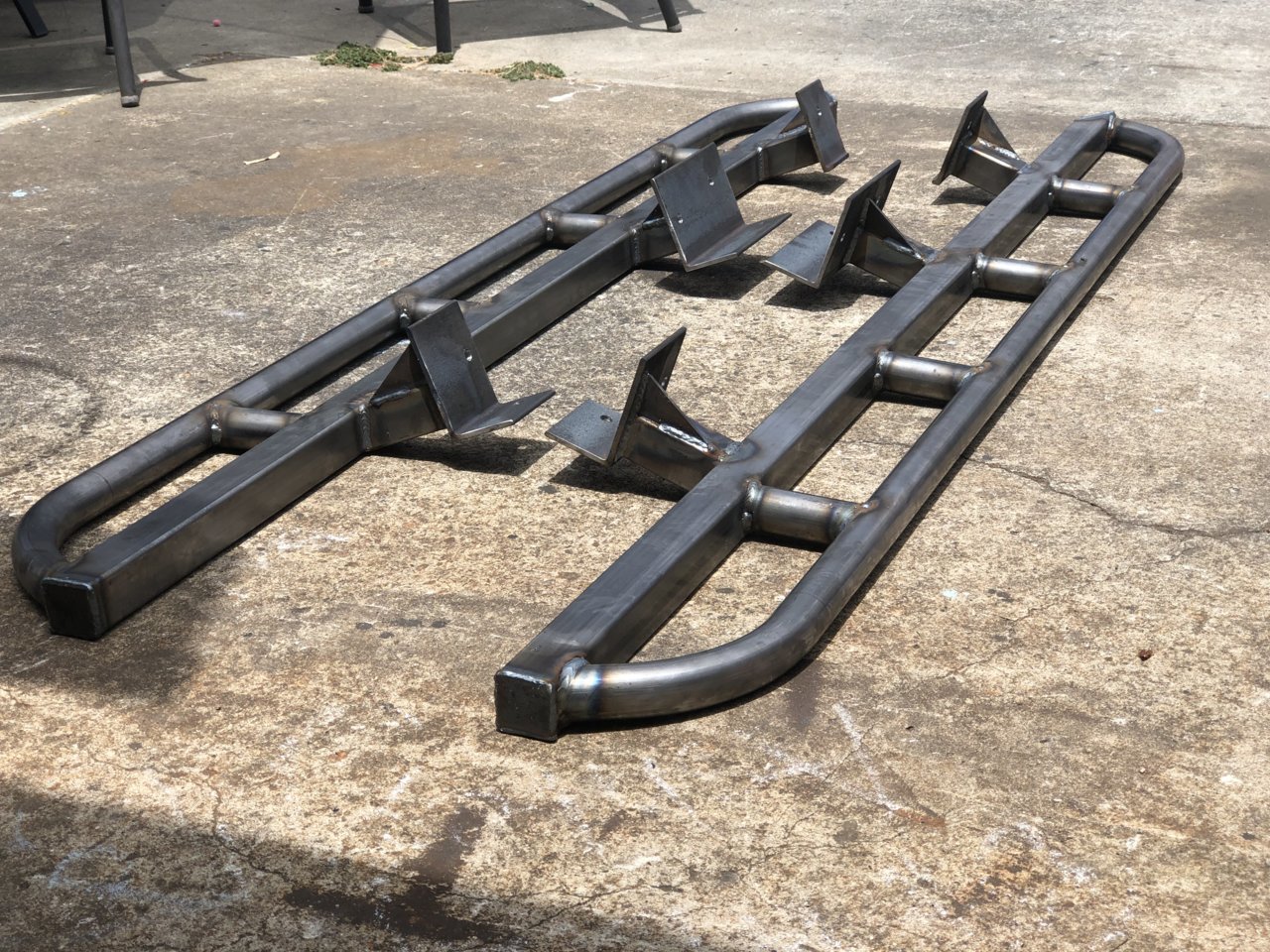

    More sliders. First one without kickouts in a while. 15 more sets to build

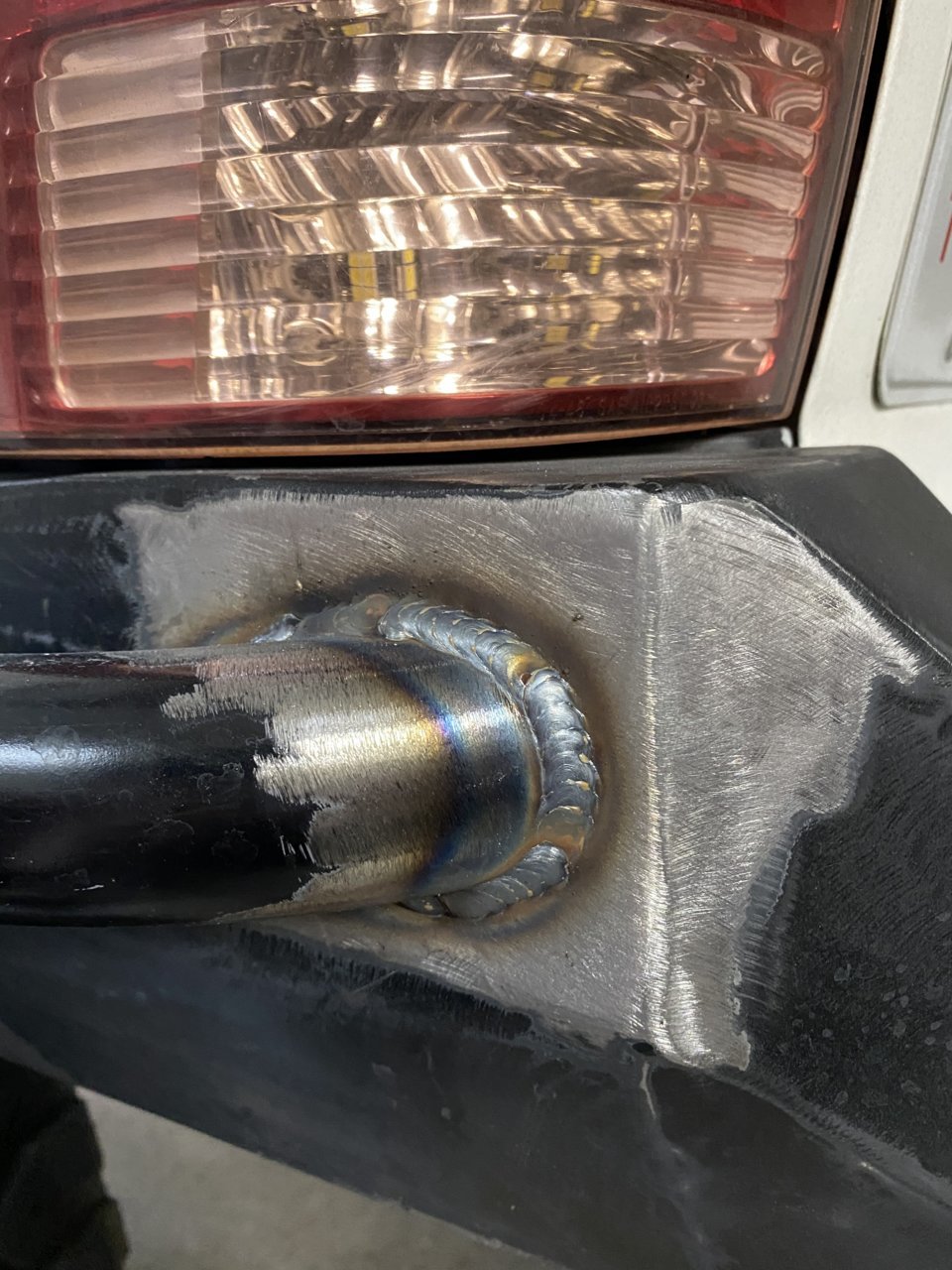

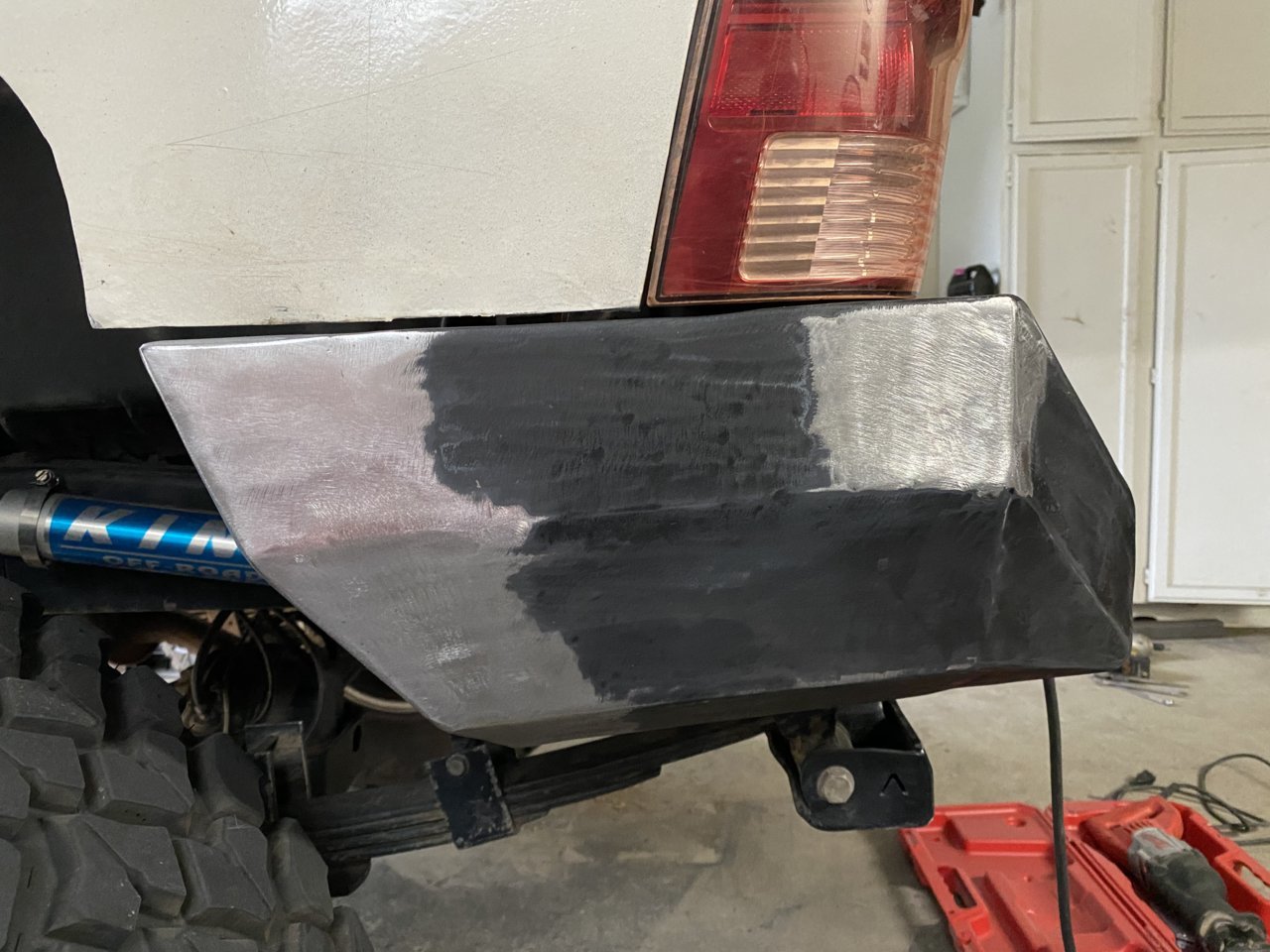

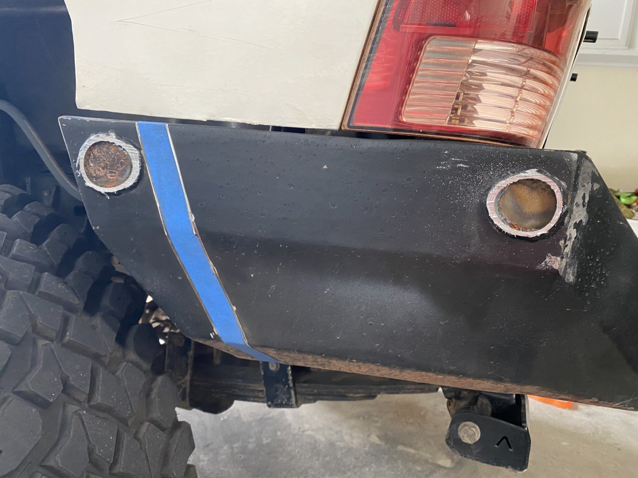

    This time around I really wanted to focus on getting better with metal finishing and see if I could make it seamless. I’m pretty happy with it.

    interesting I didn’t think to use the cursive e going down. Now I wanna play with more vert stuff.

    That’s the way man, it’s a piece of cake to get nice welds doing that.

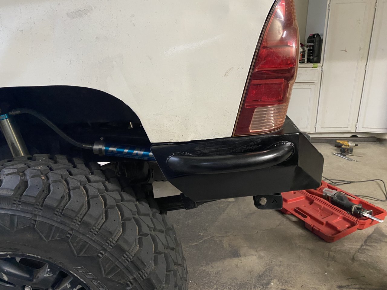

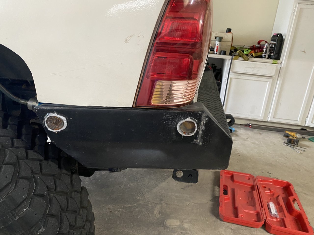

    Got it all buttoned up. Came out great.

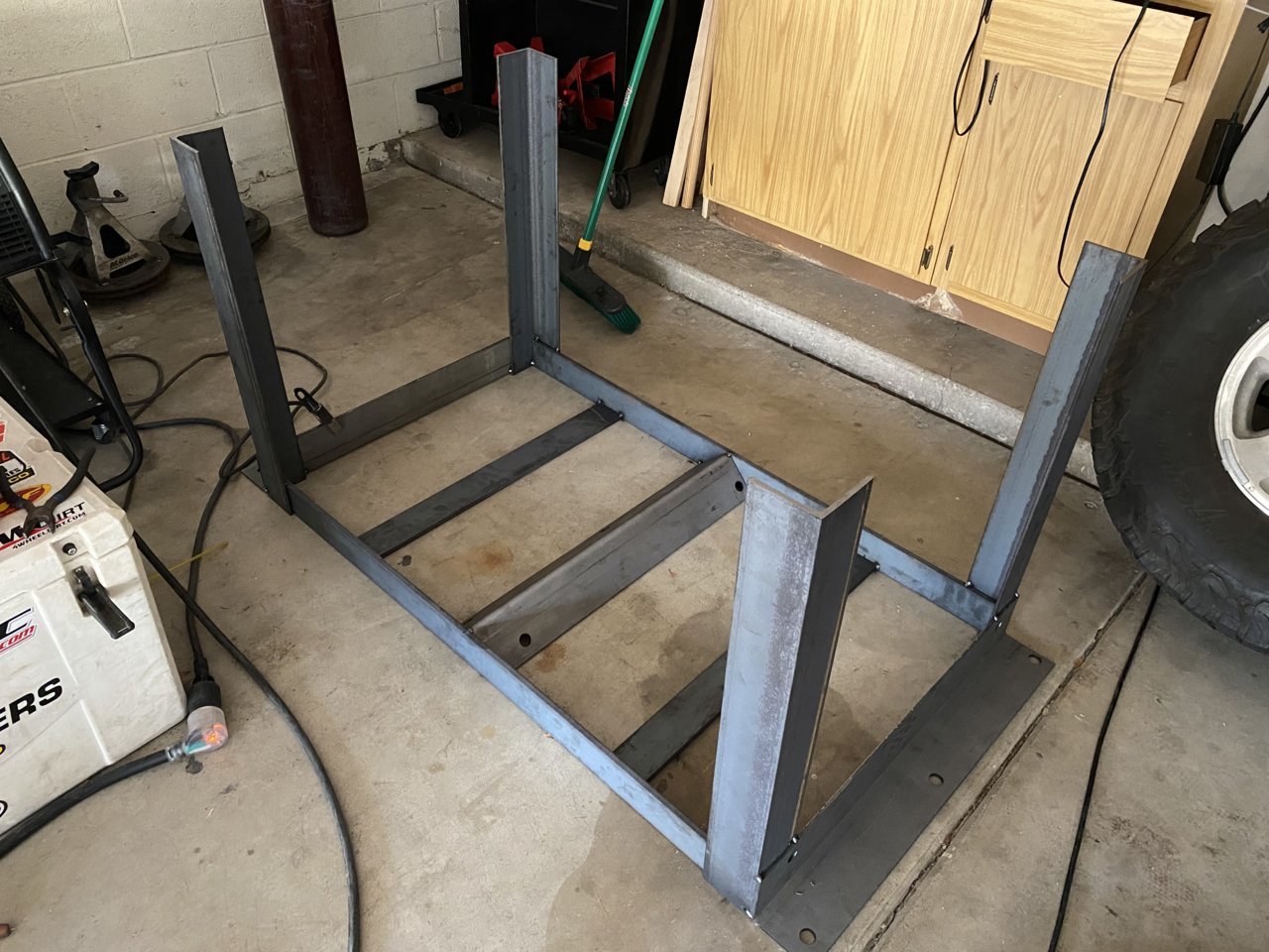

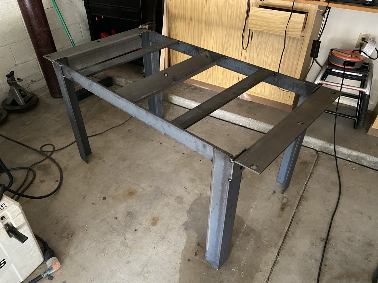

    Cranked out this table this evening. Tomorrow it goes on locking casters and in a few days the top goes on. Had to build one after seeing how much people wanted for fully built tables

    For the round tube are you doing cursive e's there or big C's? I feel for those weird tube welds c's come out more consistent for me.
    I completely agree for uphill, it's how I learned uphill, but we are talking down. Not saying you are wrong because I have only done a handful of vert stuff, just clarifying.

    Cursive e's. That's the only way I know how to get anything close to the stacked dime look. I tend to do that motion when I have good fit up. If there's a little bit of a gap, that's when I tend to do a large C, with a little pause at each leg. I can fill ~1/8" gap like this without any issues.
