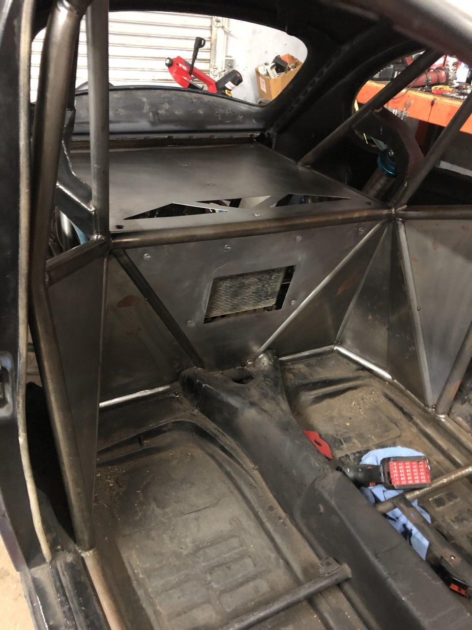

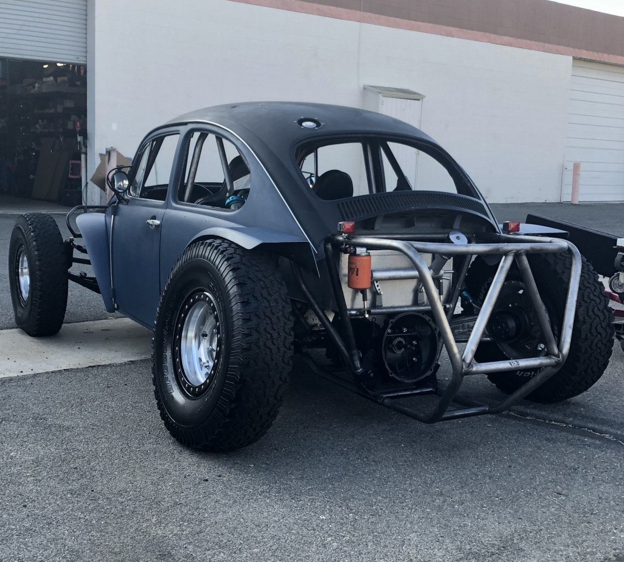

    I hate Baja bugs but this one came out kind cool. I refuse to work on them but since this one was for one of my best friends I swallowed my pride. It has center mounted arm and I got 19” travel in the front and 18” in the rear

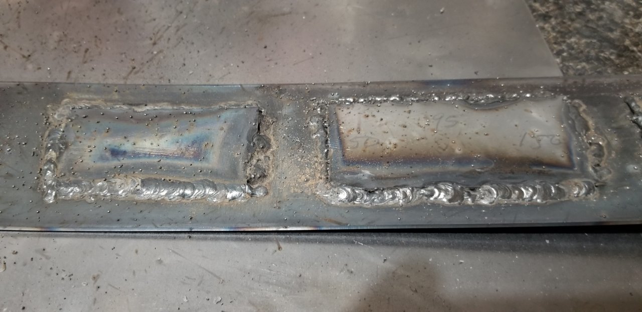

    Thanks, I had almost forgotten to do that! First impression with gas and 0.023 is mixed; I'm still playing around with settings, will post pics hopefully later today. Splatter is almost non-existent, which is great, but the bead looks more like cake icing from a pastry bag rather than a bead of caulk like I was getting with flux core. Can't seem to get the puddle to "flow", it looks lumpy when I finish.
    I should probably run through all the setup steps to make sure I didn't forget to change anything from 0.030 flux core to 0.023 straight wire, but I went through the instructions pretty methodically and don't think I missed anything. A lot of variables in play right now with me at the bottom of the learning curve; it's hard to single out the one that may be causing the problem. That being said, I'm thoroughly enjoying myself! This is all next level stuff and I'm sure I'll eventually get it sorted out.

    That's what's referred to as being "cold". It just means it's not properly penetrating and you'll want to turn up the welder settings. It also depends on what type of joint you're welding. For example, let's say you butt two pieces of tube together nice and flush. If you weld it like that, the puddle has nowhere to flow and it will appear like icing from a pastry bag. If you post pics, that would be helpful. You'll get better, just takes time.
    Side note: I've never tried 023. I've found that 030 is a great all around wire and I've welded from 1/4" down to like 20 gauge with it.
