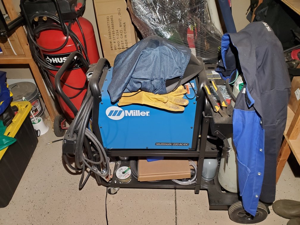

    I have the 215 and have tried the tig a few times. Only complaint is it’s scratch start vs high frequency.

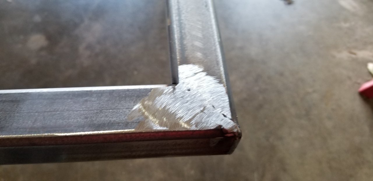

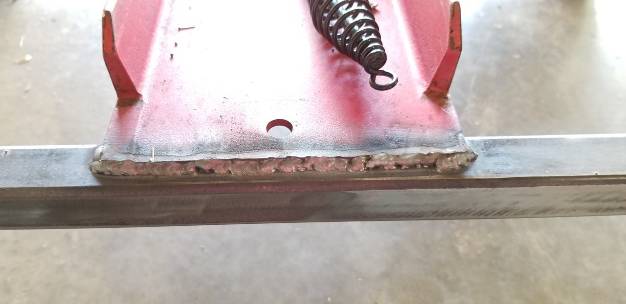

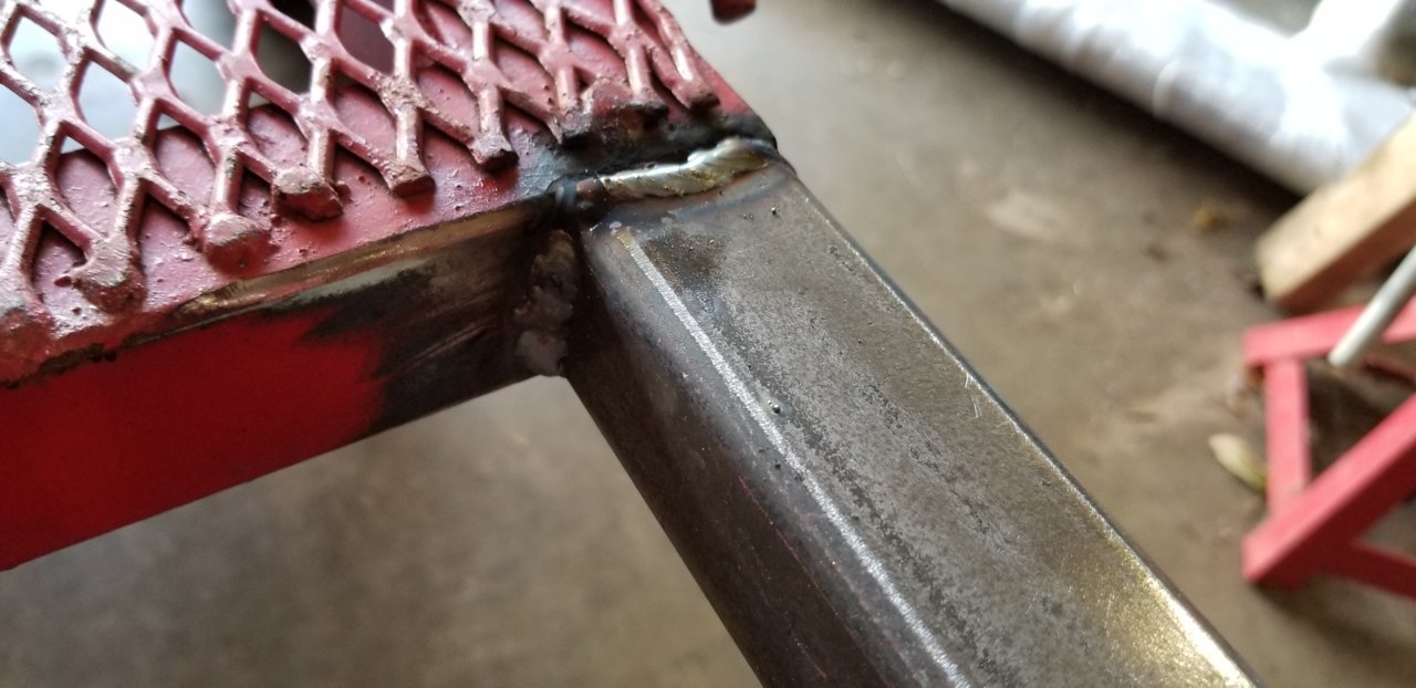

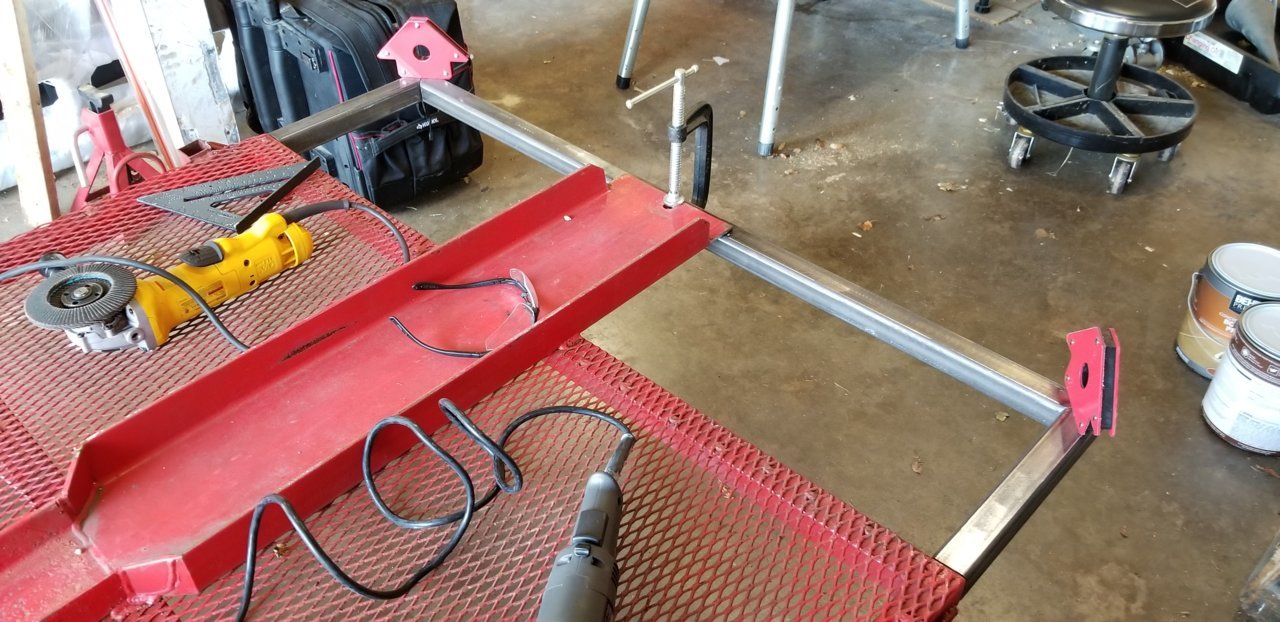

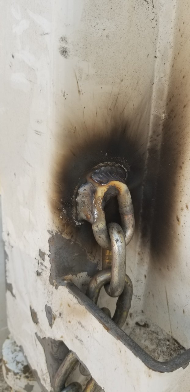

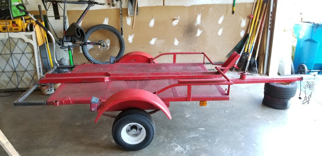

    Finally made the move from practicing on scrap metal to an actual project. I have an old motorcycle trailer someone gave me a while back I've decided to modify and make it also function as a utility trailer. First step is to extend the back of the trailer to be even with the end of the tire track (which is a 1/4" thick C channel) to make it easier to get a zero turn mower on and not have the mower deck bottom out on the C channel. Used 1-1/2" square tubing (1/8" thick) to match the existing trailer framing.
    Overall I'm happy with it. The welds aren't pretty but I think they will hold. Looking back I think I was just going too fast and didn't let the puddle build up enough. My heart may have been racing a little haha. As always, your feedback is appreciated.

    It's funny you mention your heart racing. When I started out, I was the same way. Sewing metal together with fire is exciting stuff.

    Looks good, the one thing I see wrong is your axle is forward of the center of the trailer now. Not enough tongue weight is a bad thing.
    Here's a video of not enough tongue weight.
    https://youtu.be/6mW_gzdh6to
    You don't want it to start fishtailing on you, I did that once with a skidsteer. Luckily I didn't have a wreck :thumbsup:

    Definitely not for the faint of heart, but very addictive.

    Very good point, I hadn't thought of that. Fortunately the extension on the back is just to facilitate loading and avoid having the mower deck scrape the C channel. Otherwise I plan to have the mower (or motorcycle, etc) all the way forward, so hopefully I won't have any amplified fish tailing.

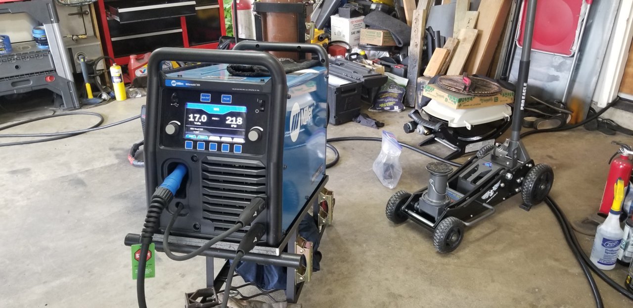

    I haven't posted in a while, but I upgraded my welder from a 211 to a Millermatic 255.

    Even though the M255 machine and torch is bigger, it still welds the small stuff pretty nice. .030 wire, C25, 1/8" plate.

    I still have the 211 too. Sometimes my 211 would weld somewhat erratic when turned up high as if it was reaching it's limits. The 255 is pretty smooth at all settings.
