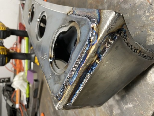

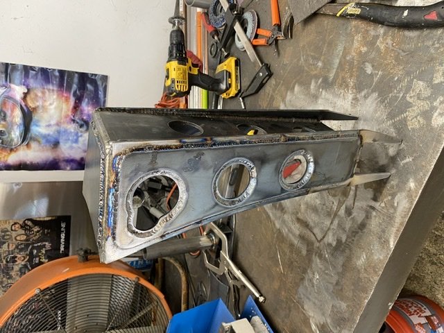

    Coilover tower coming together

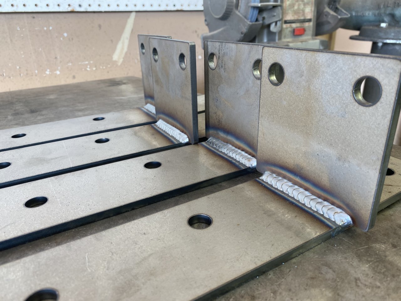

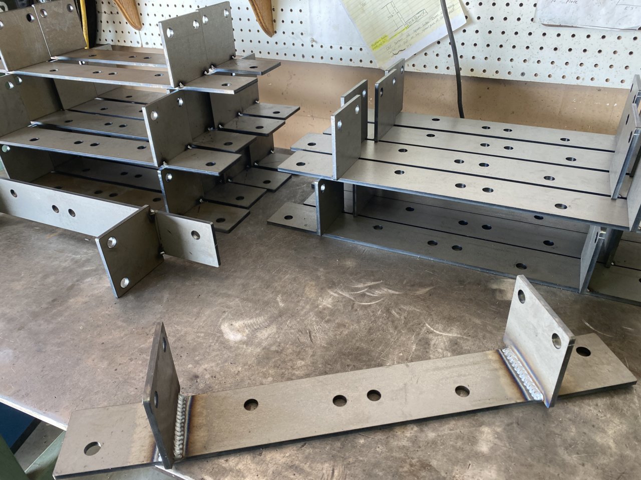

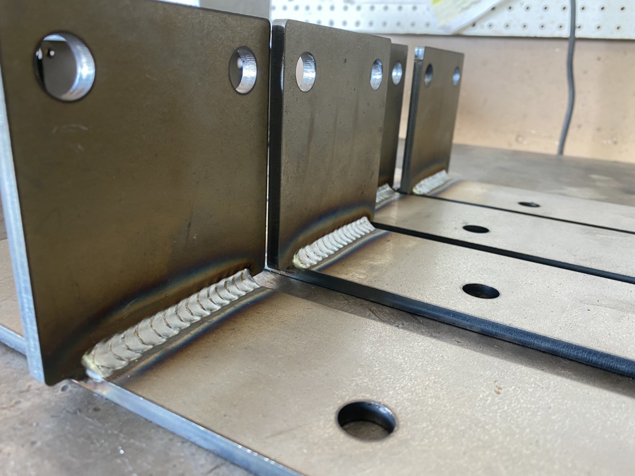

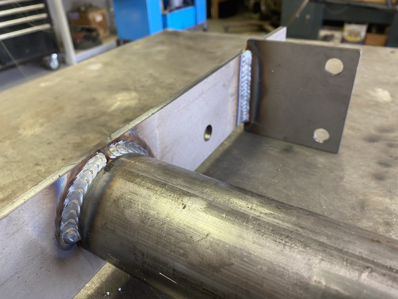

    Simple simple simple

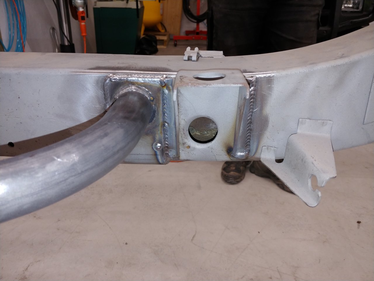

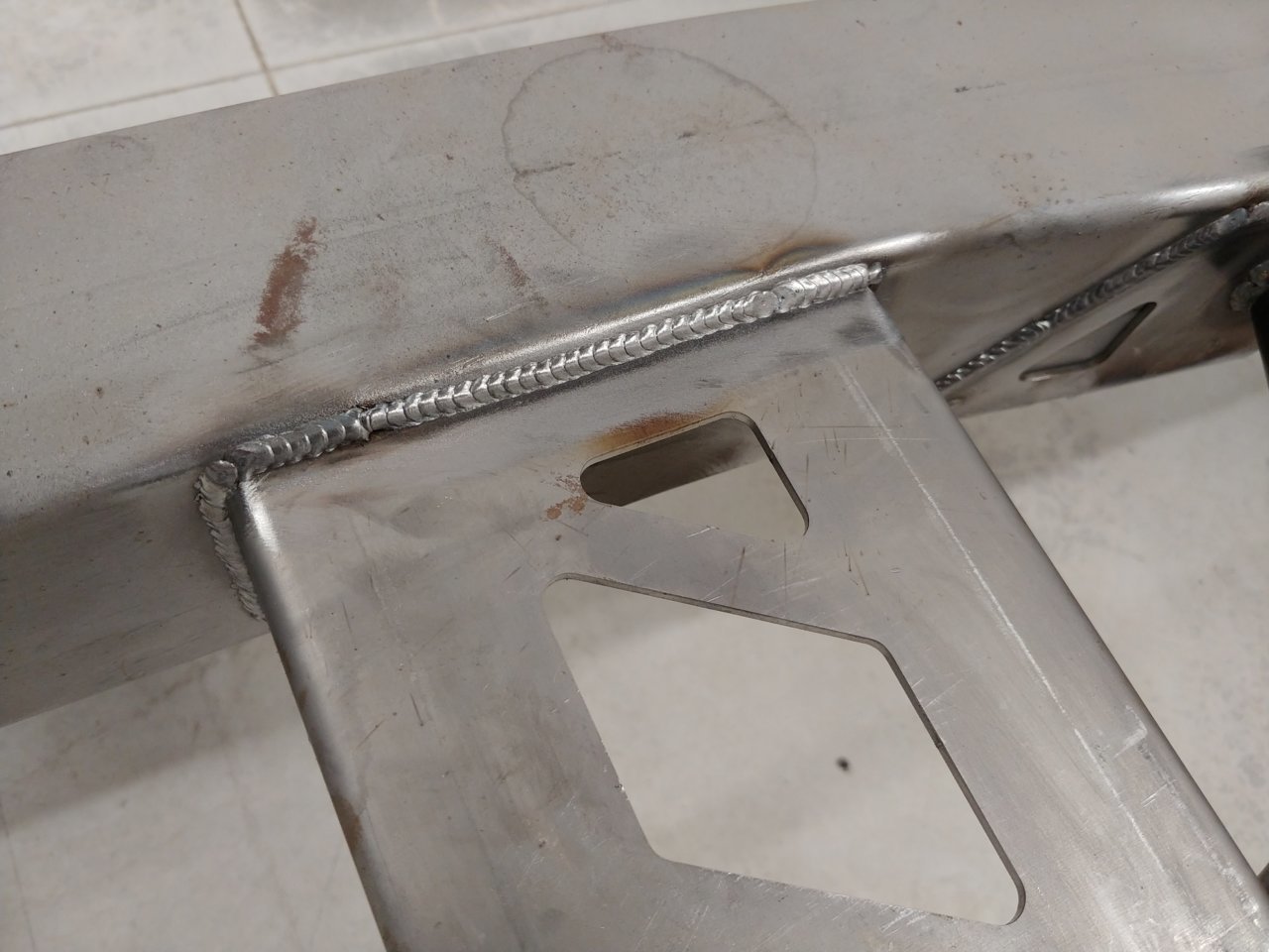

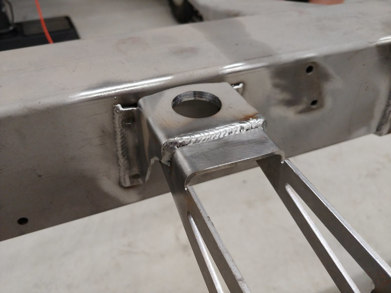

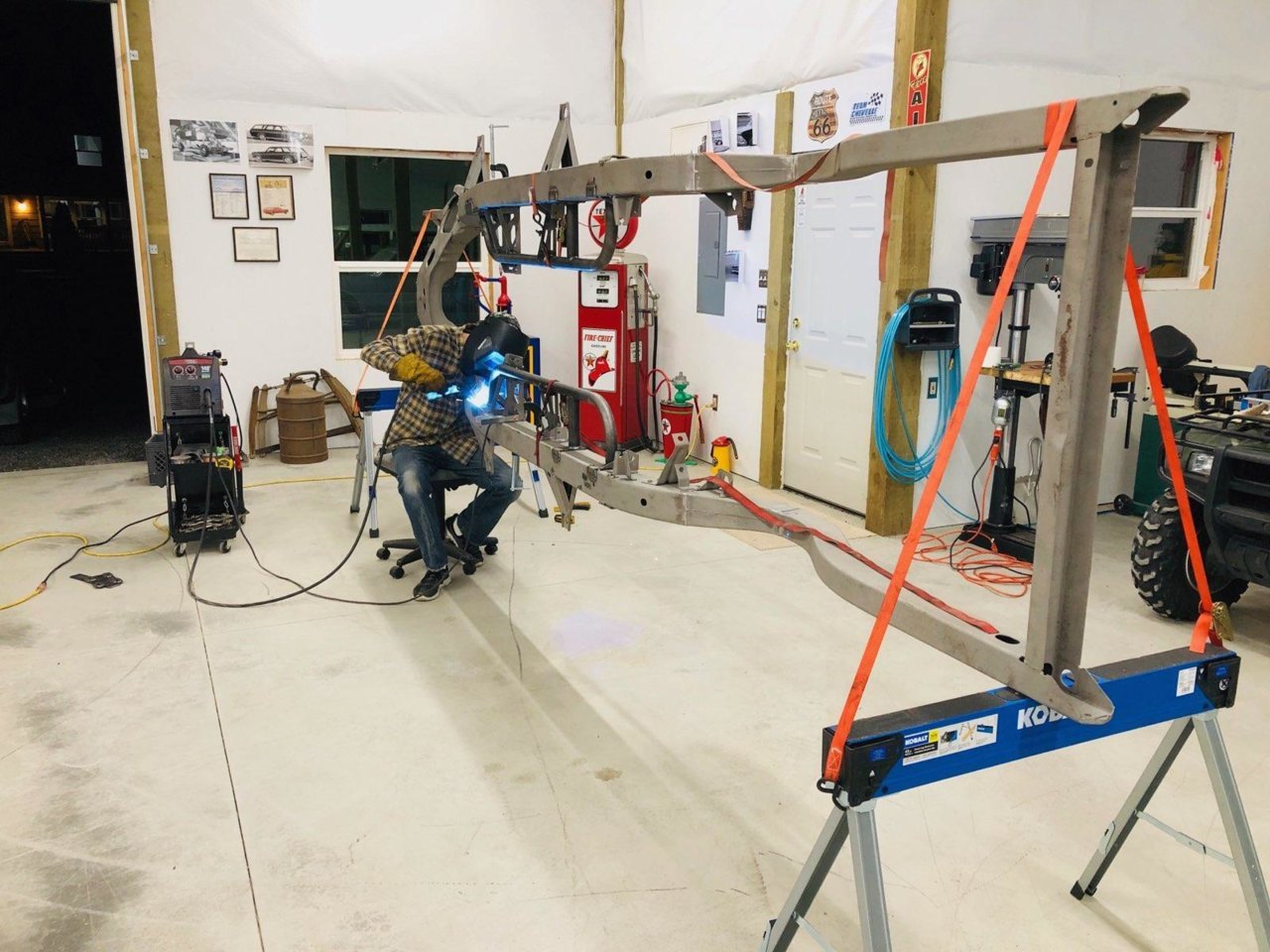

    Welded a brace/x member kit on a 1955 Chevy 210 frame the other day. I pleased with it
    Have a rear cross member for shocks to weld in and a leaf spring frenching to do still, but progress is progress.

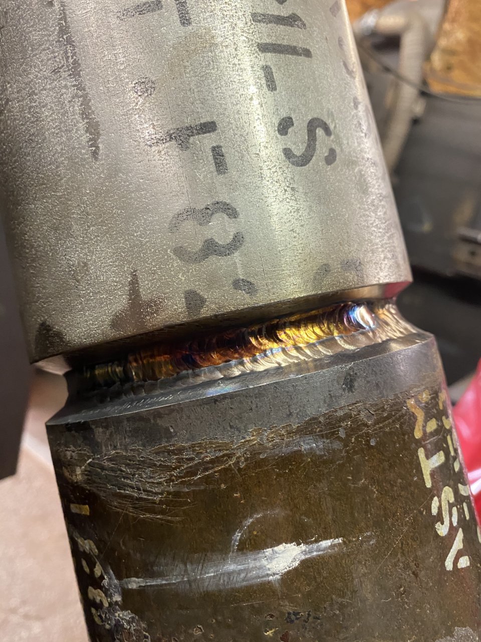

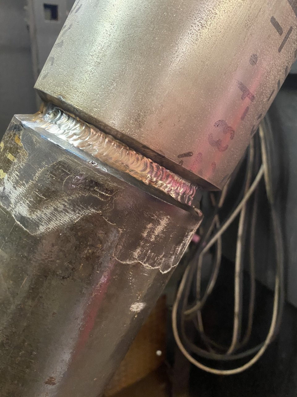

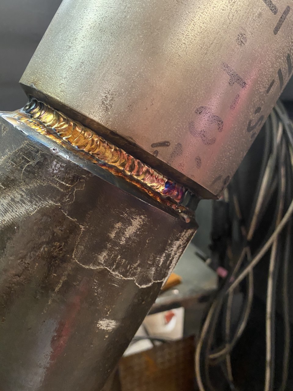

    Tuesday funday. Or whatever it is. Practicing for a stainless to carbon heavy wall test at work.
    there’s a couple arc marks that were on it previously when I got the piece to practice on.

    What's the process for that?

    Stick the pipes together and weld em out with tig.

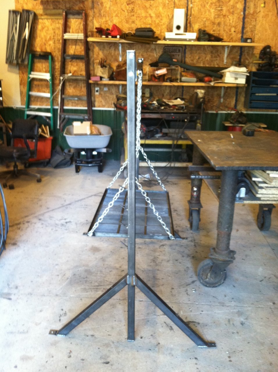

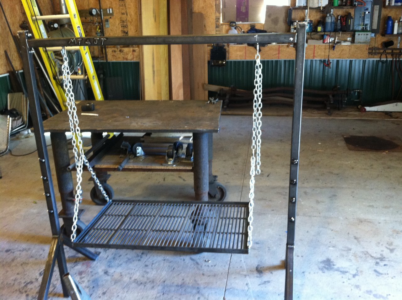

    Campfire spit/cooker I made for a coworker a bit ago.Super Cooker 01.jpg Super Cooker 02.jpgI fabbed it up so it would be 3 separate parts. It was built in central Michigan, but needed to travel to the Northern Upper Peninsula.

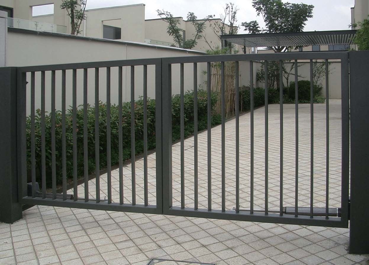

    I've seen a few metal gates from members on this thread and figured I'd reach out to the brain trust here. I'm looking to build a metal gate and could use some assistance.
    The gap is roughly 18' and I'm thinking about doing two 8' wide x 4' tall metal panels that look similar to the picture below...
    Building the panels seems pretty straightforward, but it's the rest of the build that I'm unfamiliar with. Does anyone have recommendations for hinges? Also, how have you done the posts (i.e. how big, bury depth etc)? Any pics of your builds and recommendations are greatly appreciated.

    For posts, I would use metal, like a 6x6x1/8 wall and cement them deep (2 feet or so). Then hinges, go to your local steel supply store, they’ll usually have hardware there. Find the beefiest greaseable hinge you can use for your gate doors and weld them on.
    Ive never made a gate like this but the above would probably be my approach.

    I just got rid of my dual, swing gates and built my own cantelever gate. 1 piece that slides 14' open. If you have the room, it's much more simpler than dual gates. The constant adjusting to combat the sagging was driving me mad (ocd thing). I'll look for some pics.
