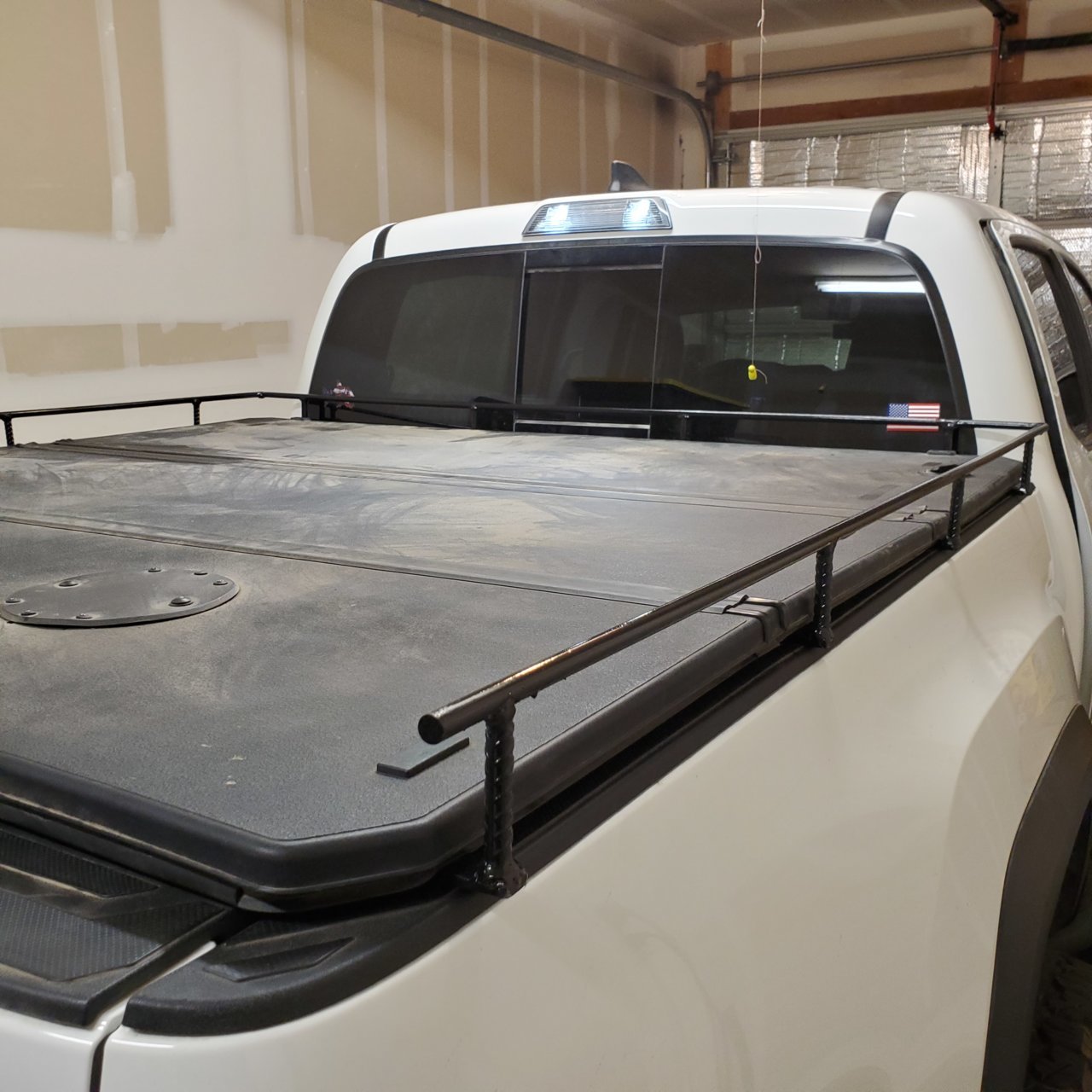

    Anybody know the settings for .035 blue demon gasless flux core wire. I tried welding 1/2" round bar to 1/4" flat bar and the recommended settings didn't work out. I used dcen. No flux coverage. Maybe this wire sucks? I am a beginner welder. I ended up using 3/32 7018 stick 110v at 100 amps. The stick welds came out better than the flux core making some bed rails.

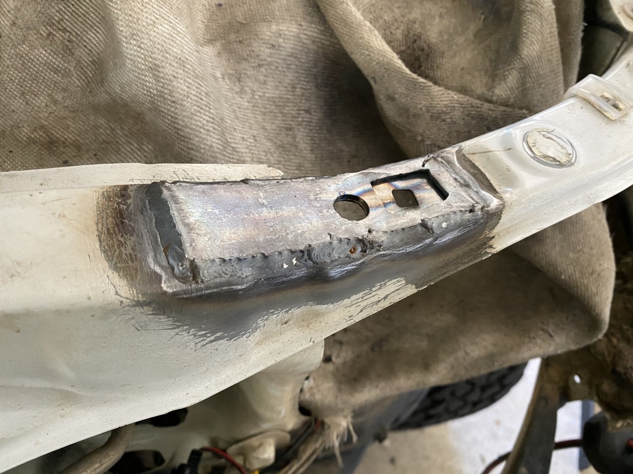

    My hood pins were causing cracking in my core support so I formed and welded some 14 gauge reinforcements. I hate working with the thin stuff.

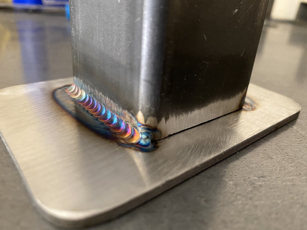

    I’ve been out of the tig game for quite some time. A day of sub par welding and managed to start scratching some decent ones out the following day

    Is that stainless or mild with stainless filler?

    Mild with stainless filler. Just playing around with some scrap material I had and some different cup/gas lenses
    Will not be used for anything structural etc
