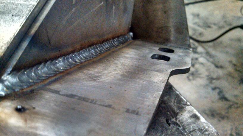

    Comibg along nicely. Definately watch out for under fill. I don't remember what metal it was, but we did a job a couple of years ago that would crack from the slightest bit of under fill. Had to constantly shove wire into the puddle. I've also welded chromoly gun parts that would do that

    I think he means welding thick to thin.
    I like to set the machine up for the thicker of the two and focus the heat on the thick side.

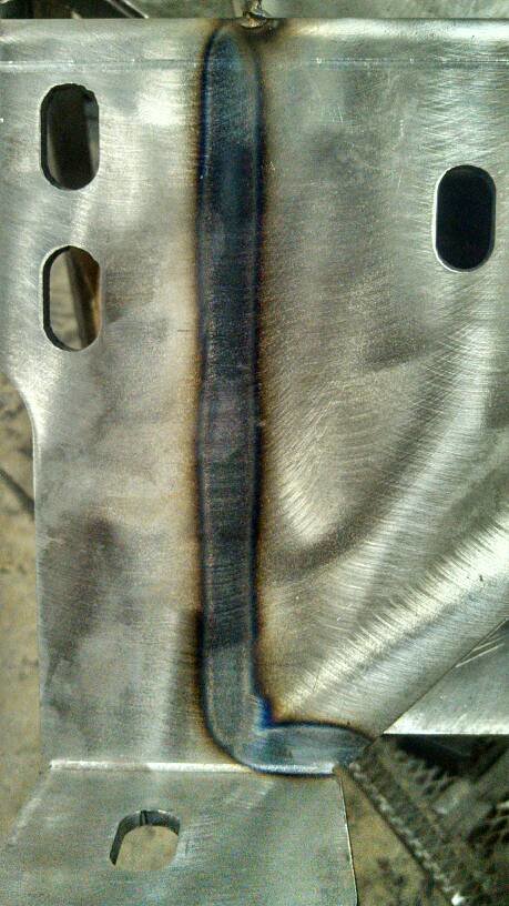

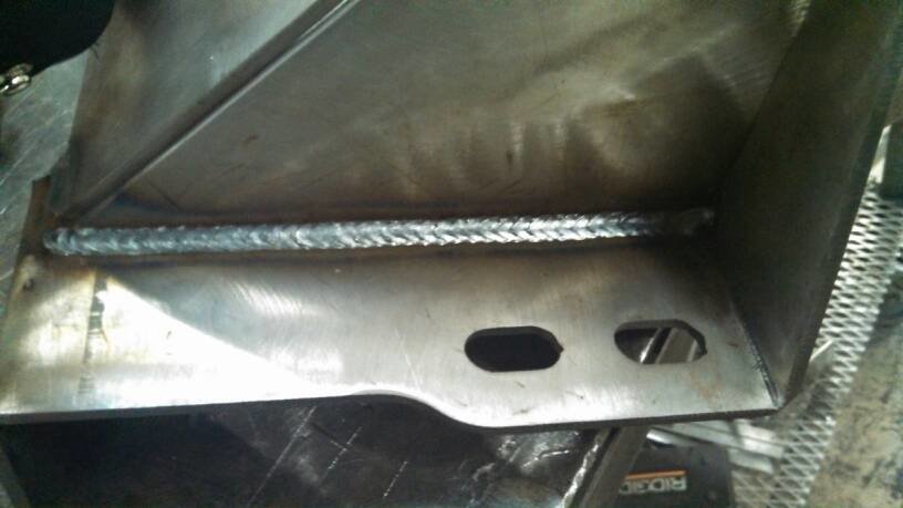

    From the welds above, looks like you're picking it up nicely Anthony! Only thing I'd say was a few welds on the angle iron were a bit high, I would have went on the base metal a little more. The heat signatures on the back tell it also, those are probably the ones where the blued area is smaller on the skid.

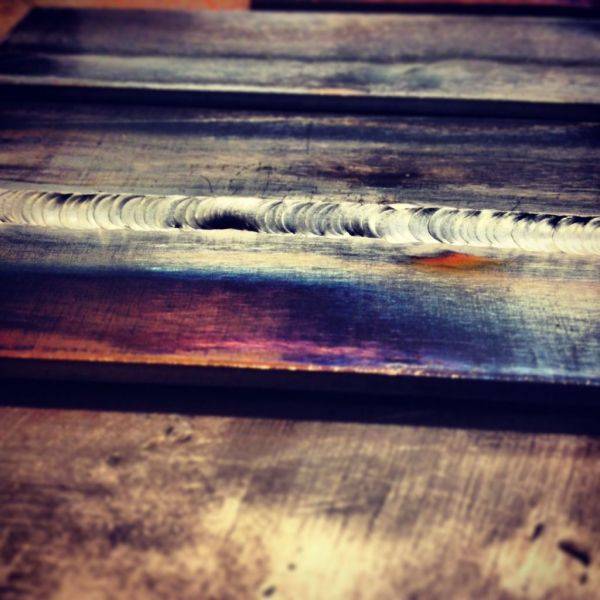

    Just because.. Just ran this with my 211i.
    Back side

    That looks awsome!! Beutifull mig weld
