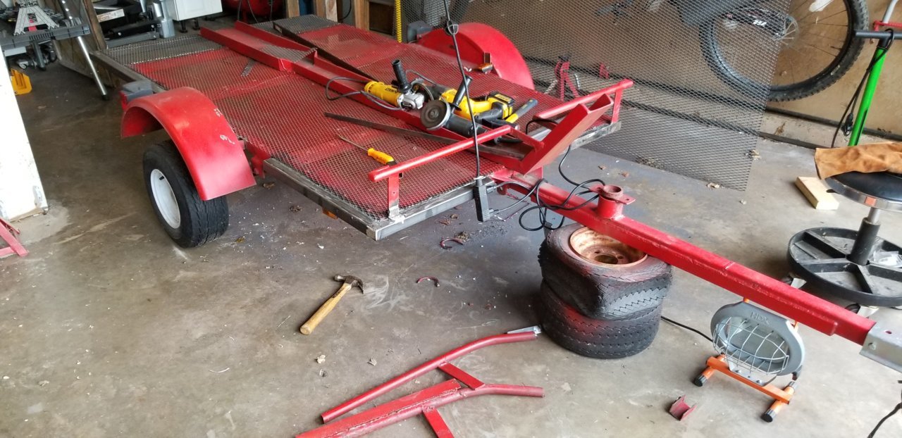

    I'm sure you've all been wondering how my trailer project is coming along, so thought I'd give an update since I haven't posted in a bit. I extended the back of the trailer by a foot and added mesh, and now I'm working on adding the railing. Added another row of tube on one side this weekend, will add the other side this week and then start installing the railing using angle that is connected to the tube steel I'm adding. I need to take this up to NH with me next week so I have a deadline to motivate me to finish.
    Things I've learned so far on this project:
    1. Welding is fun.
    2. Welding in cool weather is more fun than welding in warm weather.
    3. Having two angle grinders is somewhere between a luxury and a necessity. If you tell me it's a necessity, I won't argue.
    4. Pushing the bead seems to work better for me as I can see better where I am going.
    5. Overhead welding is hard, haven't figured that one out yet (puddle keeps dripping into the nozzle).
    6. A plasma cutter would be really cool to have. If I get one, will use it to move the axle toward the rear (hence why I didn't connect the new tubing to the wheel wells).
    7. Welding to clean metal beats welding to a painted surface.
    Having a blast and learning a lot on this project.

    Once I got my second angle grinder, I wondered how I ever lived without one. Plasma cutters are a freaking blast, just expensive. You shouldn't weld to a painted surface you should clean it first, at least the best you can. It'll never go well otherwise.
    Thanks for the update, it's cool seeing you progress.

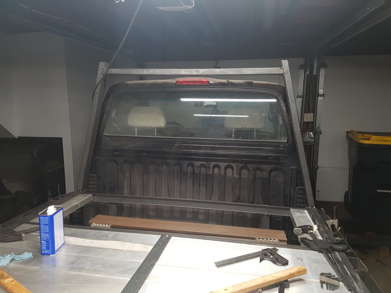

    I'm pretty sure this project is the thing keeping me sane right now. No bullshit, just lots of geometry. Figured out the rest of the toolbox plan today, and tacked up a headache rack that I'm still thinking about.

    I just want to know where you got that square tire :laughing: Its looking good!

    I've gotten anal about grinding off the paint. Weird things happen when you weld to it. o_O
    Those came with the trailer at no extra cost!

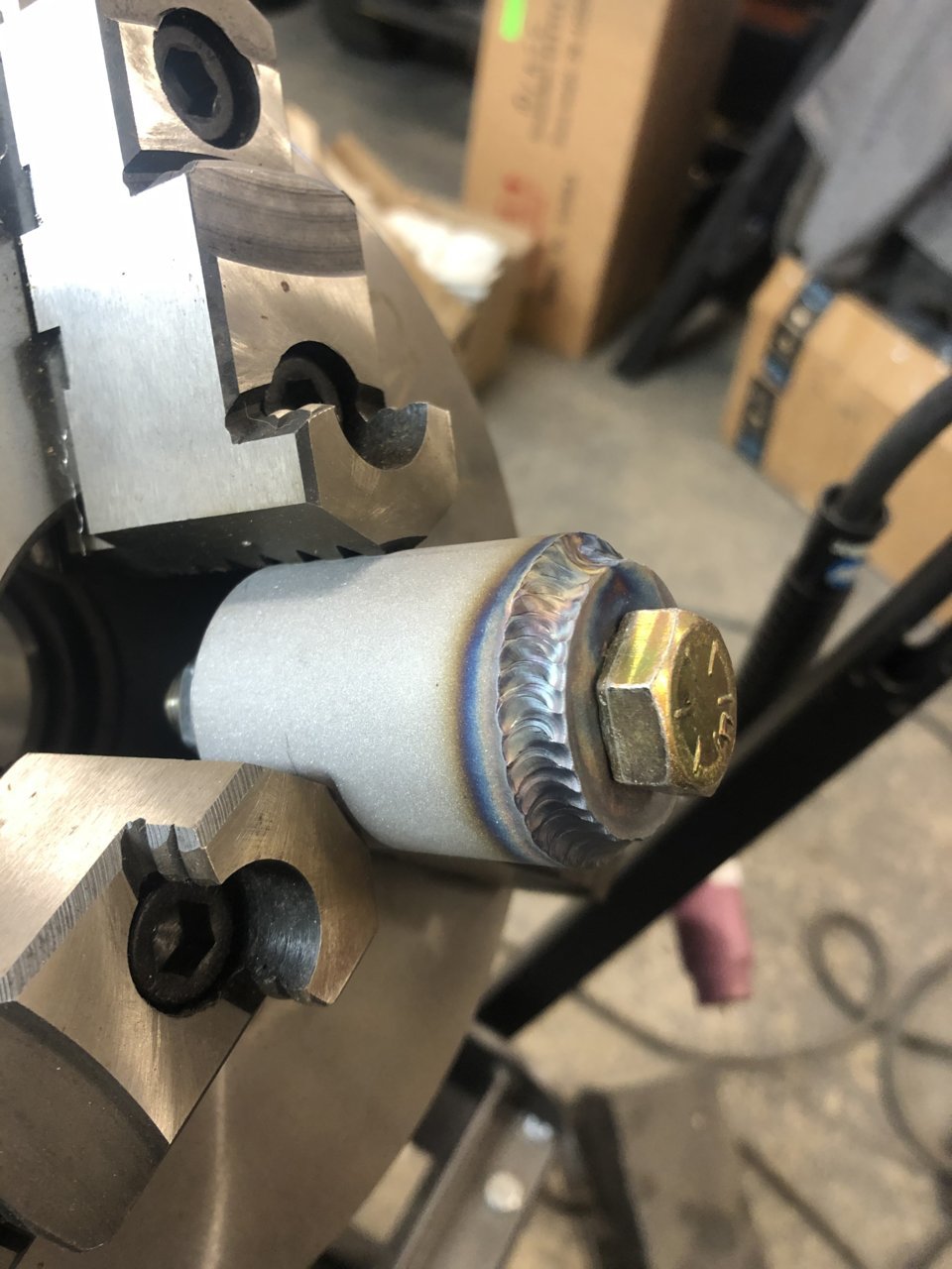

    Used a weld positioner to weld some machined washers to some machined pieces of tubing for new steering rack mounts.

    The positions are pretty cool. I used to use one all the time at my old job

    Yeah i've got a cheap one that i need to do some electrical work to make it work better, but my buddy is letting me borrow his really nice one since he doesn't have any space in his garage anymore. So this was my first real attempt at using one that doesn't change speed every second. I had 4 of these welds to do and the third and fourth came out like this but the first and second weren't quite as nice.
