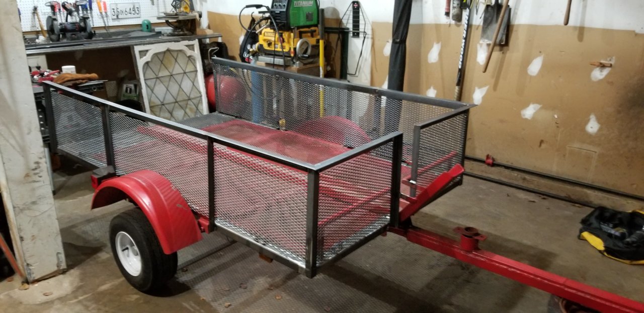

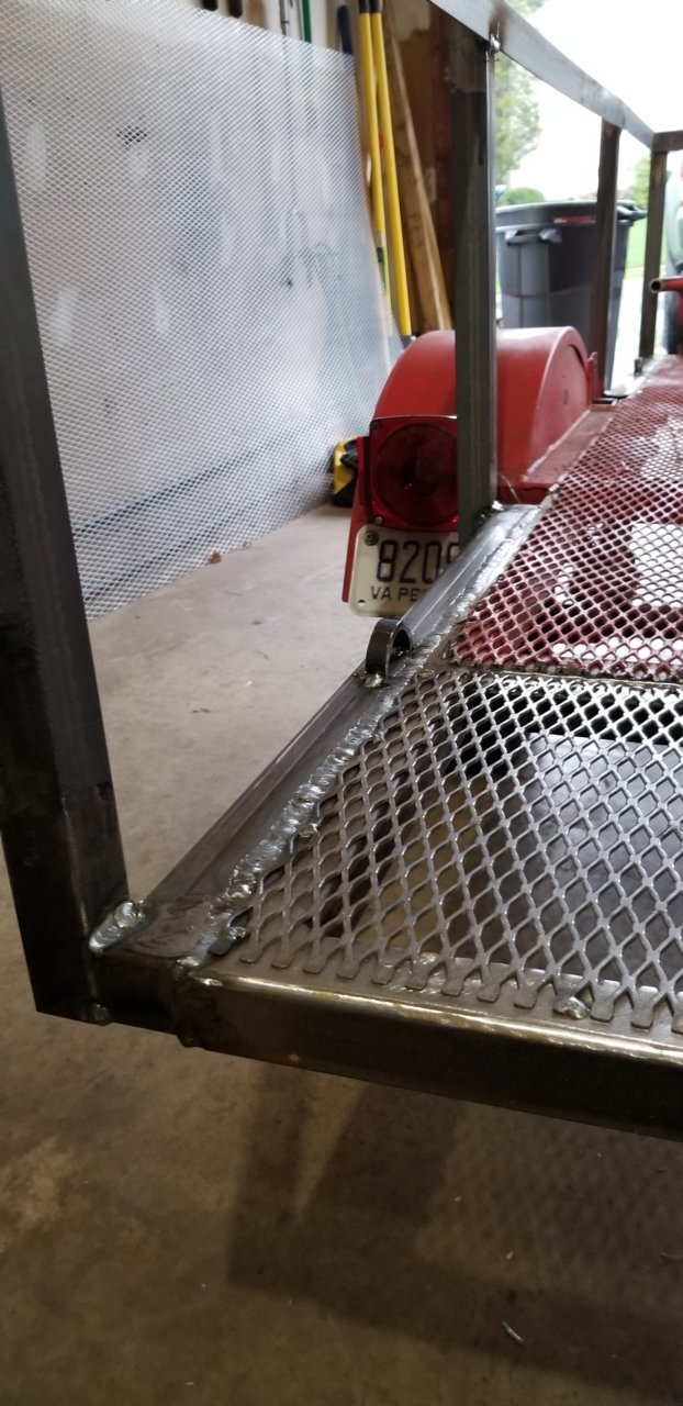

    Just about finished Phase 1 of the trailer project, here it is pre-painted. @koditten I have your 2" pipe tie downs on there as well, thanks for the suggestion

    Looks great!
