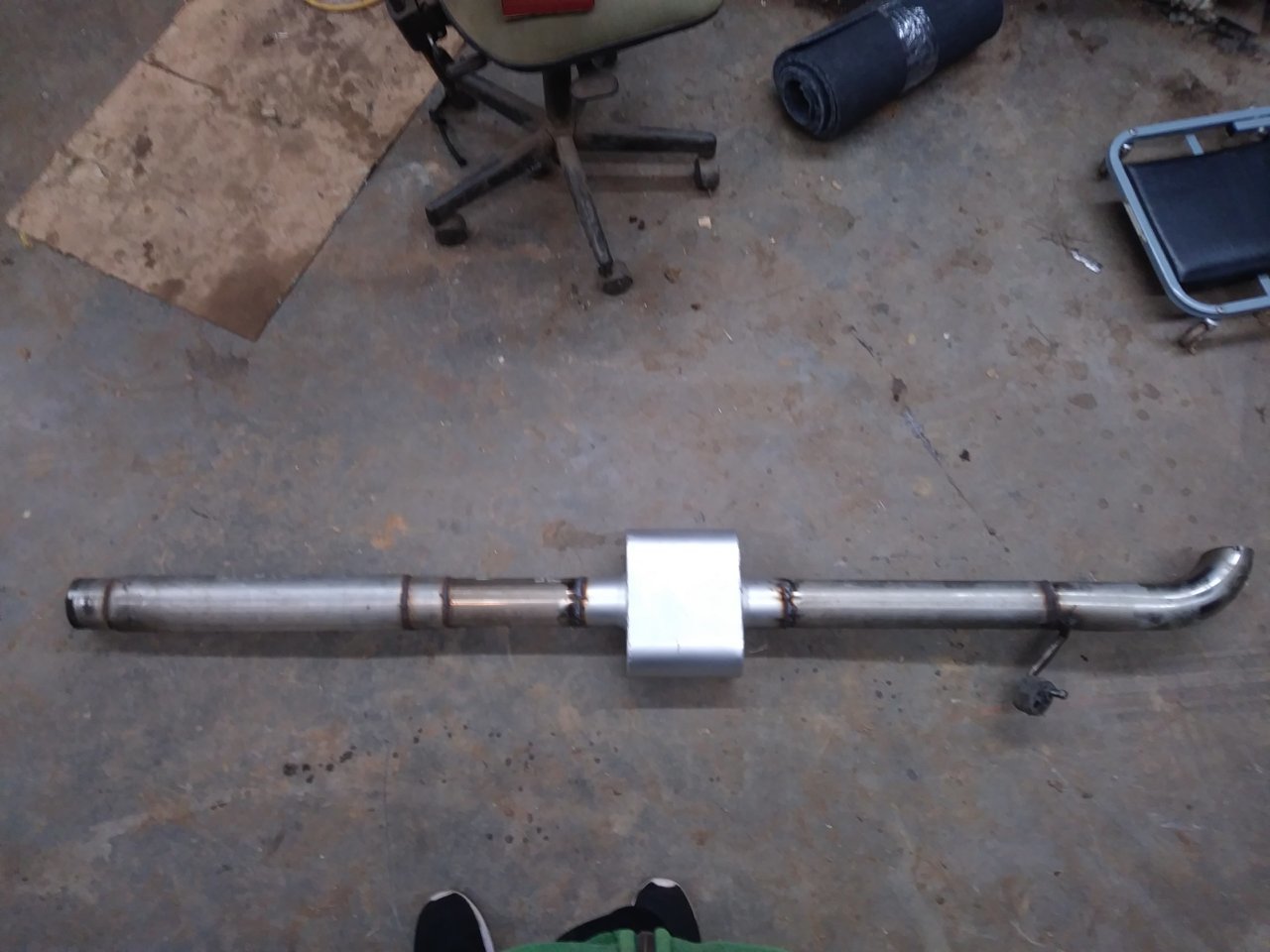

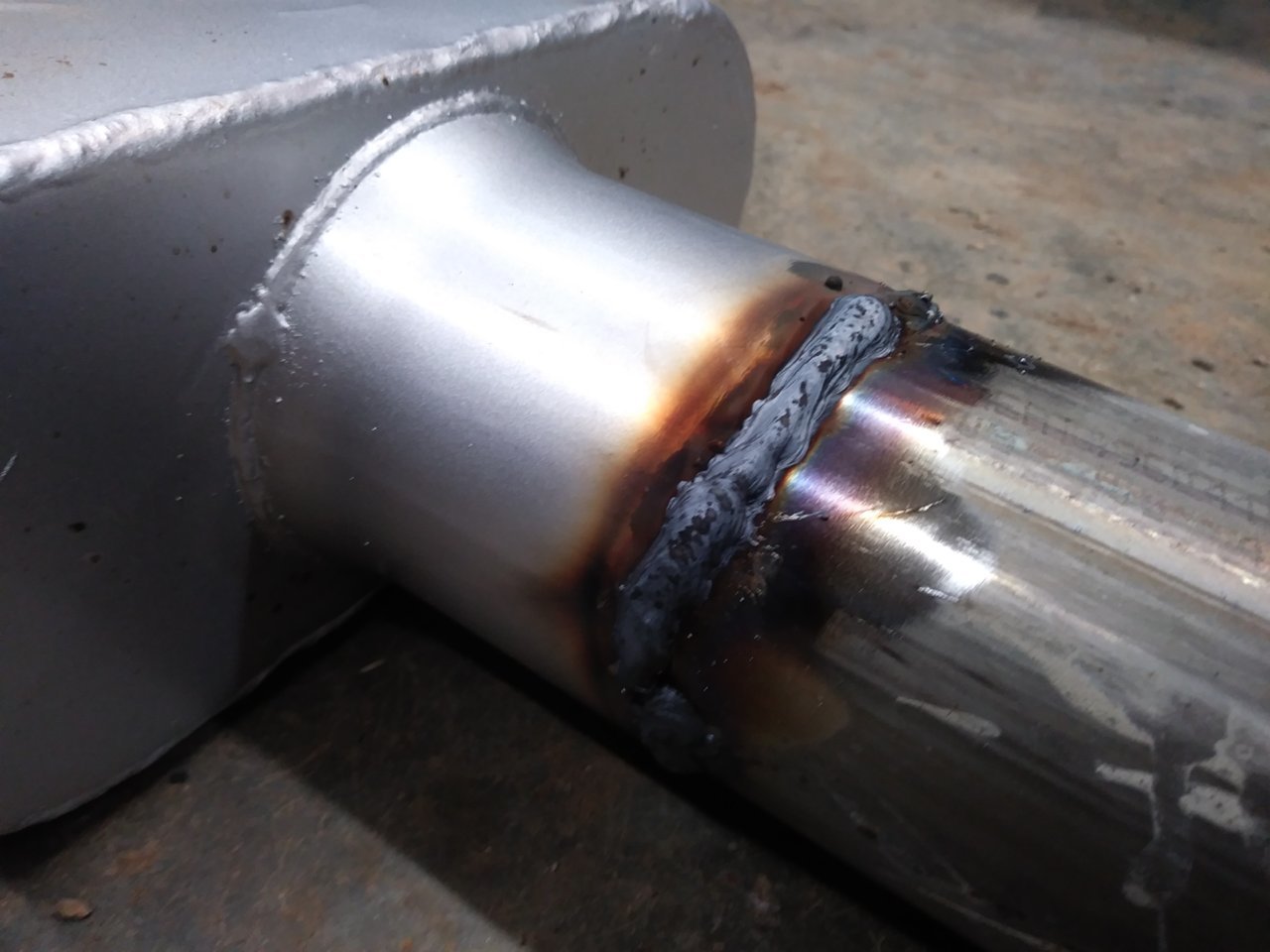

    Had a time dialing in my biddy's miller and most of that is just due to me only kind of knowing what I'm doing but added some db decreasers to the ol' exhaust. Best looking welds still look like trash they are better in the exhaust hanger just because its thicker I guess. Doesnt really matter because no one is gonna see it anyway ig.

    Doesnt look bad to me. Exhaust welding is just sheet metal welding. Thin iron is a bitch! You can very seldom "carry" a bead welding thin iron. Those look great.

    I had to cut the 90° off on the end and reweld the hanger on and so when I butt welded the 90 back on I literally just tacked a circle and waited till it just stopped glowing red and tacked another all the way around. I watched a video on "xtreme 4x4" or something like that where they used that trick on something to keep from burning through everything. It actually looks as good or better than the bead on that slip joint just because I stayed on center target a little better lol
