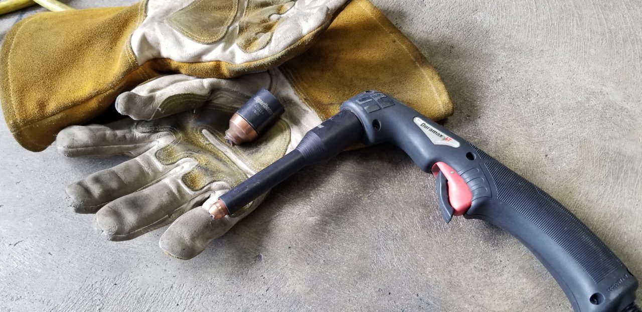

    Thank you. I used my plasma cutter and a straight edge to cut the squares out, which took me more time than I care to admit. :rofl:

    I still haven’t mastered my plasma cutter, my cuts are ugly and jagged with a big mess. I definitely need to practice, your cuts are beautiful!

    Yeah man, without a straight edge, mine will look like a shark took a bite out.

    I’ll have to try the straight edge. Do you let your tip slide across the surface when you cut or do you use an adapter to maintain a distance?

    Are you using a drag tip?

    Yes, I believe all the Hypertherm torches use their standard drag shield/tip. It's a solid copper thread on shield.

    Haha my bad, you weren't even commenting to me. Anyway, I also use this extended reach nozzle, which also has a solid drag tip.

    Try using the short tip that unwieldy thing is probably making it harder than it needs to be

    I don't have a hard time with any of those. I use the extended reach to cut in hard to reach areas that the standard tip can't get a good angle. The long nozzle is not made to use to cut regular sheet metal on a table.

    The extended tip is so awesome. It’s great for stuff like cutting shock and cab mounts off.

    I didn’t even know something like that existed! Too bad I have a harbor freight cutter and I can guarantee something like that doesn’t exist for it.

    Hypertherm makes long reach Torches for Plasma Gouging and for demolition work .
    36" and 48" and some others.

    A drag tip on plasma cutter actually rest on the metal. There is no "hovering". Drag tips plasma torches can make some amazing clean straight cut. Almost as clean as a shear.

    Are they a universal thing or does the cutter have to be capable of a drag tip?

    In most cases the cup, tip are different so the brass drag cone can encapsulate the tip. I know the millers and hypertherm have kits to make there torches drag tip torches.
