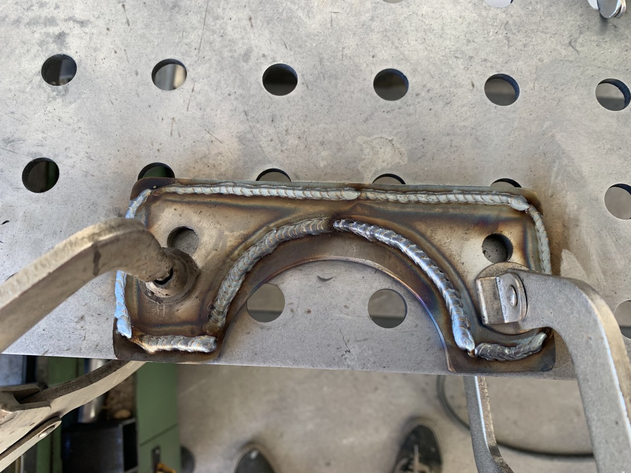

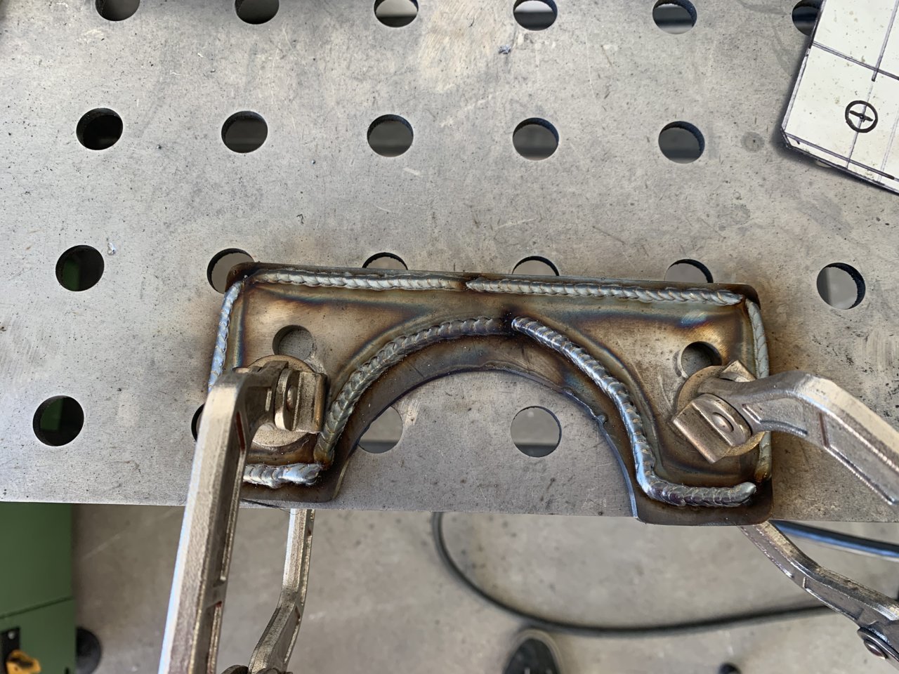

    Atleast I still know how to mig weld. Feeling pretty good today. E6A973F9-C4F2-43CF-80B6-4001F1B39ADC.jpgCE8ED43D-8A0D-4ECC-BEF0-C21EFE2D1A04.jpg

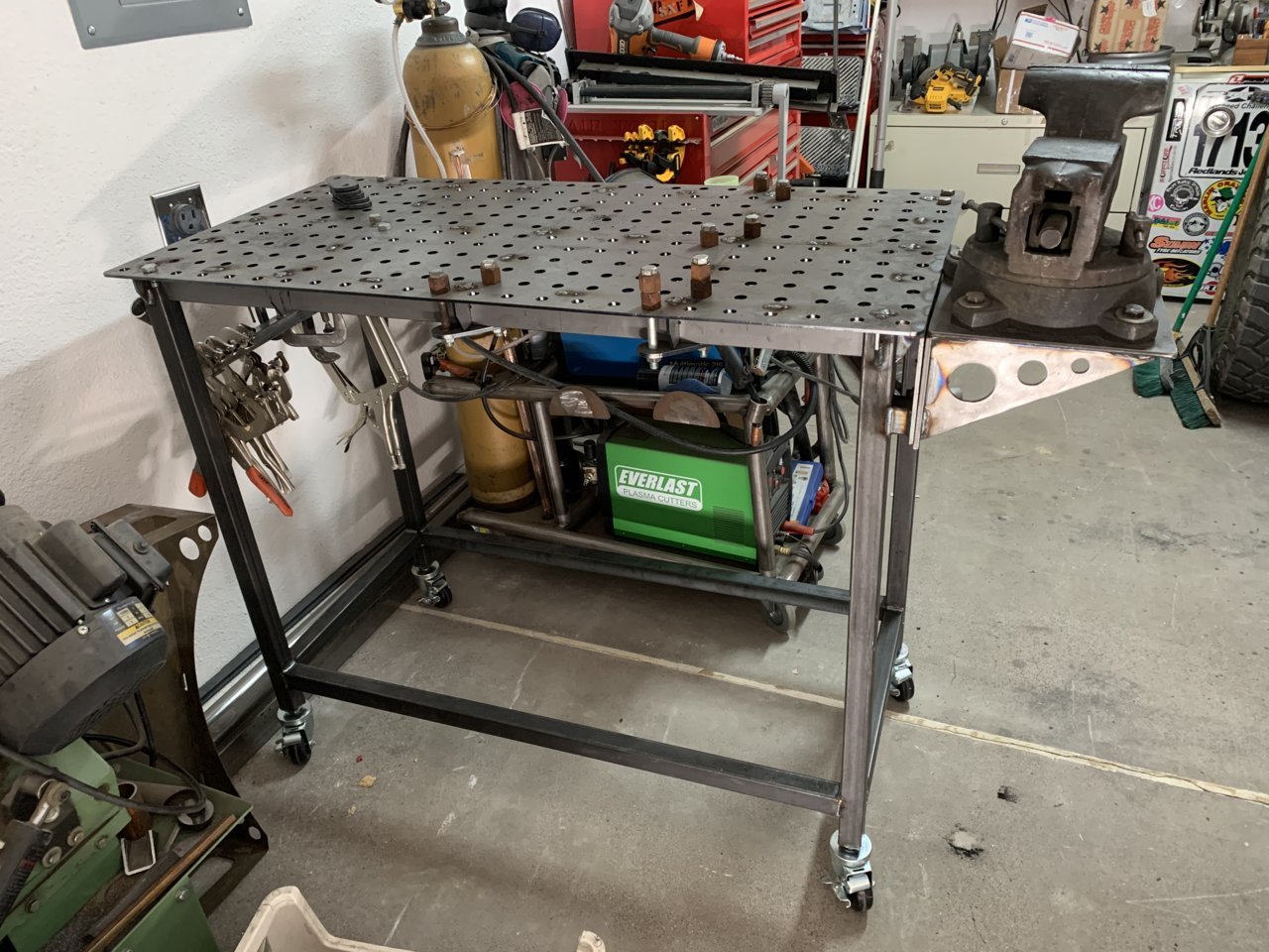

    I have just the top. My dad has the fab block. Both really nice. No complaints. 1C0B6001-529C-4E74-B6C5-CE0E539D1023.jpg

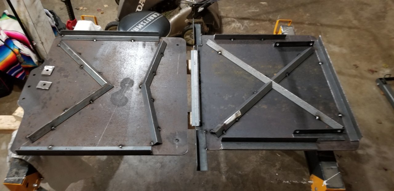

    So I started on my first Tacoma welding project, making mid and rear skid plates. Bought a 2x4 piece of 3/16" steel and have them cut out with the gussets tack welded. My URD y pipe runs low under the trannny so I couldn't run the gussets through like the rear skid, but should hopefully still work. Just need to fab supports for the back of the rear skid so they can connect to the "C" clamps on my Mobtown sliders.

    Don't make the mistake I made and weld the angle laying down like that. The strength comes from the vertical plane of the rib, and laying angle down like that will give you more to weld to but overall strength is reduced and it WILL bend.
