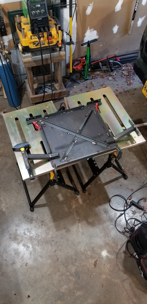

    I have some of his squares as well. I plan on getting his 12x24 extension and putting it on a hinge to extend my table. A 2x4 table is just barely to small figuring most projects will use a common number of 4 feet so having a few extra inches on each side would be nice. I really wants a 30x52 or so table

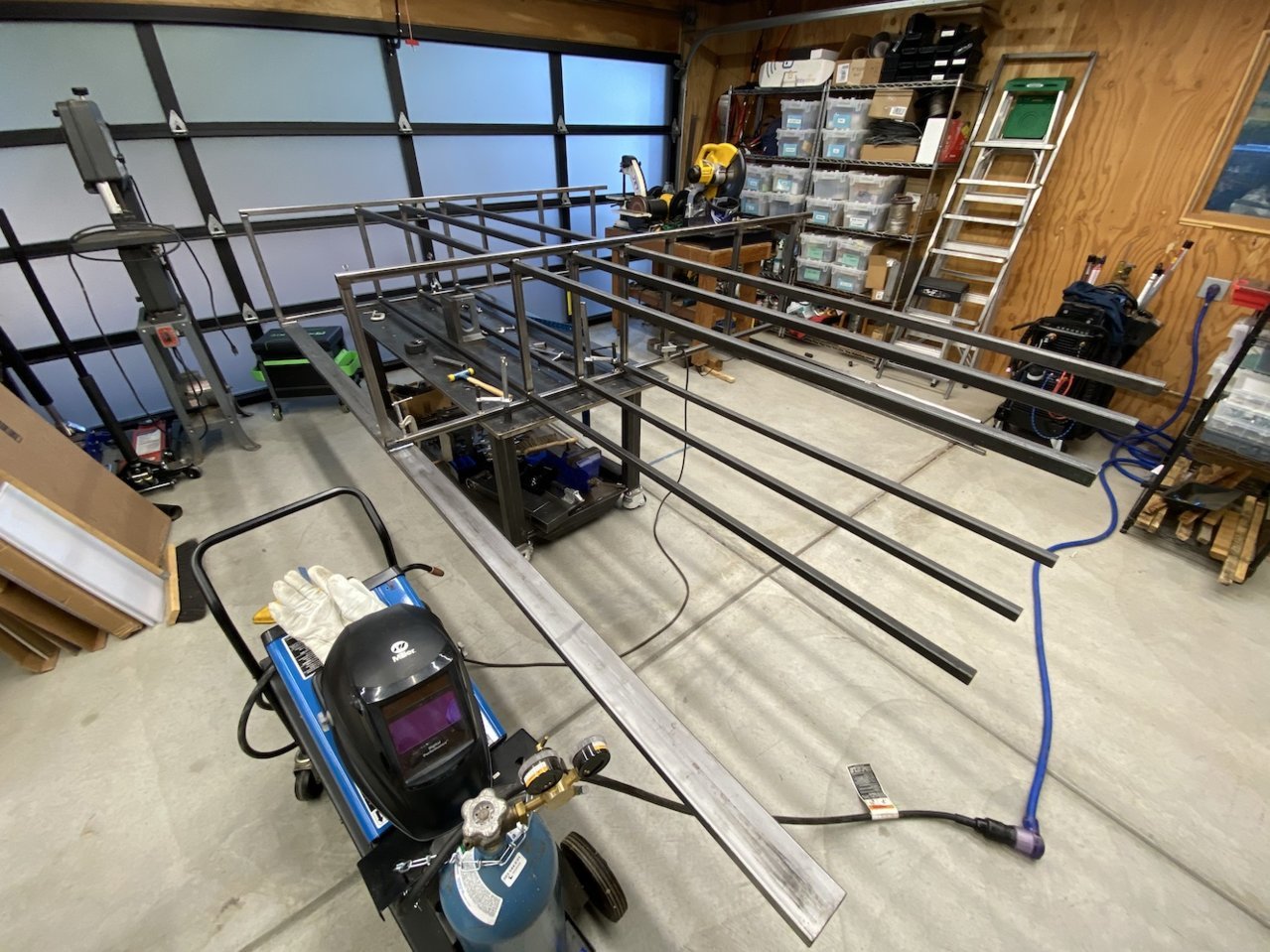

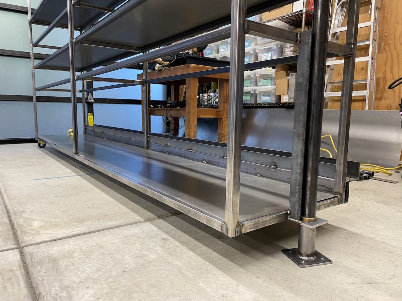

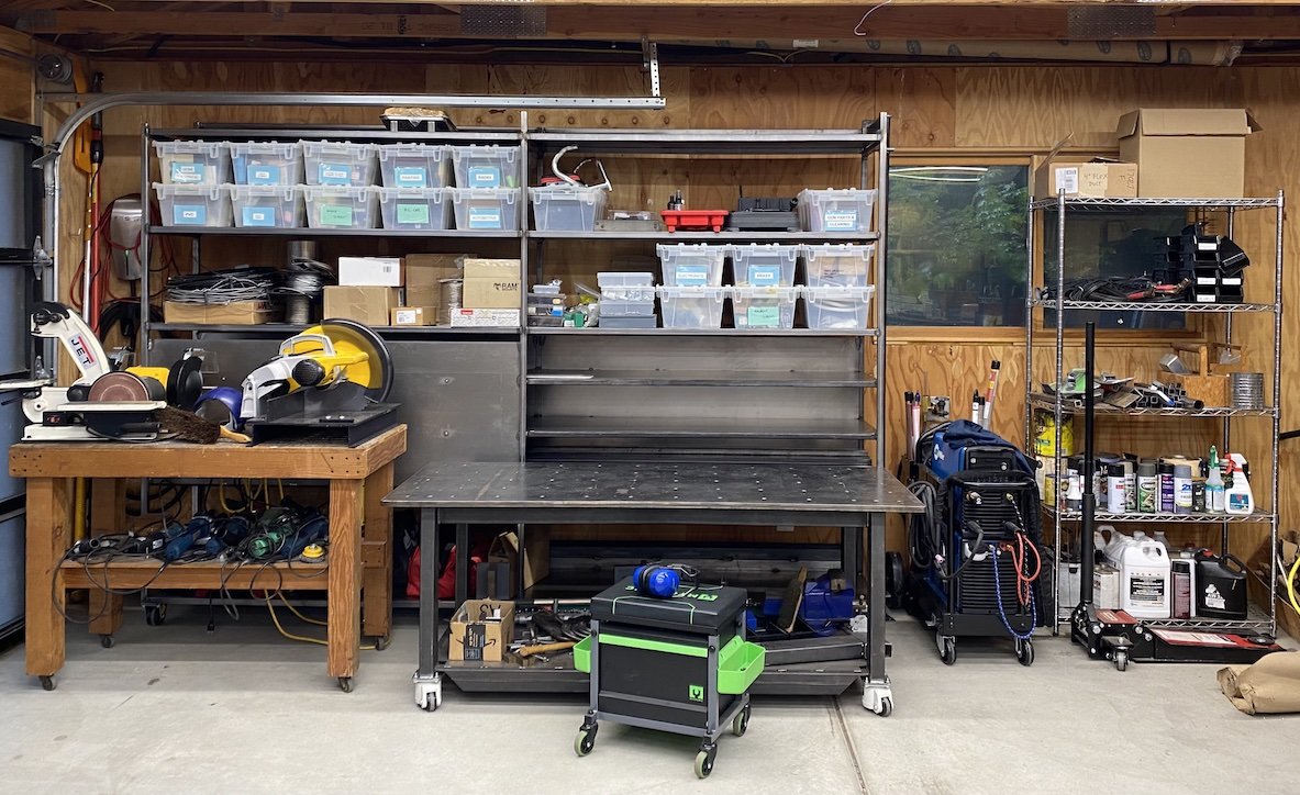

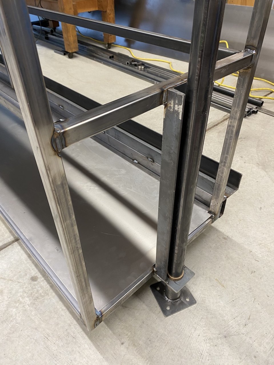

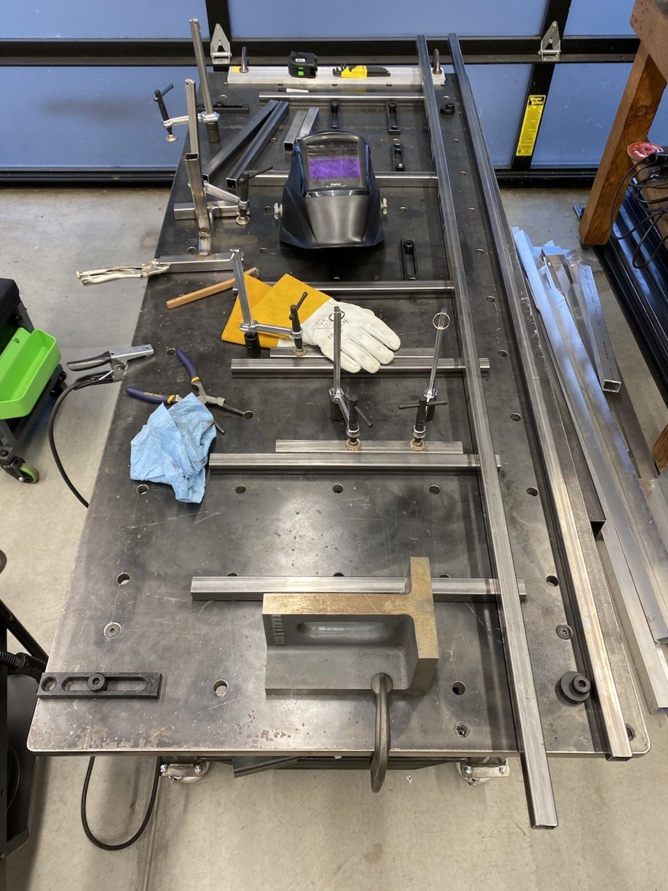

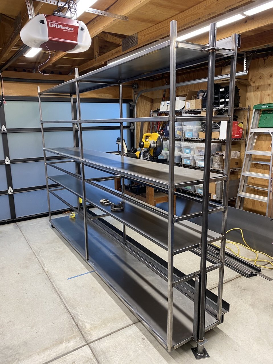

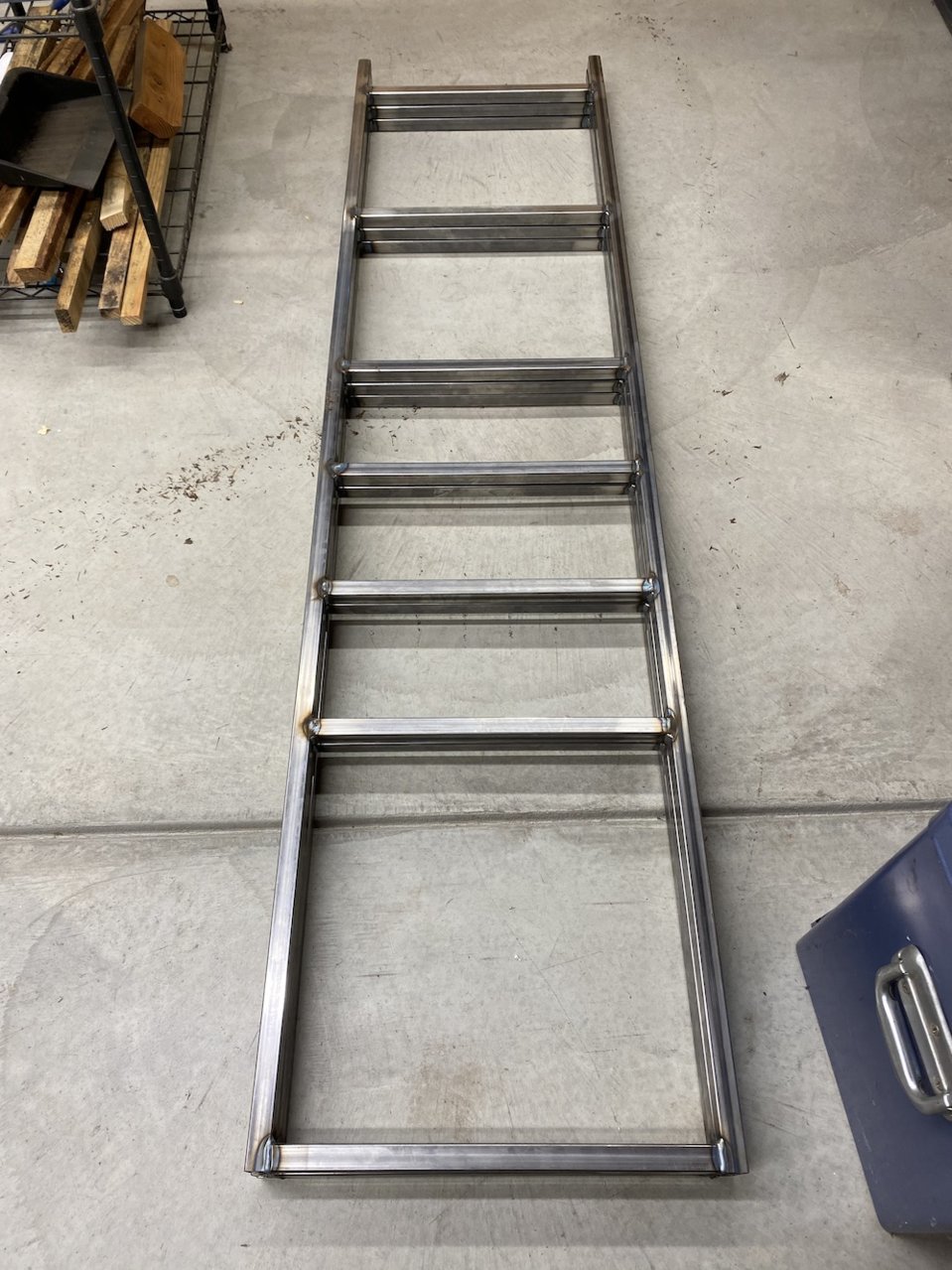

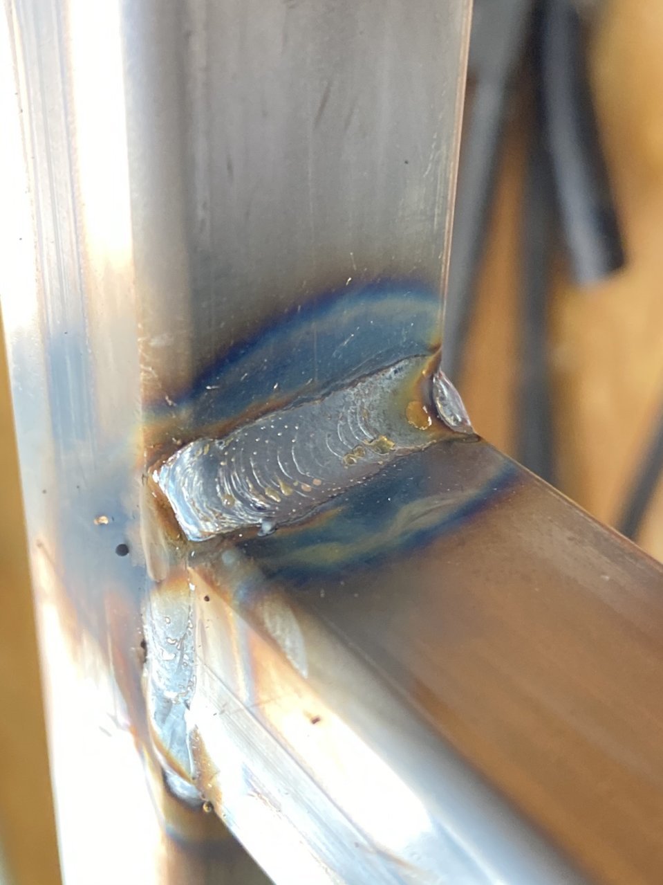

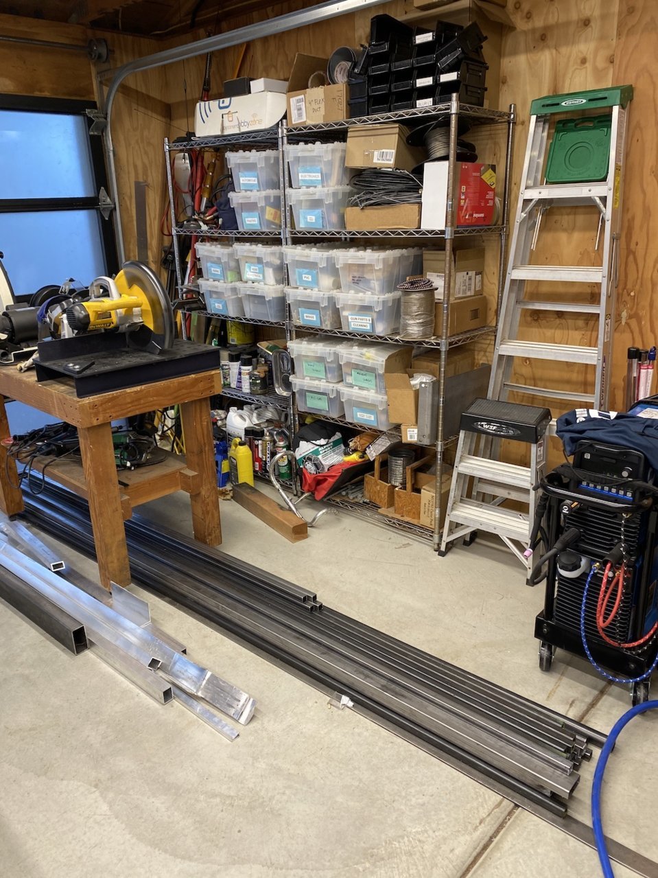

    Inspired by someone here (making a rack for a truck that does set rigging, I think?) I finally finished making this behemoth. Took about infinity longer than I thought it would, but now I have a place to stuff all the stock I've been tripping over on the floor for the last 10 years. The right side is a pivot - the left has casters so I can pivot it out just far enough to clear the framing next to the garage door to slide long stock in from outside. I thought I finally started to figure out mig-ing this thin box, but kept burning through. So annoying... So, I'm only showing the pretty weld(s). Ha ha. So stoked this is done! It will survive the next ice-age.
    Before:
    I was able to weld about 1/6th of it at a time on my table until it just got too heavy an I had to do the rest on the floor, or eventually standing up.
    here's the pivot...
    After:

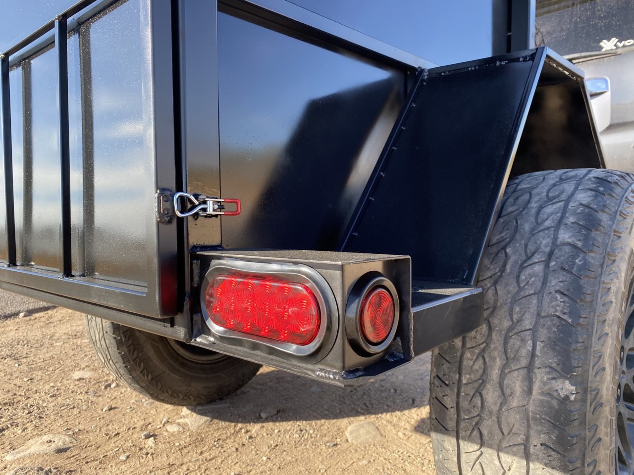

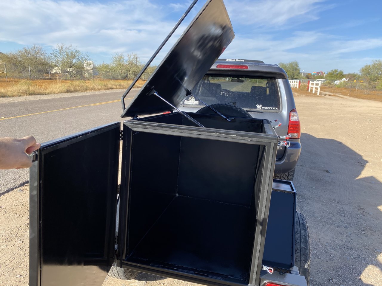

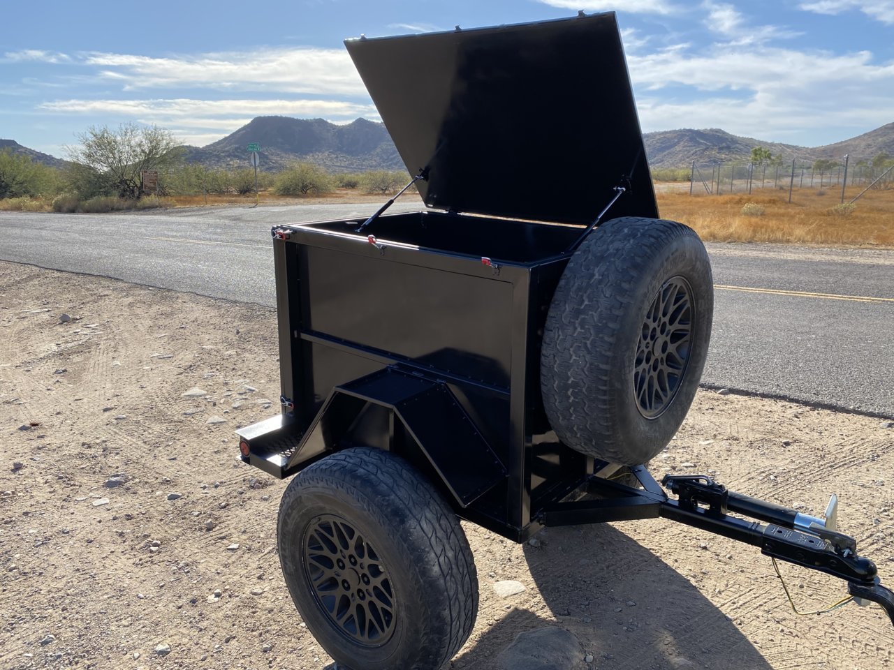

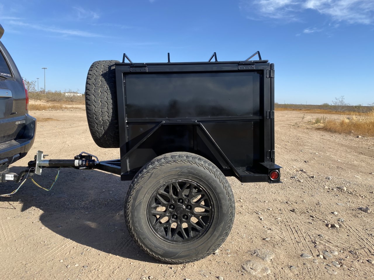

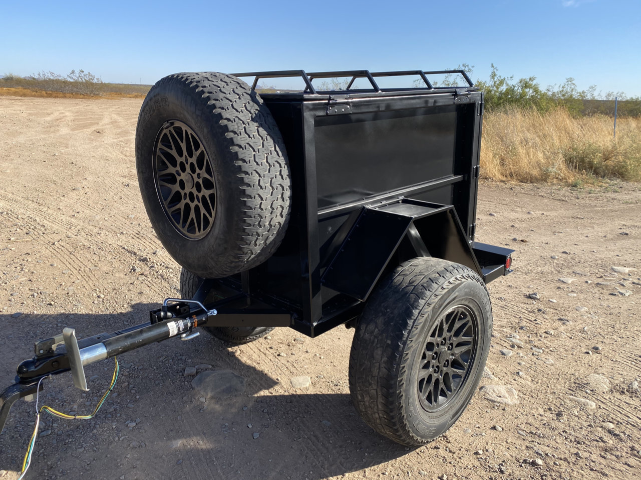

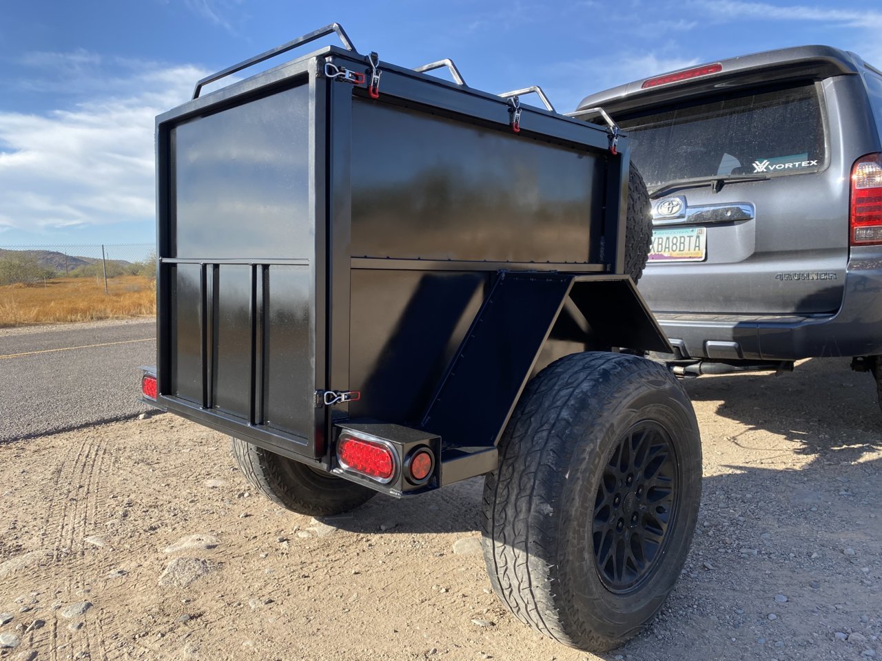

    Check Build thread

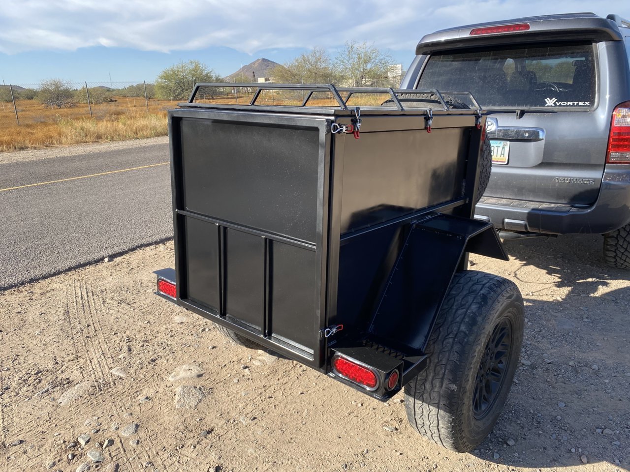

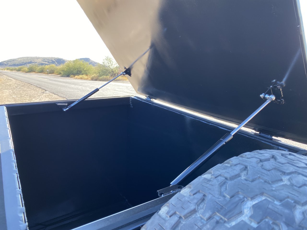

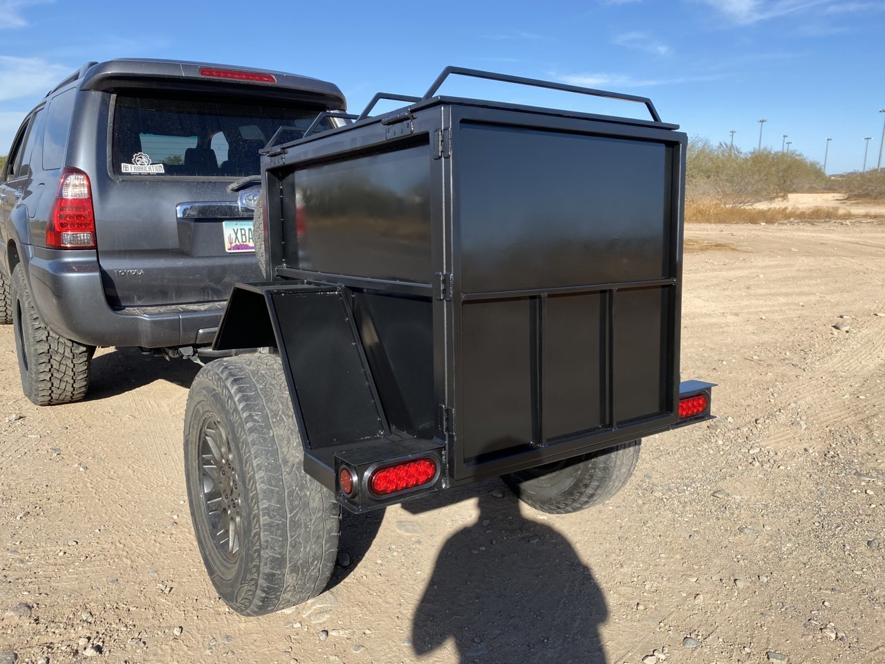

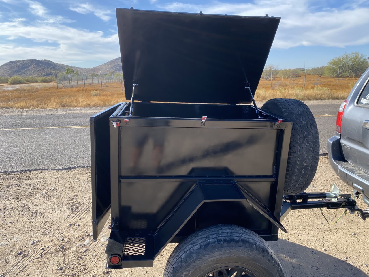

    Finished I think. Not a super complex project... but a fun little welding project.

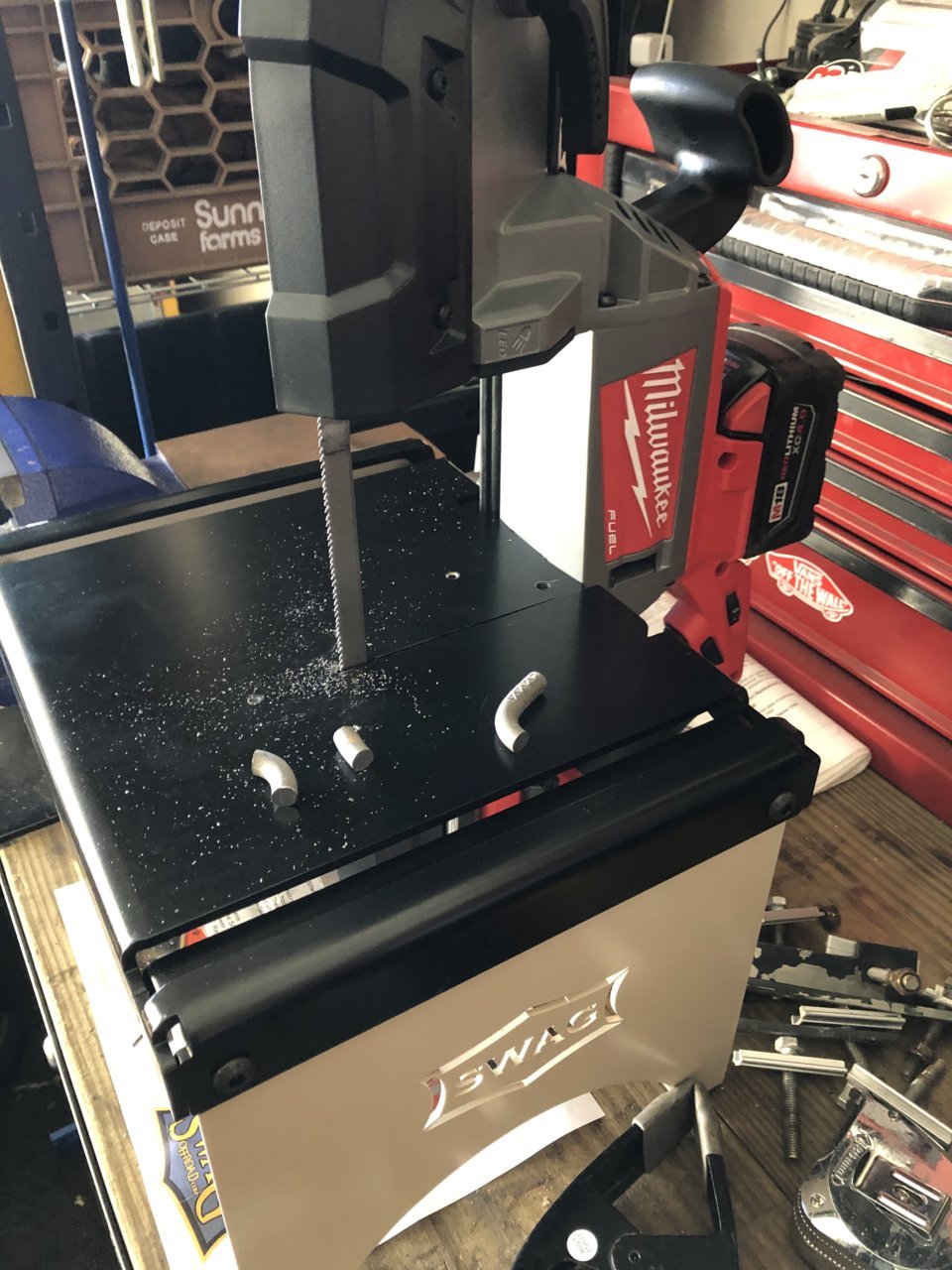

    A little bit ago there was a tool debate between the steel chop saws, plasma cutter, and other options such as portaband with a swag offroad table. I was unable to completely read it all and follow it but already having an evo chop saw my attention was re-perked on the portaband enough to find a good deal and pull the trigger. Put swag table together and made a couple cuts. First thought was love making a cut with two hands still on material. I also feel this setup will be ideal for smaller things like making end caps on tubing. I have a solid 3/8 table top as my weld table, and seeing the swag table online with bent steel feet I knew I wanted to put some rubber anti skid feet on the bent portion predrilled. Finally in hand I was trying to think up a solution I could run out and get, turns out I thought to use some rubber wire grommets I had laying around. A little fight to fit them but actually worked out perfectly. Not sure if anti skid feet were ever discussed but thought my personal solution could help out anyone else looking to do the same..

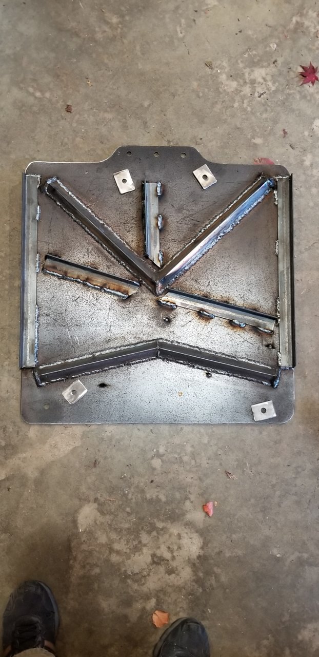

    Thanks for the tip. By the time I read your reply I had already welded them onto the tranny plate, but I knocked off the tack welds on the transfer case skid and repositioned them per your suggestion. I ended up adding some more angle to the tranny skid positioned in the L shape, and will put a couple short pieces of 3/16" bar stock positioned vertically to connect them across the middle, so it should be pretty stout. I've only got about a credit card's width of clearance between the plate and bottom of the exhaust pipe at the back right side of the plate, so I'm hoping the additional bracing will help keep the plate from bending (much). I'll upload pics once I finish welding everything up, would have been done last night but ran out of wire! If everything goes according to plan, I'll have them painted tomorrow and installed Friday in time to do some wheeling Saturday.
    Here's the tranny skid with the additional angle iron, sans 3/16" bar stock
    Here's the t-case skid with the repositioned gussets as well as the supports added to connect to the Mobtown rock sliders. (In case you're wondering, I bought a welding cart to get the welder off my planer!)
