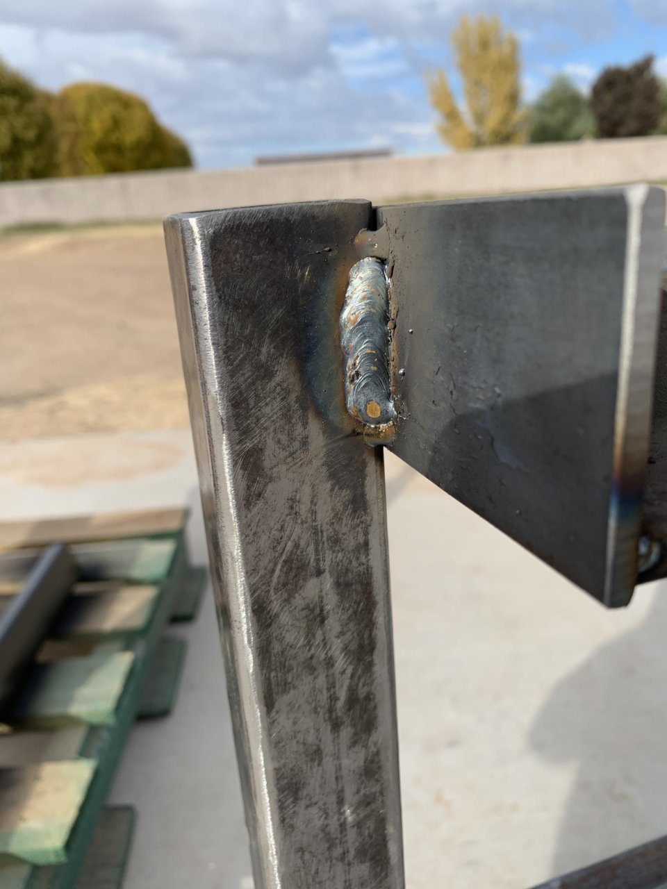

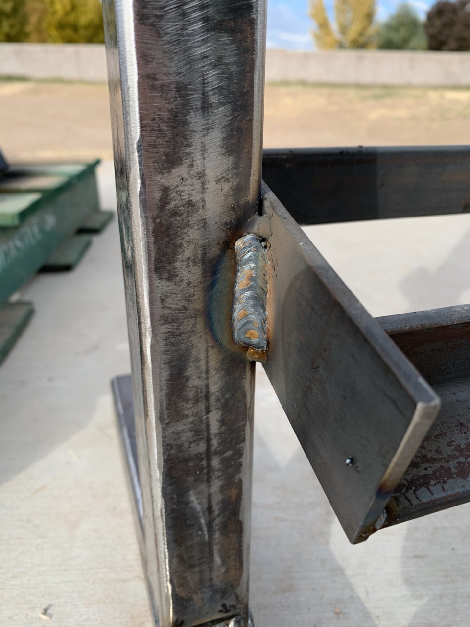

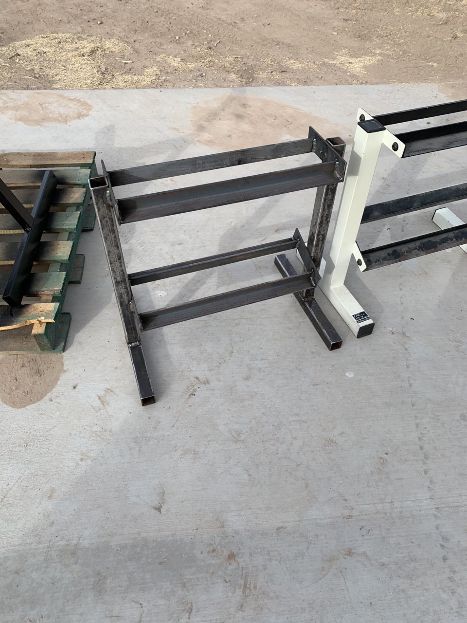

    Welded for the first time a few days ago, made myself a weight rack for my dumbbells! Don’t be too hard on meC4ED2E11-D18A-4B87-9157-2713FF9124A9.jpg36F1B23D-AA29-41C9-B72B-3914C80CD5F0.jpgEABD67CE-055A-4603-BC24-B2FAC0E9ED42.jpg

    Those welds will hold fine. I like a little more "heat" for better penetration, but you are well on your way.very nice!
