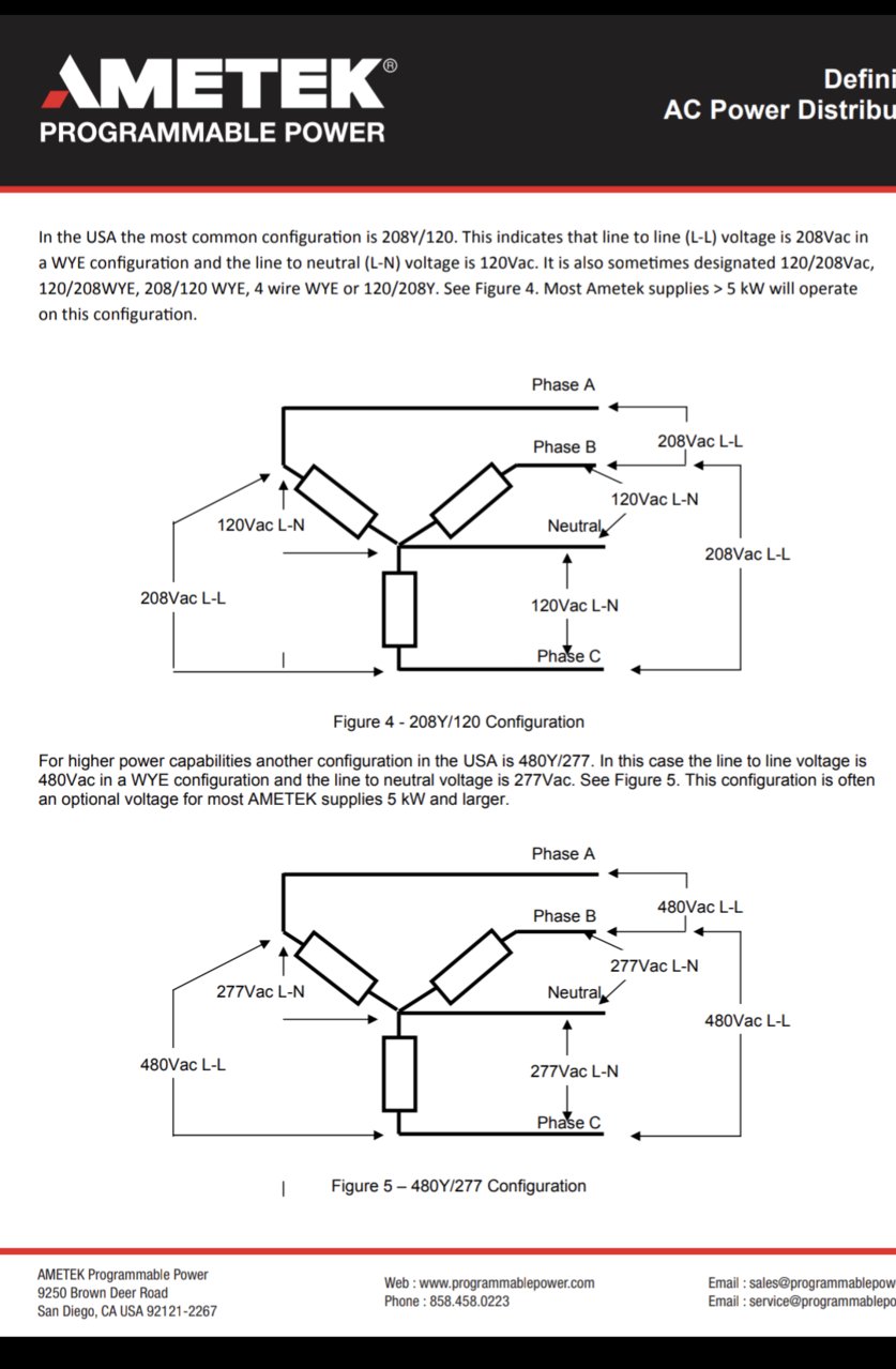

    Probably referring to 208v found in some apartment buildings with split phase power distribution?

    maybe... and that would be a one legit reason for seeing the voltage under the 220v originally mentioned

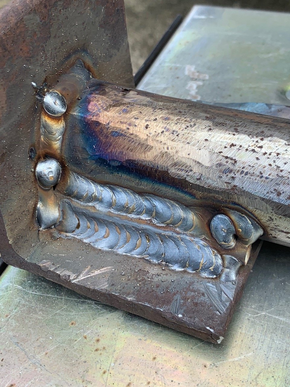

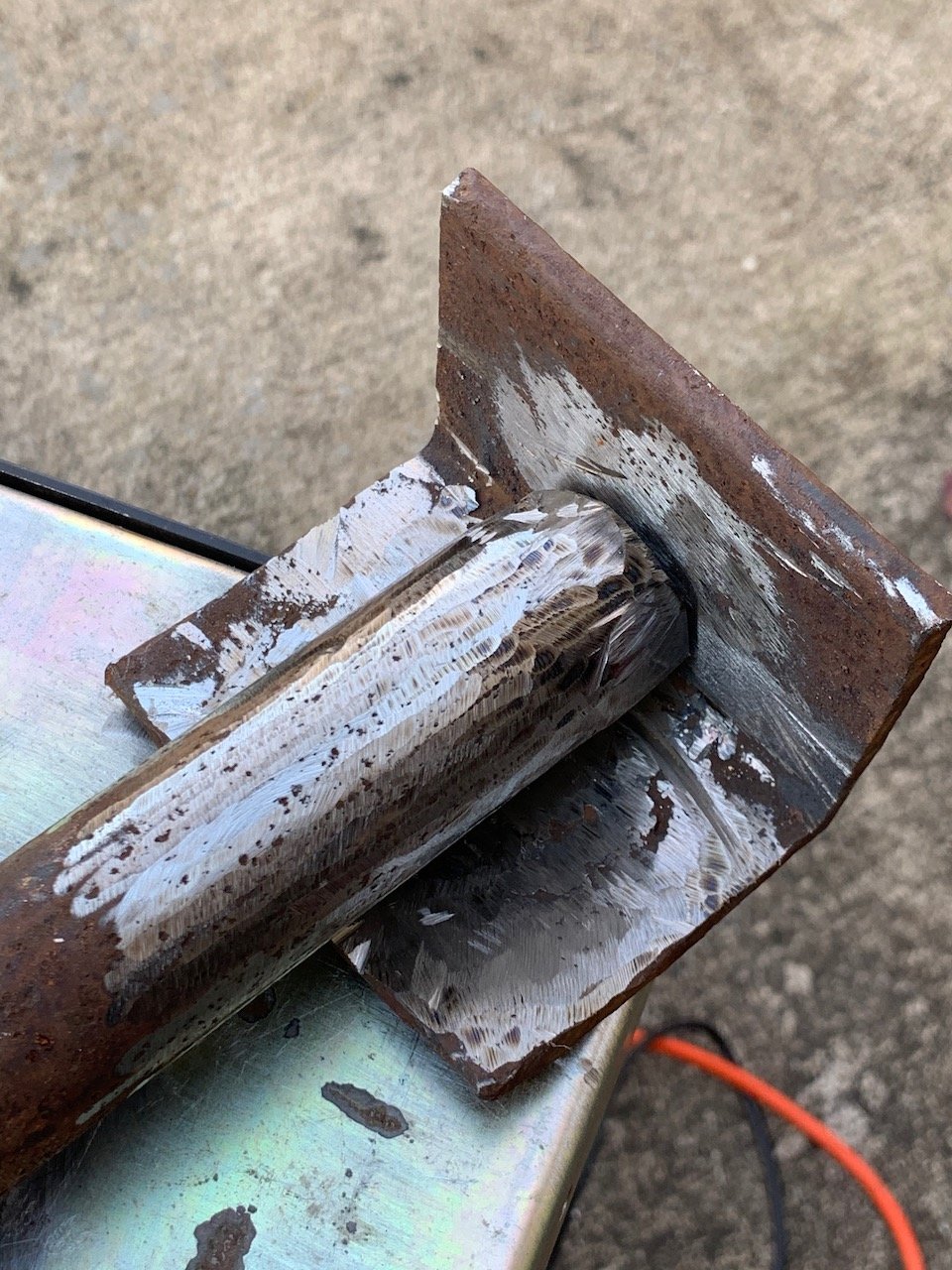

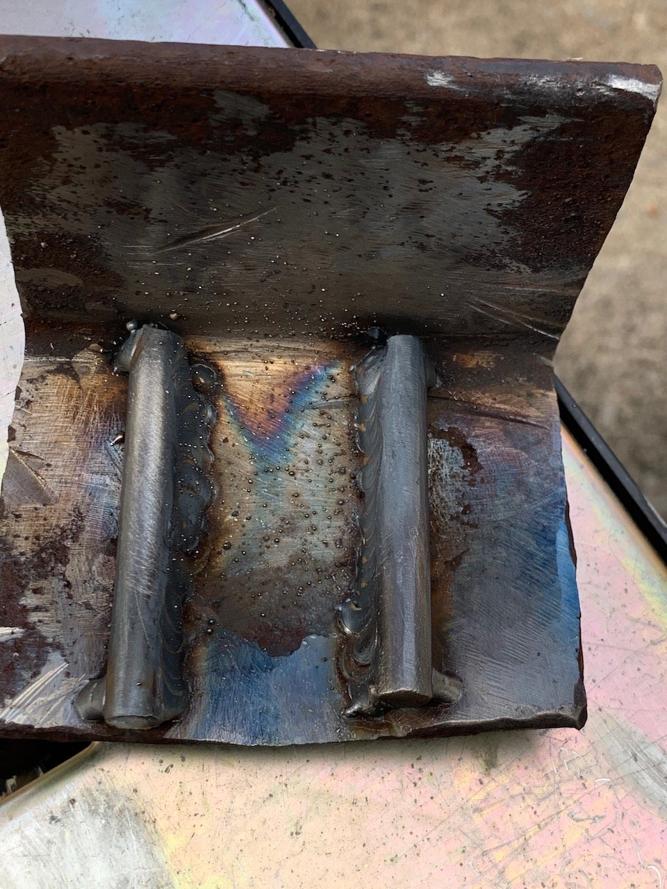

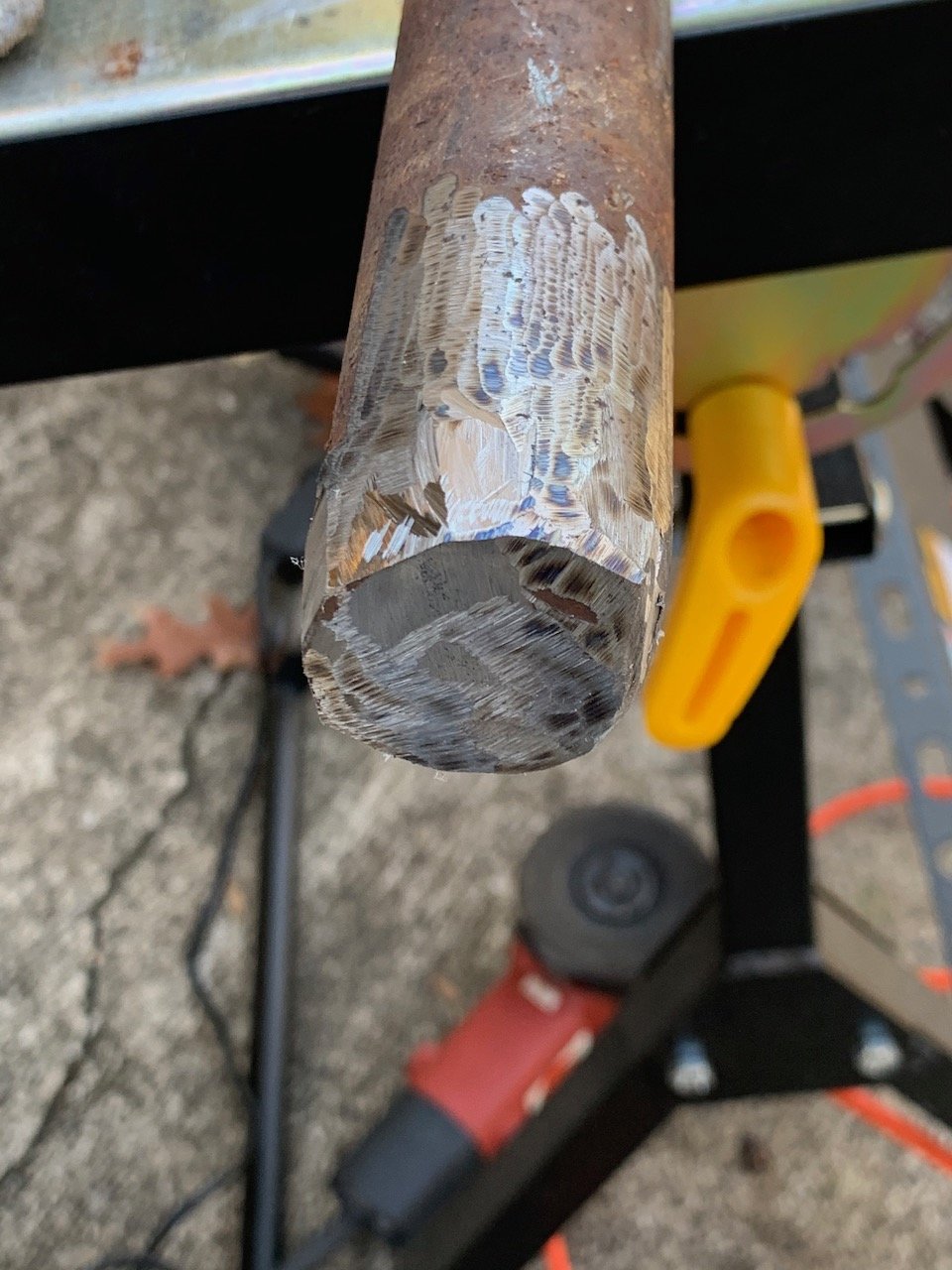

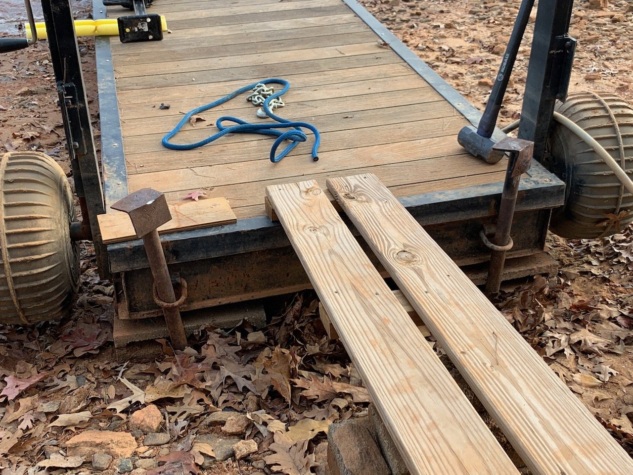

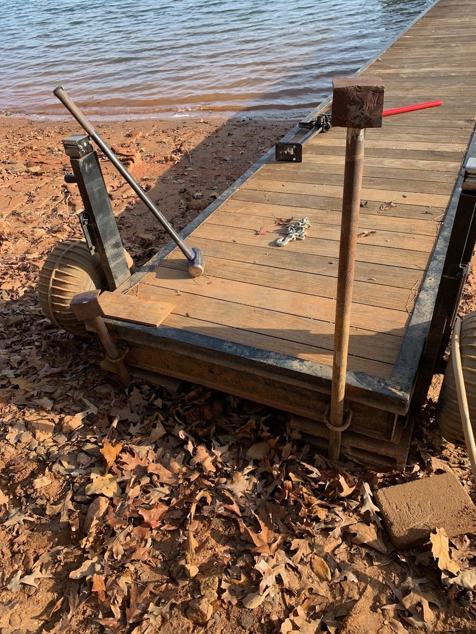

    So today I did a project I've been meaning to do for a while. Floating dock at the lake, which I move based on lake level, and use big pins to secure the end of the gangway.
    Guy who'd made the pins really did a sketchy job on welding the angle iron to the top of the pin and it popped off of one the last time I was driving them into the ground.
    Spend a bit of quality time with a cutoff wheel and grinder, cleaned everything up, and welded it back together.
    I was impressed with this HF Titanium 170 on 120V - this is about as heavy a job as I expect to do, and it seemed to handle it fine for what I needed done.
    Some pics of my amateur ugly welds - still way better than what I'd paid someone else to do, so there's that. :hattip:

    Looks like very good penatration.

    I'd say that "He bogged that shit in there deep" LMAO....
