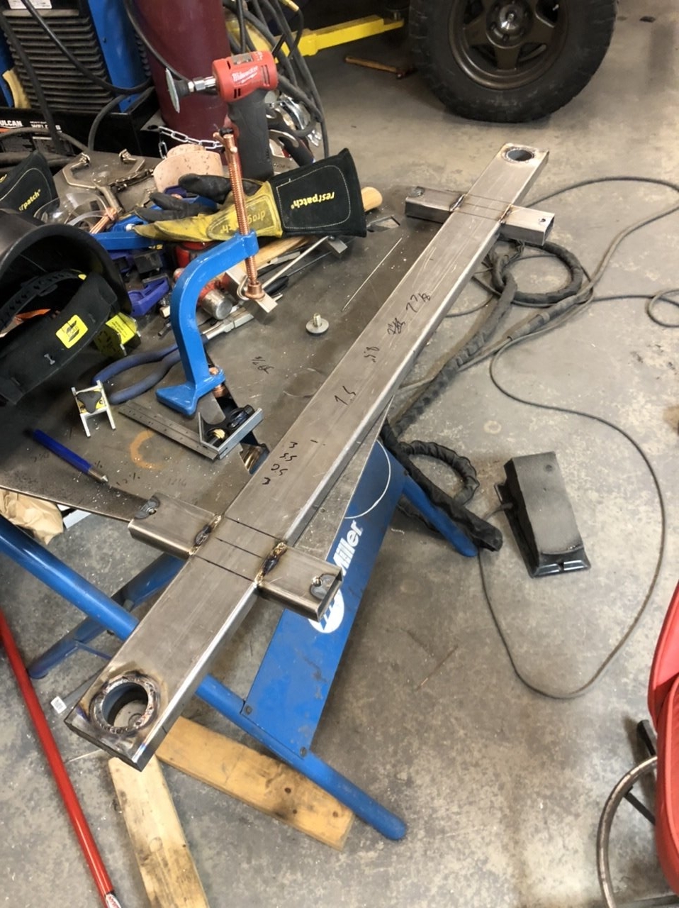

    My compliments to you doing that fabrication in such a small space.
    Watch the hots!
  2. Dec 10, 2020 at 6:47 PM
    Sandman614
    Oct 26, 2010
    #45273
    35,571
    Tim
    Garner, NC/Boone, NC
    '06 SR5 Off Road
    Gotta work with what ya got, it's the only "flat" space I have. I'm just happy to have that much space, it's been a long time working to get there. Still a long ways to go but this workbench should help clear up floor space.
