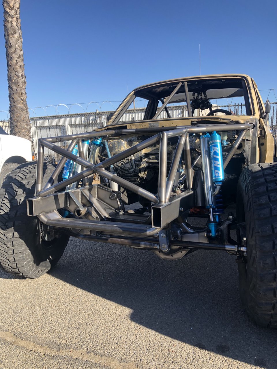

    8hrs later my beater is all welded up and under it’s own weight

    Those "A" pillar bars are on point! Nice work.

    What hasn't been modified?

    How do you even begin to design that? Impressive!

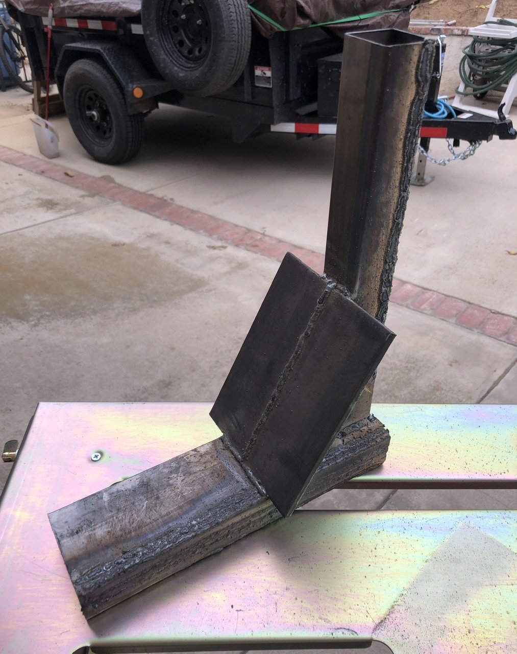

    Bought my first welder and welded my first thing ever. Just practicing straight lines and welding a few things together after a 1,000 hours of YouTube videos. I definitely have a new appreciation for quality welds it’s a Lincoln 140 120v. Hoping some day I can make an over landing trailer from scratch.

    Not bad, don’t forget to clean your material before you weld. You’ll get a better ground and a better weld.

    What diameter wire are you using? I found that .030 works great in the 120 machines. I started with .035 since that’s what came with it and the switch to 030 was awesome. Either way, those are some decent welds for your first go around. A lot of us are self taught, so just stick with it and practice practice practice.

    It’s all practice and patience. Keep at it, we were all new to everything at one point.

    Good on you taking up welding. It's a skill that can serve you your whole life.
    Is this flux core wire?
    From what I see there is massive amount of porosity. Can you snap a closer pic of the welds? I want to give constructive criticism, but not sure of what I'm seeing.

    Welcome! Good start, and some good advice above. Clean metal and good grounding path are important.
    There's lots of very skilled and very helpful folks here, don't hesitate to post a question or a challenge you're facing.
