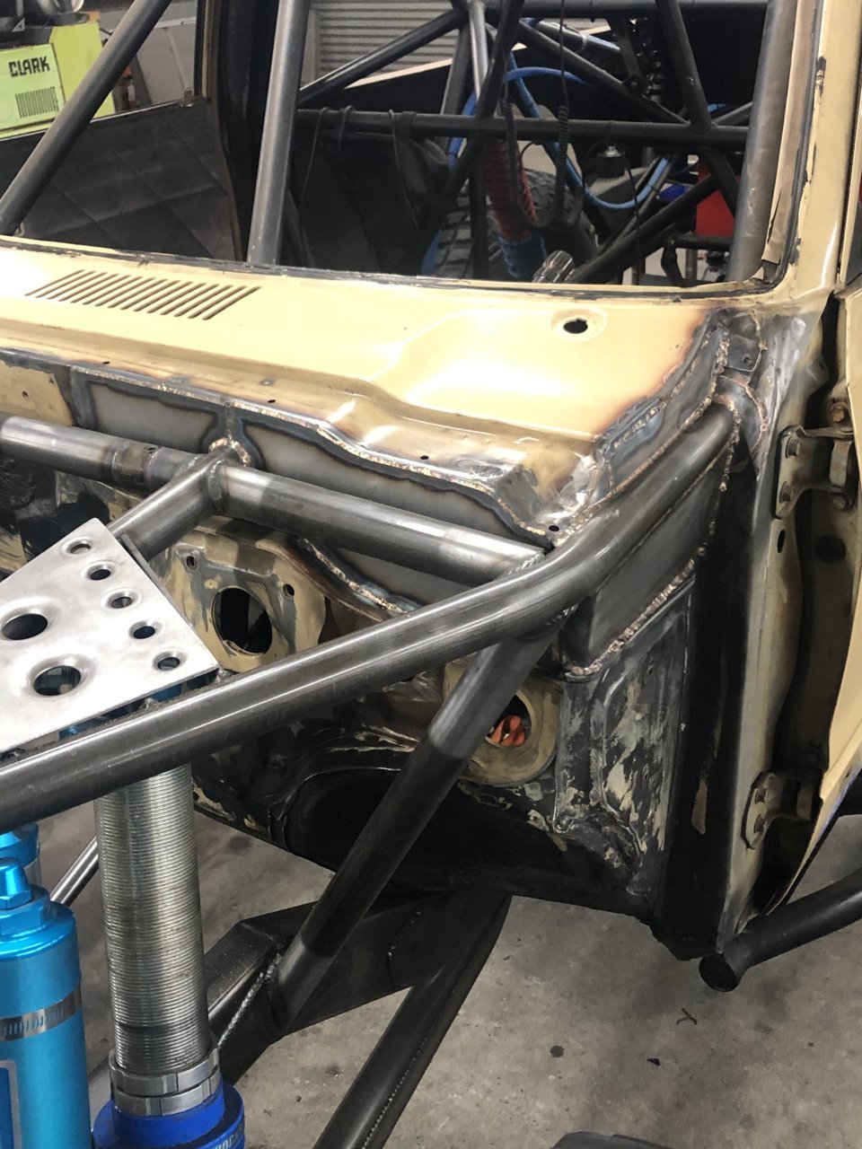

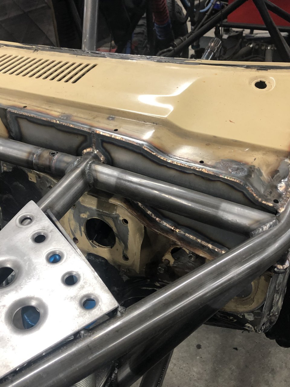

    Dude, your work is just next level shit...…. Awesome..

    Your welds look awesome! You do nice work.
    If this is a stupid question, you'll have to pardon my ignorance.... but isn't there a concern with welding the body to the cage like that? Won't the sheet metal tear when things flex?

    Judging by his other builds, I'm assuming the frame/cage/body are all solidly mounted together, so they won't flex like our cabs would being mounted on rubber bushings.

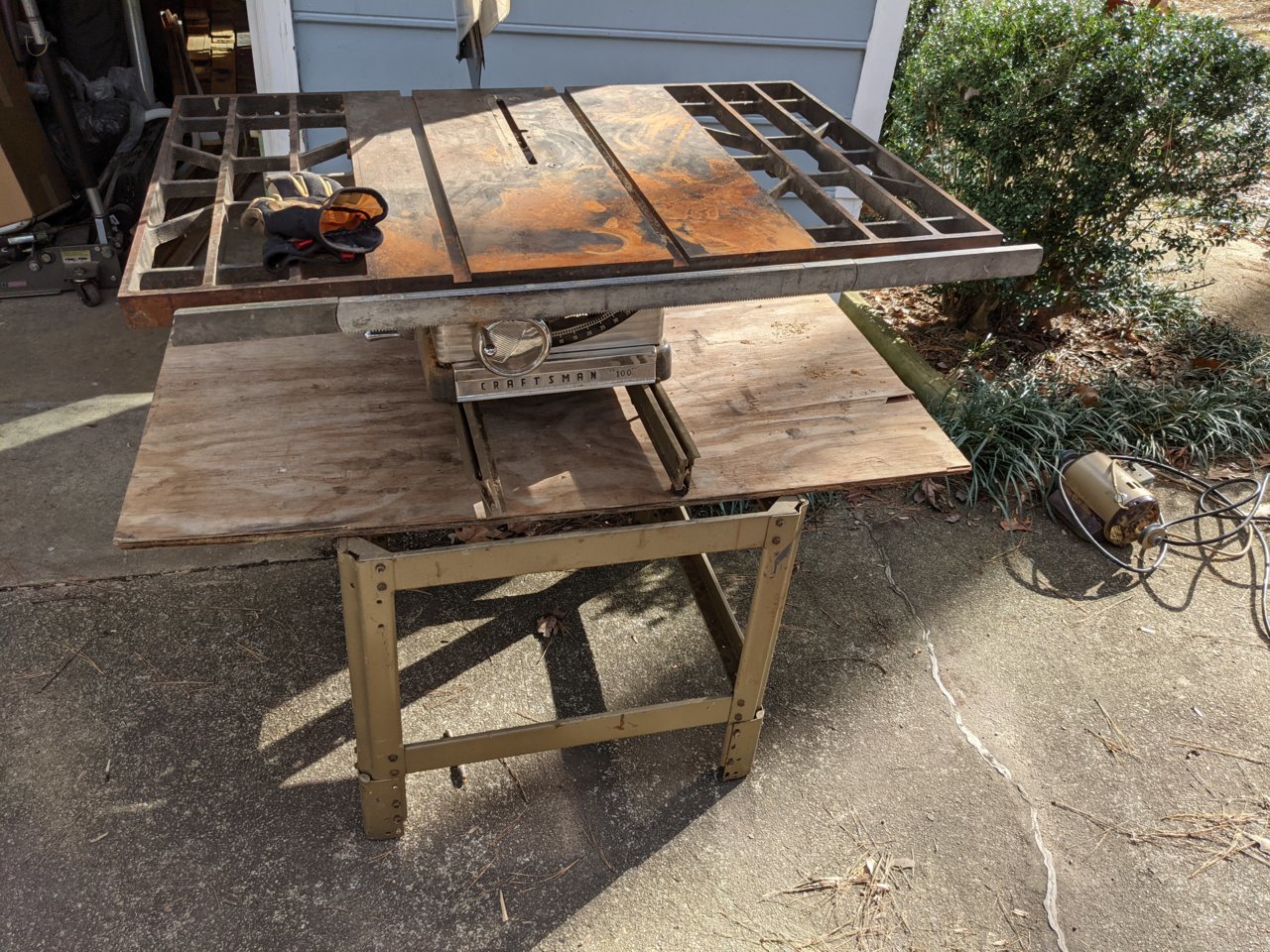

    Wonder what I can weld up with this gem

    The entire cab is welded to the cage as the truck has no frame or body mounts. I also use silicon bronze filler rod as it allows for a little flexibility as opposed to ER70

    Nothing.
    That's a table saw, not a welder.
    :D:rofl:

    In his defense, those saws are worthless to me, but the table top is perfectly true. Would make a pretty good fab table top.
