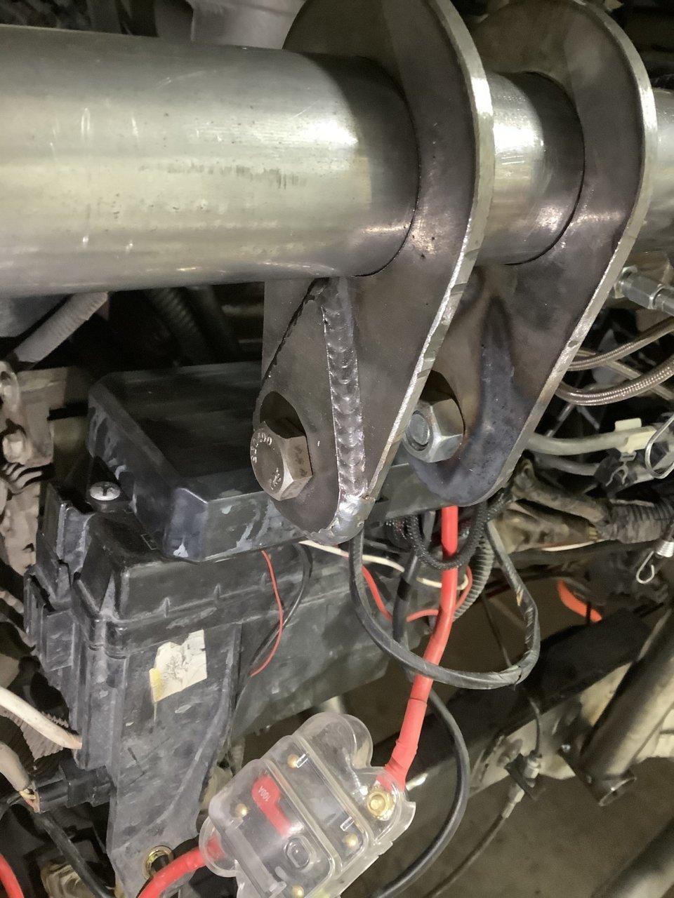

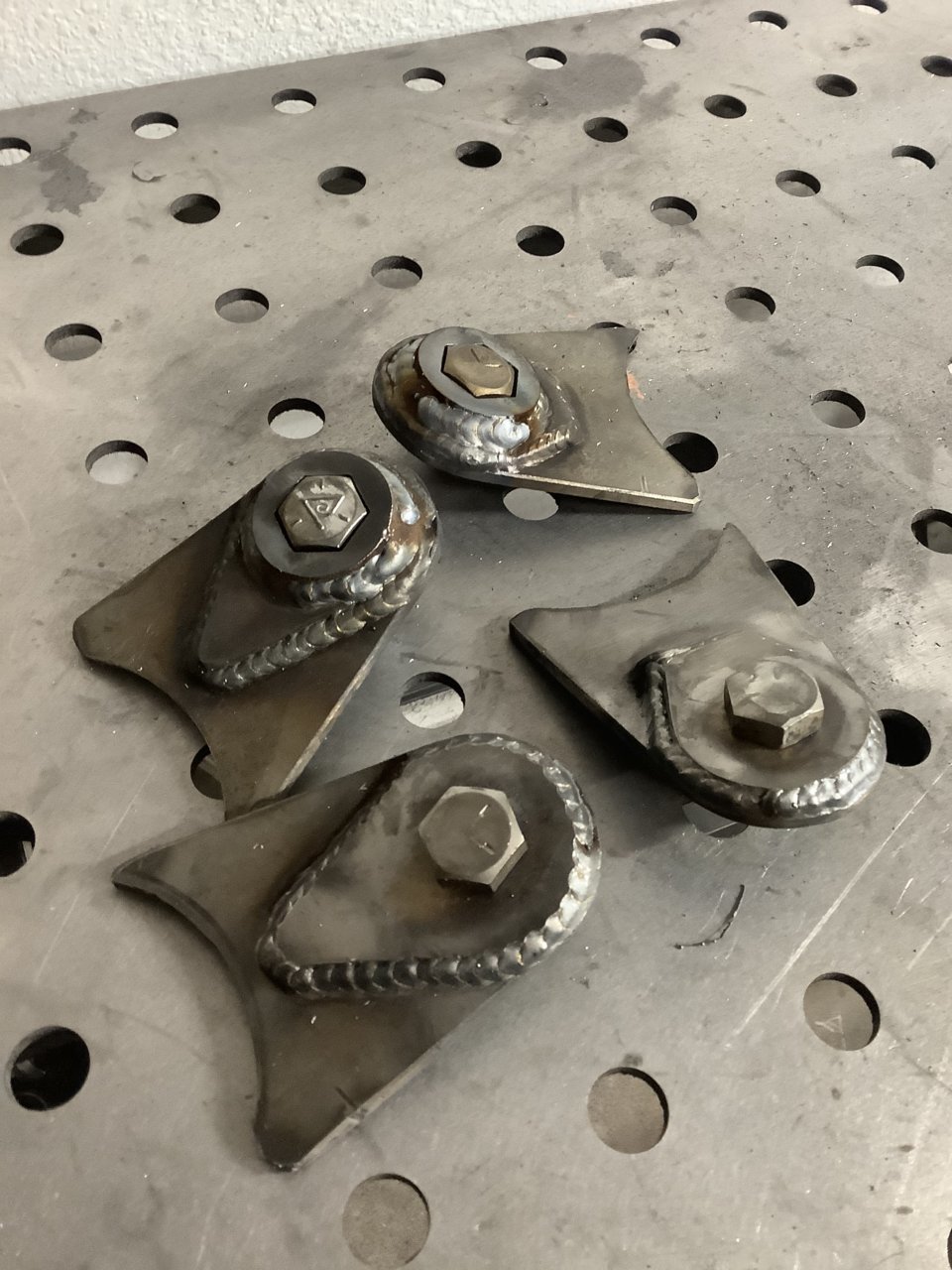

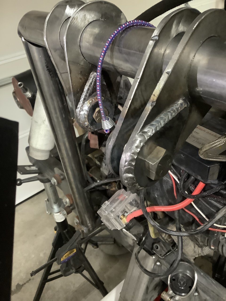

    I welded this tonight (3/16 to 3/16 besides the capture Nut is 1/4) and used 18.5 and 220 at first the. Went to 18.7 and 230 to do the 1/4 in part. I start at 19 and 230 when doing 3/16 typically.

    You can see there’s plenty of heat in the tabs and I welded some and let them cool. I start with the auto set and normally leave the voltage and turn the wire way down if I’m unsure. I turned the heat down on these cause of how small the tabs are. Frame and big pieces I turn it up to the 19.7 or 20 ish since it’ll suck more of the heat.
