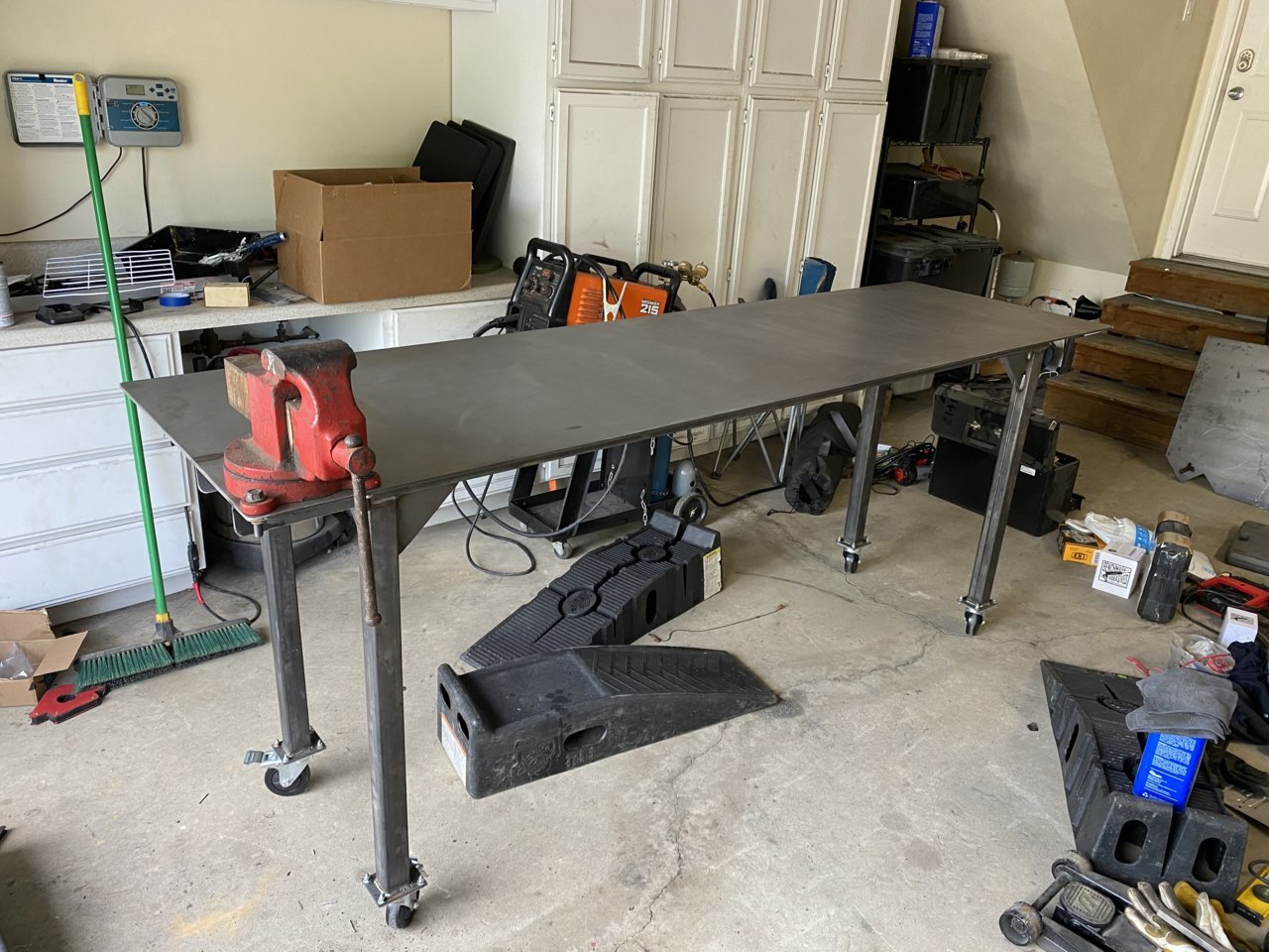

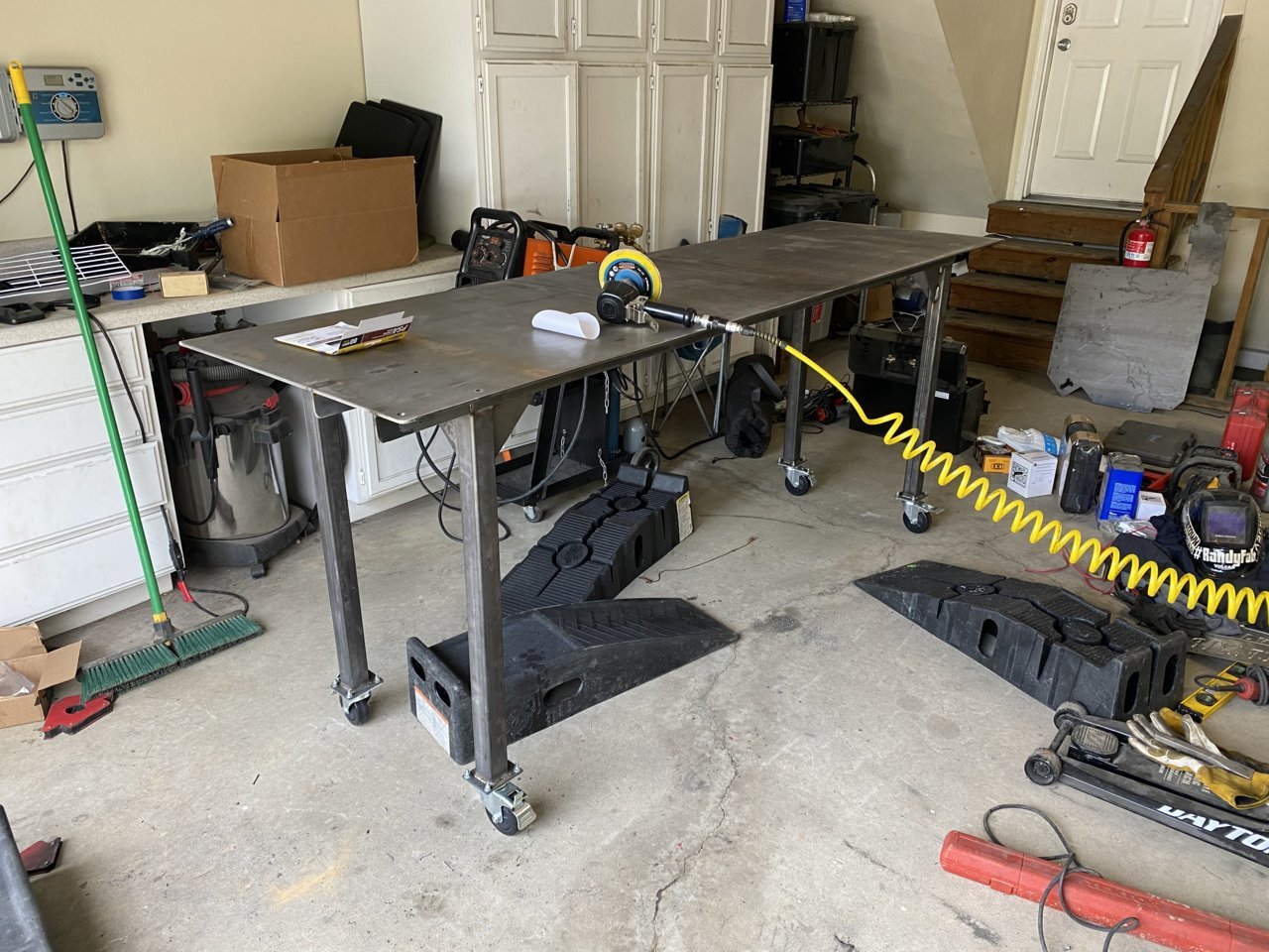

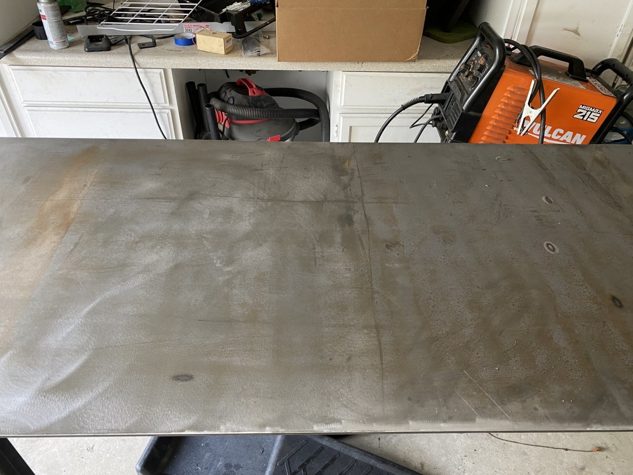

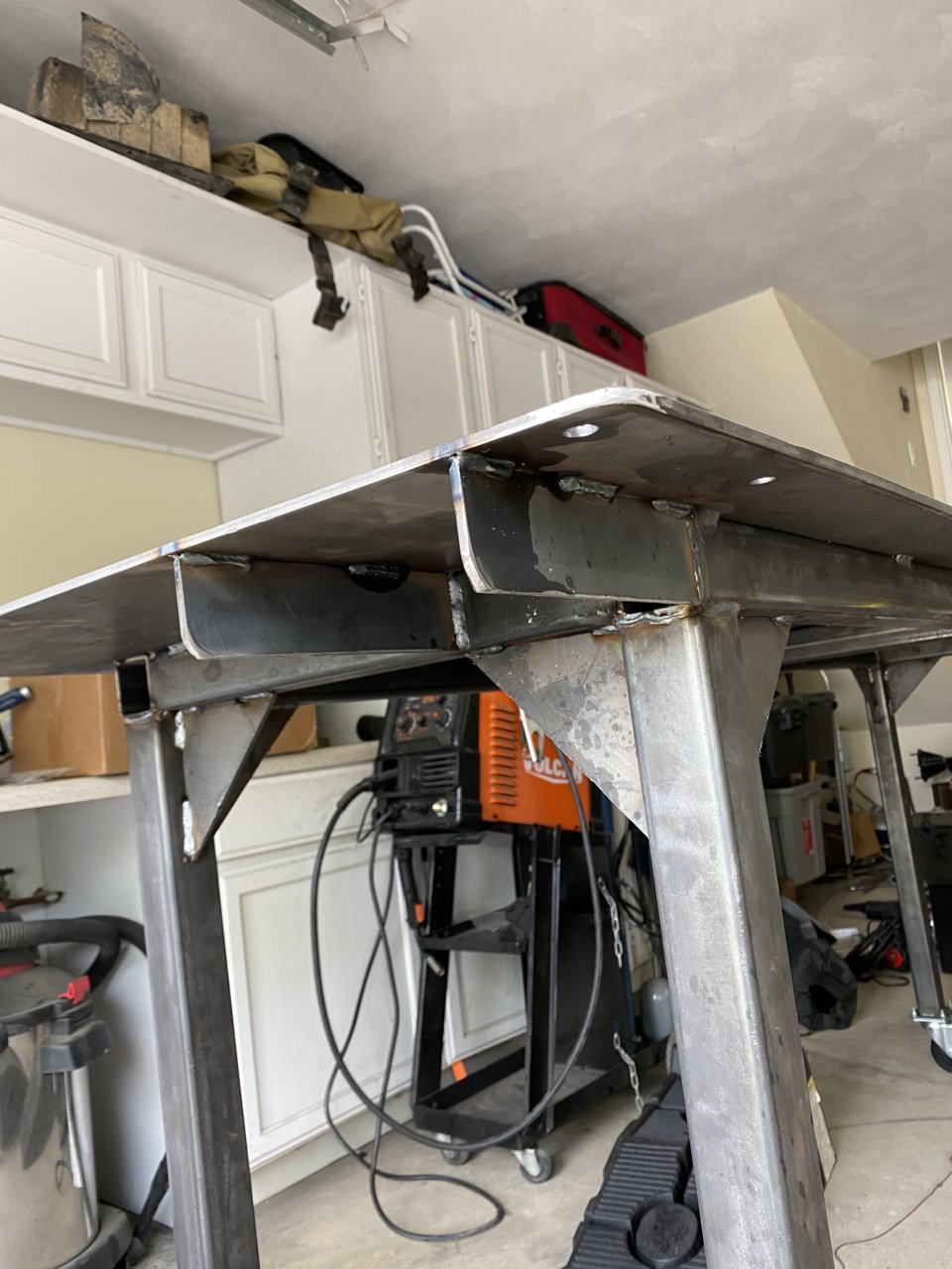

    If you have the room, a table is worth it’s weight in gold. Sheets of steel come in 4’x8’ so I got a sheet of 1/4” plate and 2” x.120 wall square tube and made a table. It’s 8’ wide a d 28” deep because that’s all I could fit. I love love love having a huge, tall, sturdy work piece that I can beat on. It was about $300 in material. Nothing fancy and doesn’t require any fancy welding skill.

    More pics in the quotes above.

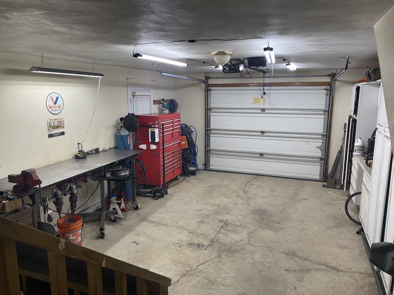

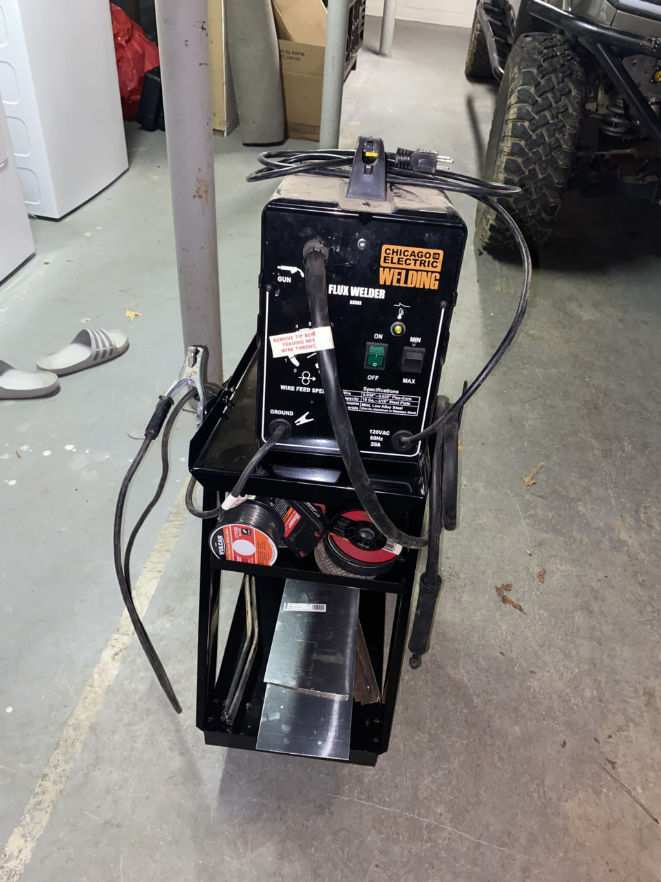

    here’s my garage and current setup. I plan on upgrading to a titanium 140 mig once I get some more time under the torch. Ceilings are low but it’s deep and fairly wide. I could probably fit a table that big in there.

    Ahhh nice. I’d wait for a big project like the table then until you pick up the nicer machine. If you’re planing on upgrading already, I’d just do it now if you can swing it. Save yourself the frustration of that flux welder. You’ll be amazed how much better it performs and how much easier it is to use.

    yea ive been debating it. just dropping the coin on the welder and then a gas bottle is a big investment haha.

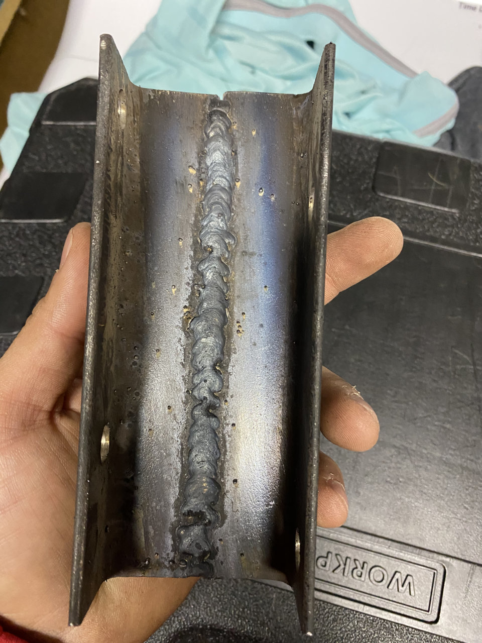

    Here’s my most recent weld. Just practicing on some angle iron making c channel.
