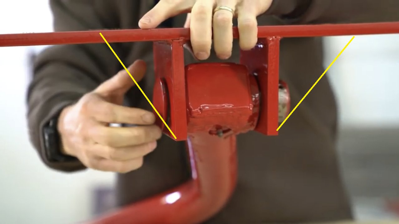

    I agree with the above. You will be able hold the whole family using 1/4".

    lol it'll definitely be overbuilt, that's for sure. Nothing wrong with that though.

    I like the gusset idea. Would you do them on both sides of the pin, so a total of 4?

    I would, yeah. Not really necessary but I like the symmetry and it wouldn’t add much time to do.

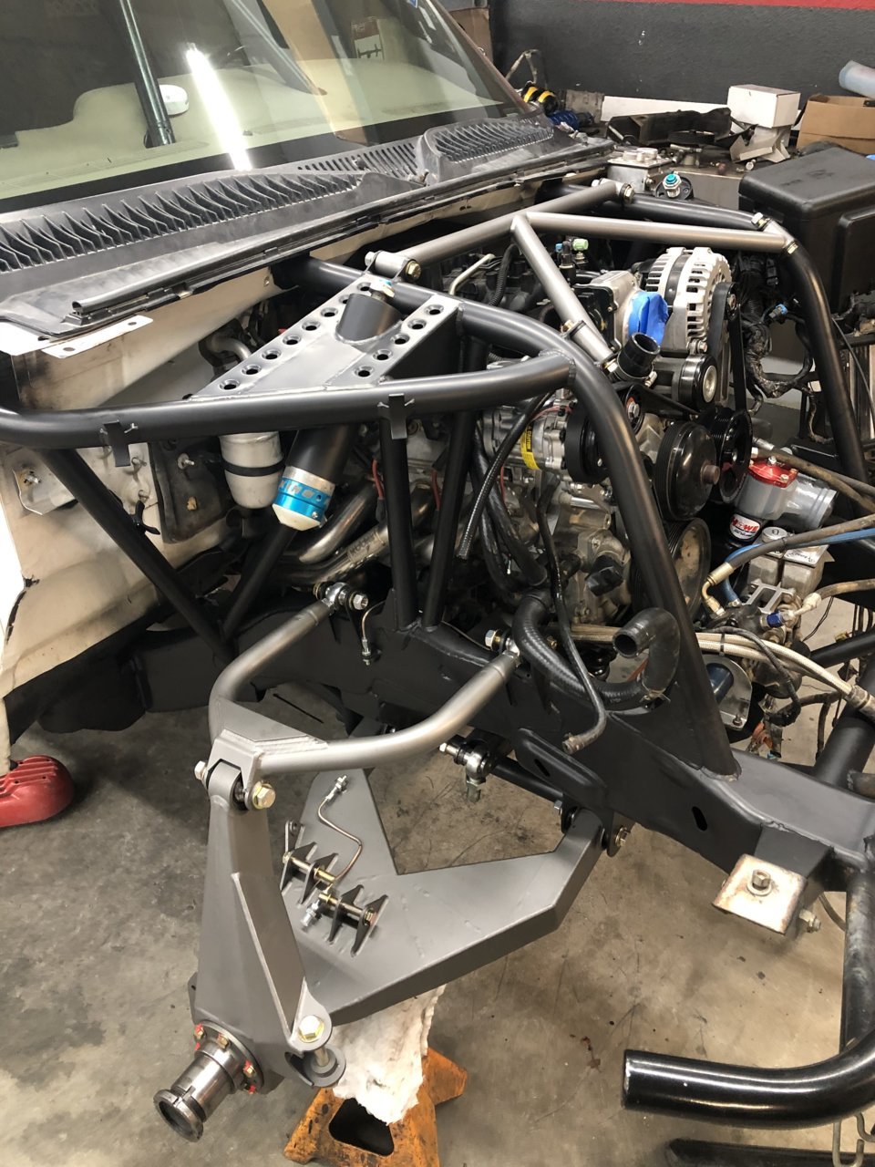

    Just about finished with this Silverado kit, the arms and shock mounts are all tig and the engine cage is mig...

    So badass. Well done!

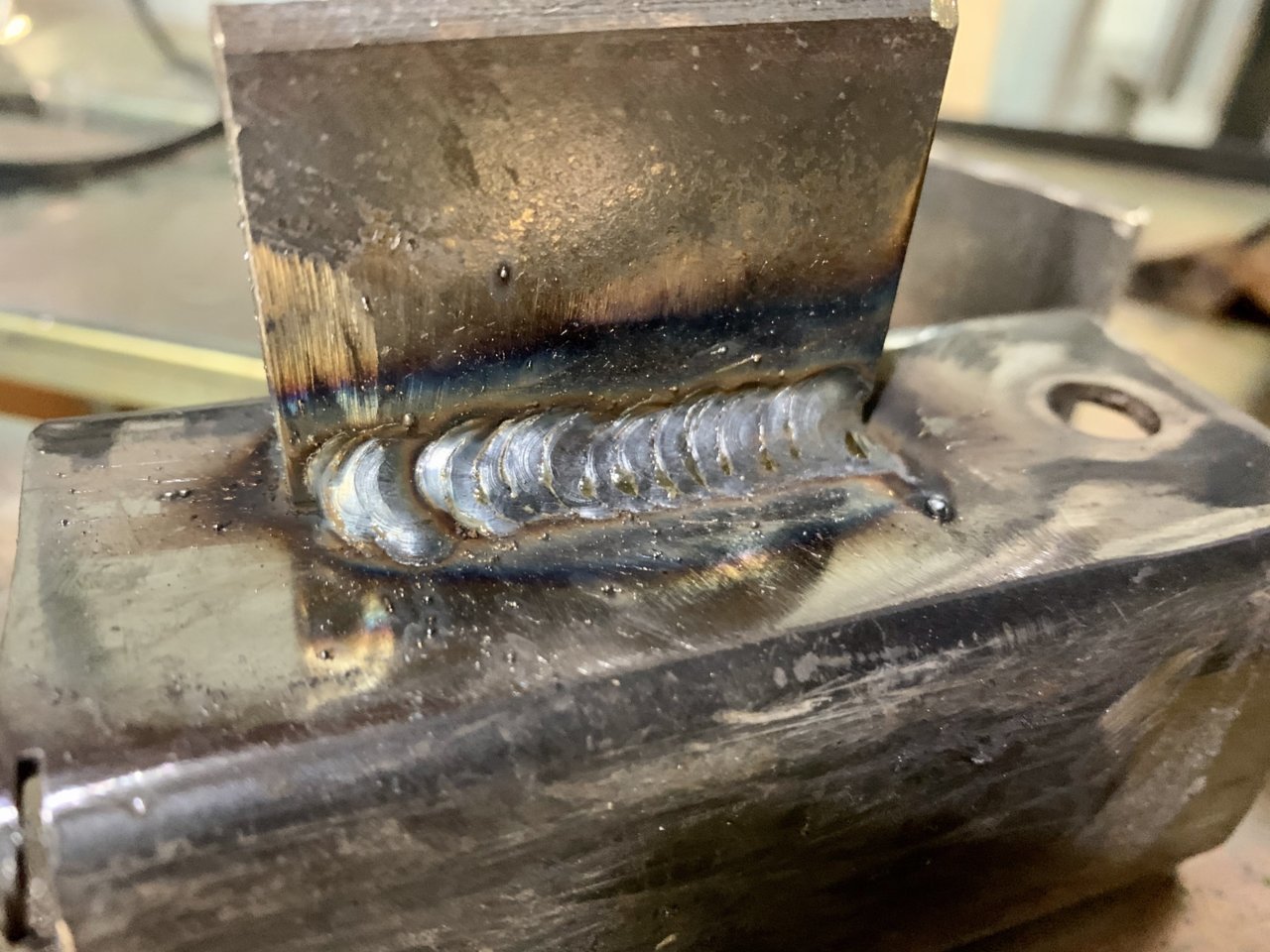

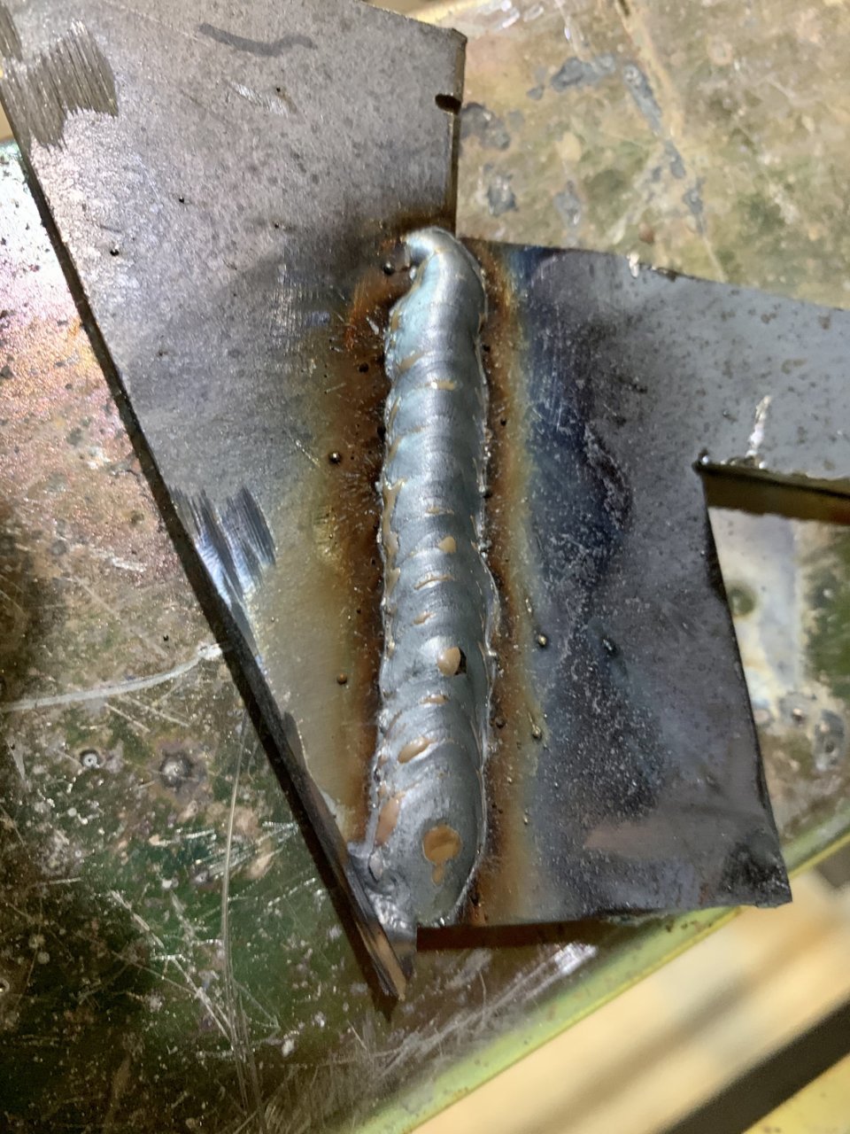

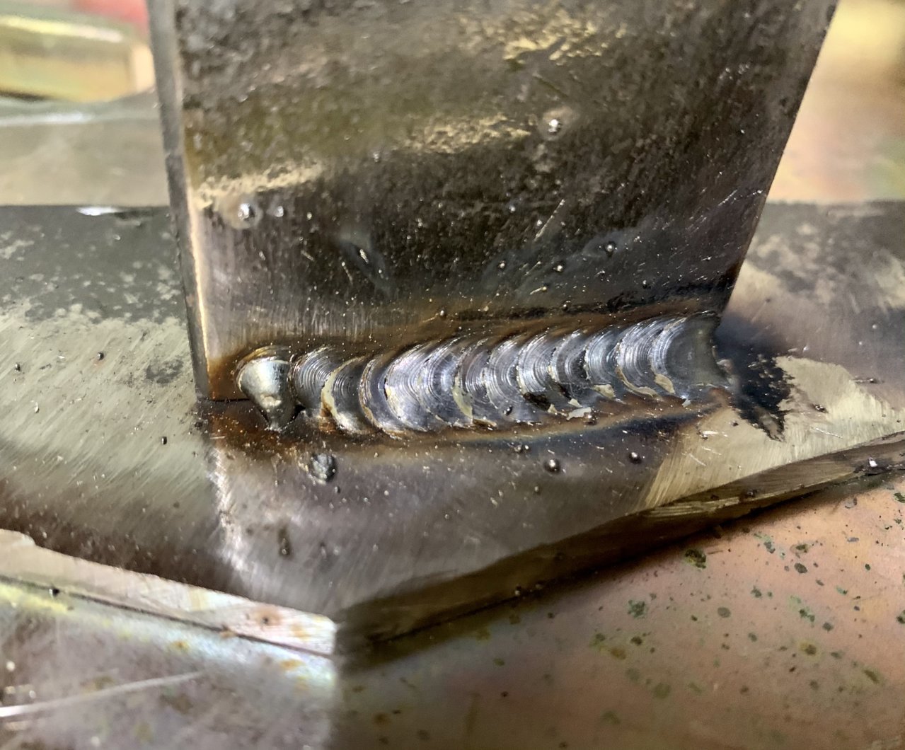

    Here are my very first MIG welds. How can I improve them?201C8200-2CB8-4FF6-9A8F-4EED0D8F55AB.jpg62E985F9-9C55-41BD-82D6-199522755C12.jpg 05658696-D737-4EF4-BE05-C5D4725FBD04.jpg

    Is this flux core? If yes, they look about the best you are going to get.
    Maybe work a bit on your steadyness, but you are definitely in the right neighborhood.
    Look great for the 1st time out!
