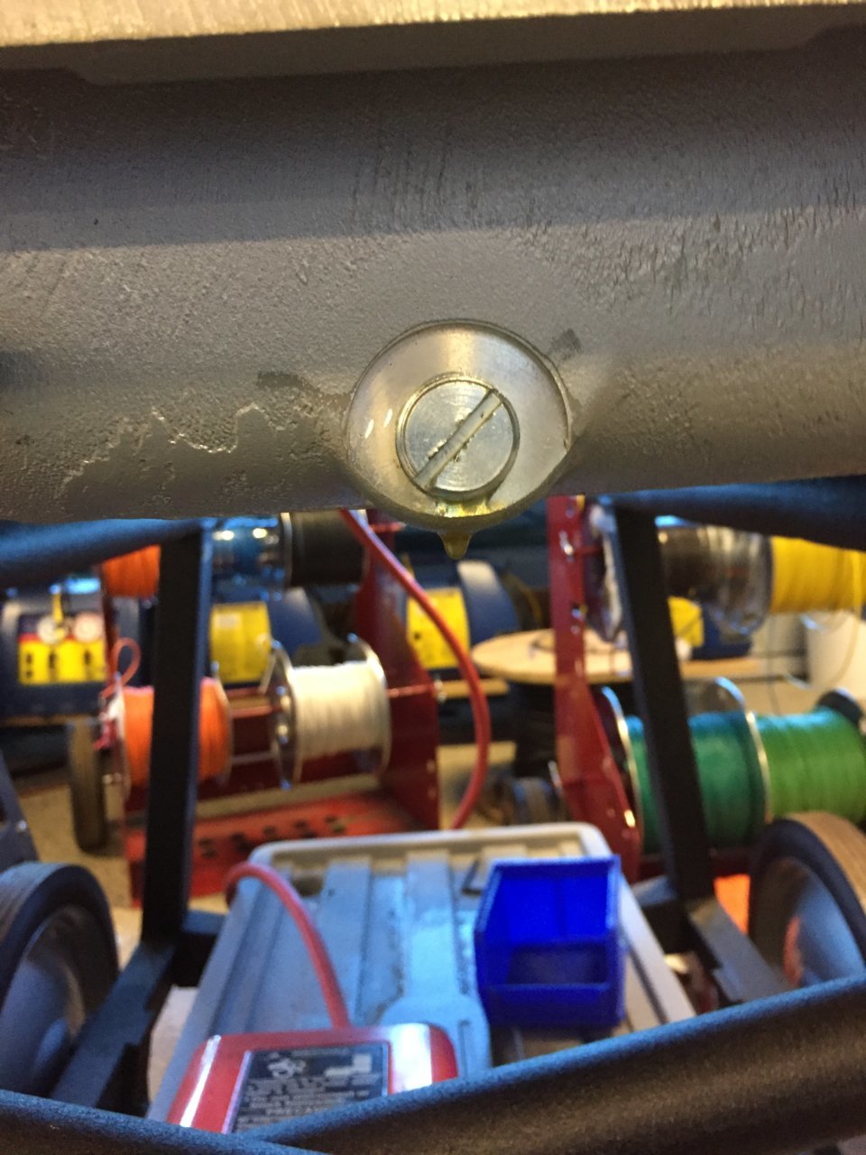

    Nice!
    I'd be shopping Fumoto for a compatible drain though if it were mine ... :D

    There are a few with ball valves on the drain actually! Makes it much easier.

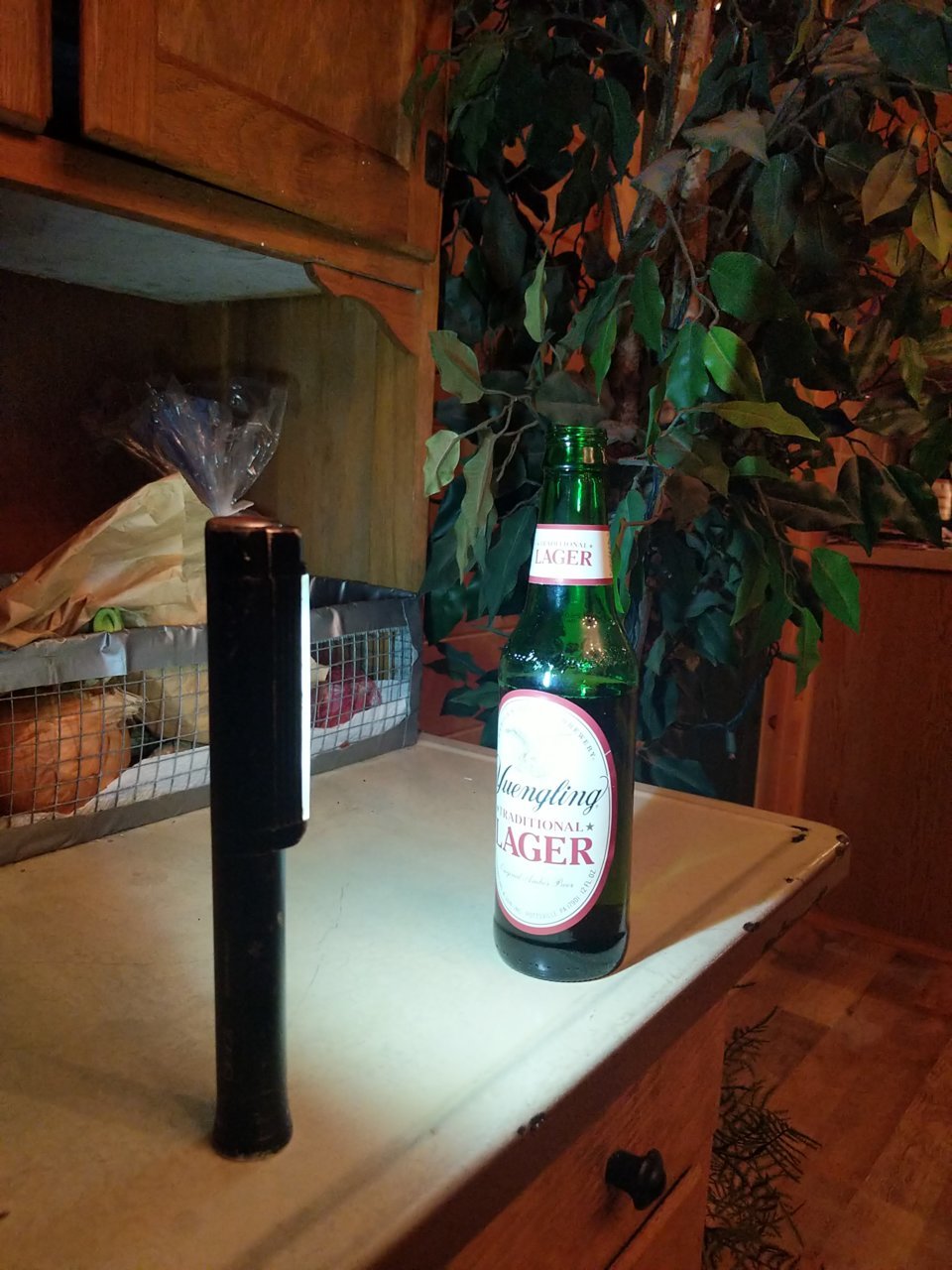

    I love this this light! Helps so much when you find yourself in a position with poor lighting. The magnetic base is amazingly strong!
    I like #10 setting, but like said, we all see different.
    No hating on those that like the digital readings. The repeatable settings would be great...if I took time to note the settings between jobs...I don't take the time.
    My transformer machines have infinite adjustable rheastats on both the heat and speed. I'm happy with what I got.16100694343352917012092074341105.jpg
    Edit: the light is called: Big Larry. Yeah, i laugh at the name too.
