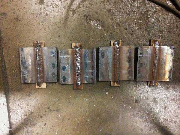

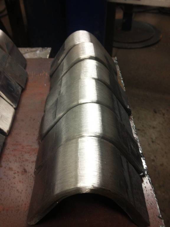

    Hey guys! Didn't even know this thread existed! Some awesome looking welds in here. Will have to stick around.
    I don't have many pics of my welds exept for my last cwb weld test.
    This was all position stick done with 1/8 7018 ran at between 110-135
    From left to right : overhead, vertical, horizontal, flat
    Bend tests all carbon arc air gouged, flame cut and belt sanded then bent
    [​IMG] [​IMG]

    Look at build!
    :eek: Holy shit those are hardly bent! we bent ours to a full U!

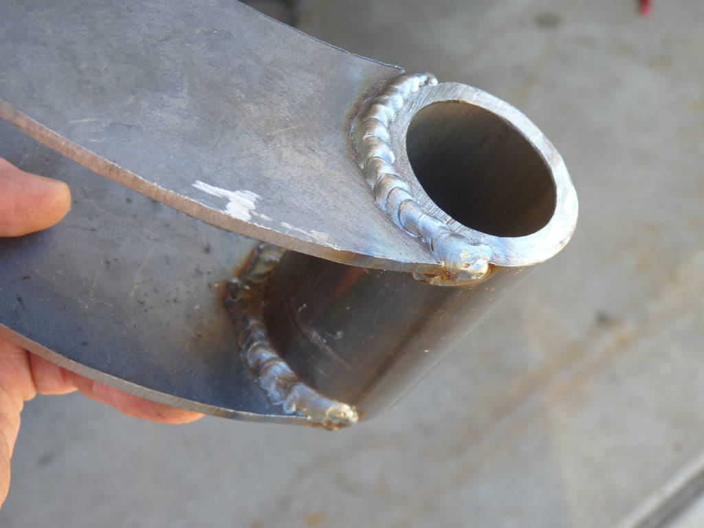

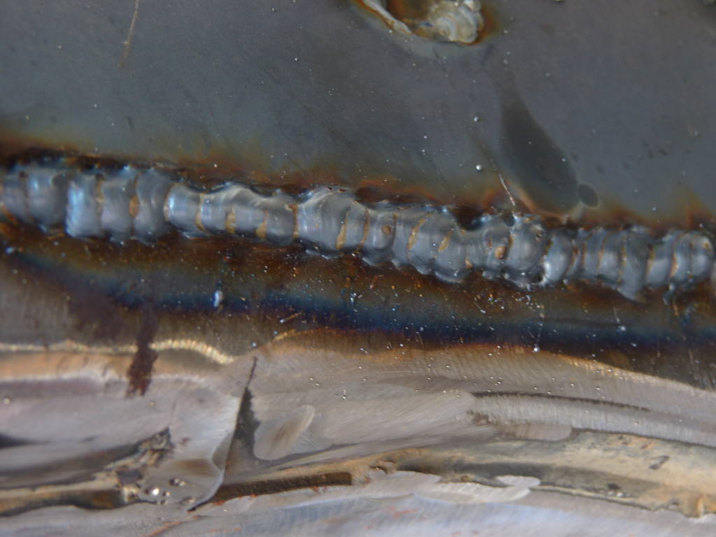

    Thanks. I'll get started because I better improve by yesterday since I'm in the middle of this SAS project haha. :anonymous:
    My halfway (at best :rolleyes: ) decent welds
    My SHIT welds

    Really? That sucks! I haven't seen an inspector do that before.

    Wasn't bad, not too hard to pass but yea, ill see if I can find a pic of mine. but we also only did 2 position testing instead of all 4 at once.. I only tested in 3G/4G for stick and mig flux. Passed my flux test the first attempt after only running it one day and only running one plate 3G/4G. but mig is super simple so nothing to it and flux just lays right in there its just hot as can be. Sitck is my 2nd favorite though!

    Looks like its cold and travel speed is too fast

    Not bad, not to bad at all. Your speeding up and slowing down and it is a bit cold. The stops and restarts are hard to match, keep at it. Consistent speed is the key once you have your settings right for the material and machine you are using. Watch your duty cycle on your machine,,you can't just buzz a 6 foot long weld on the average unless you spend big bucks on a production type machine.
    Alot of guy's and gal's don't even care to look at those recommendations and then try to figure out why there welds look like crap when in fact they are overheating the machine and burning it out faster.
    (Case in point,,The 110v hobby box wire feeds have a short duty cycle (very short welds recommended)
