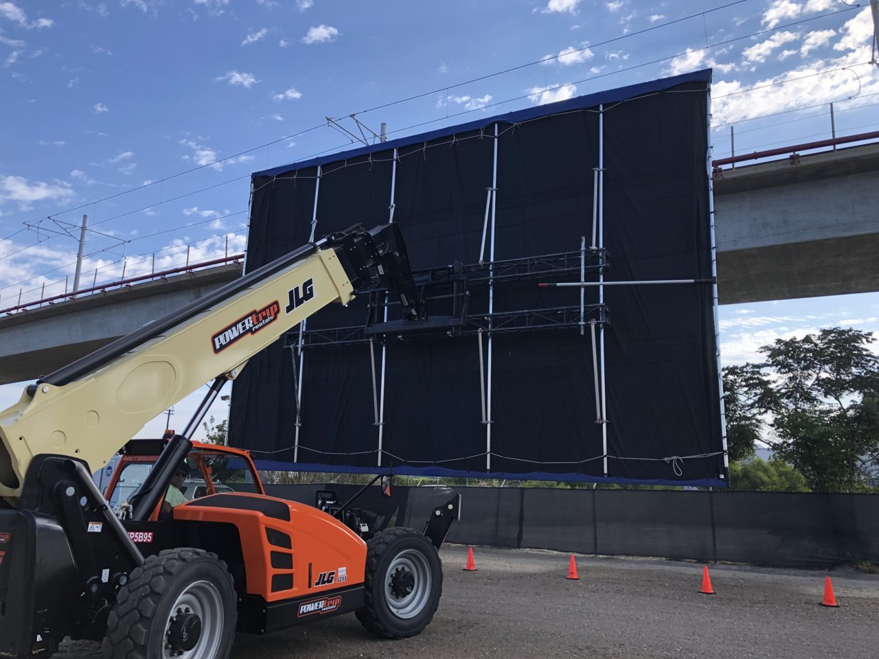

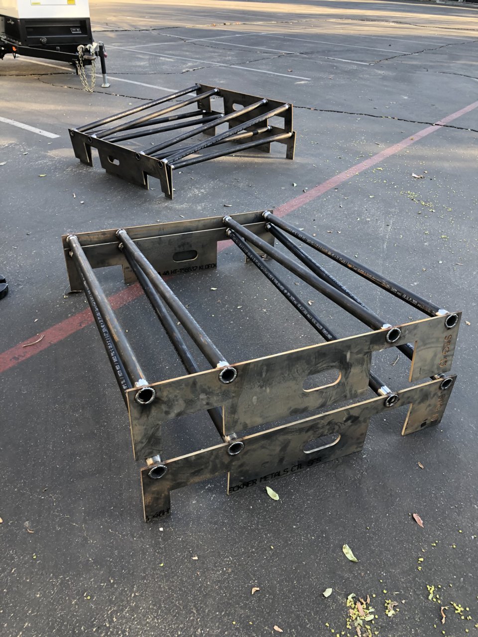

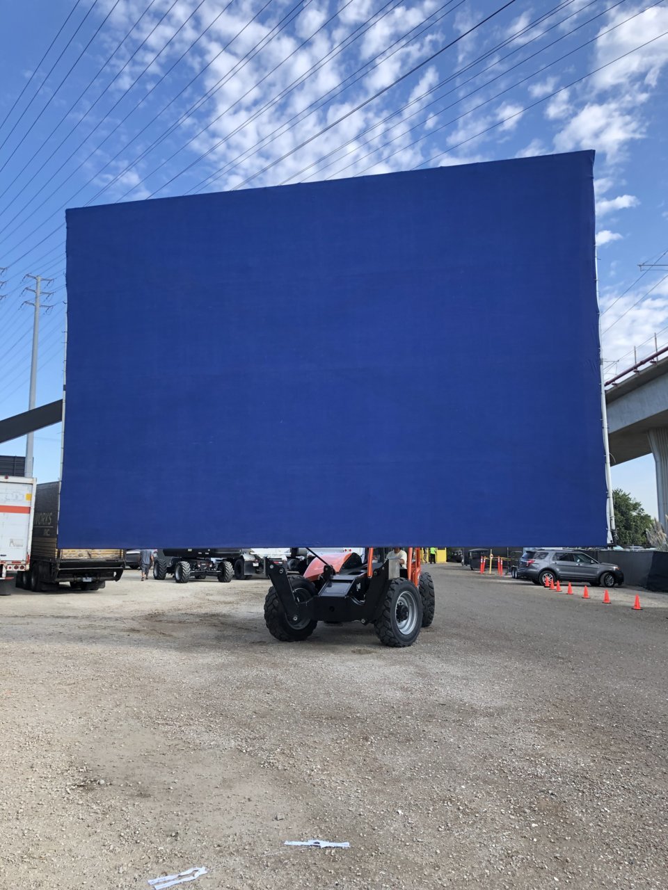

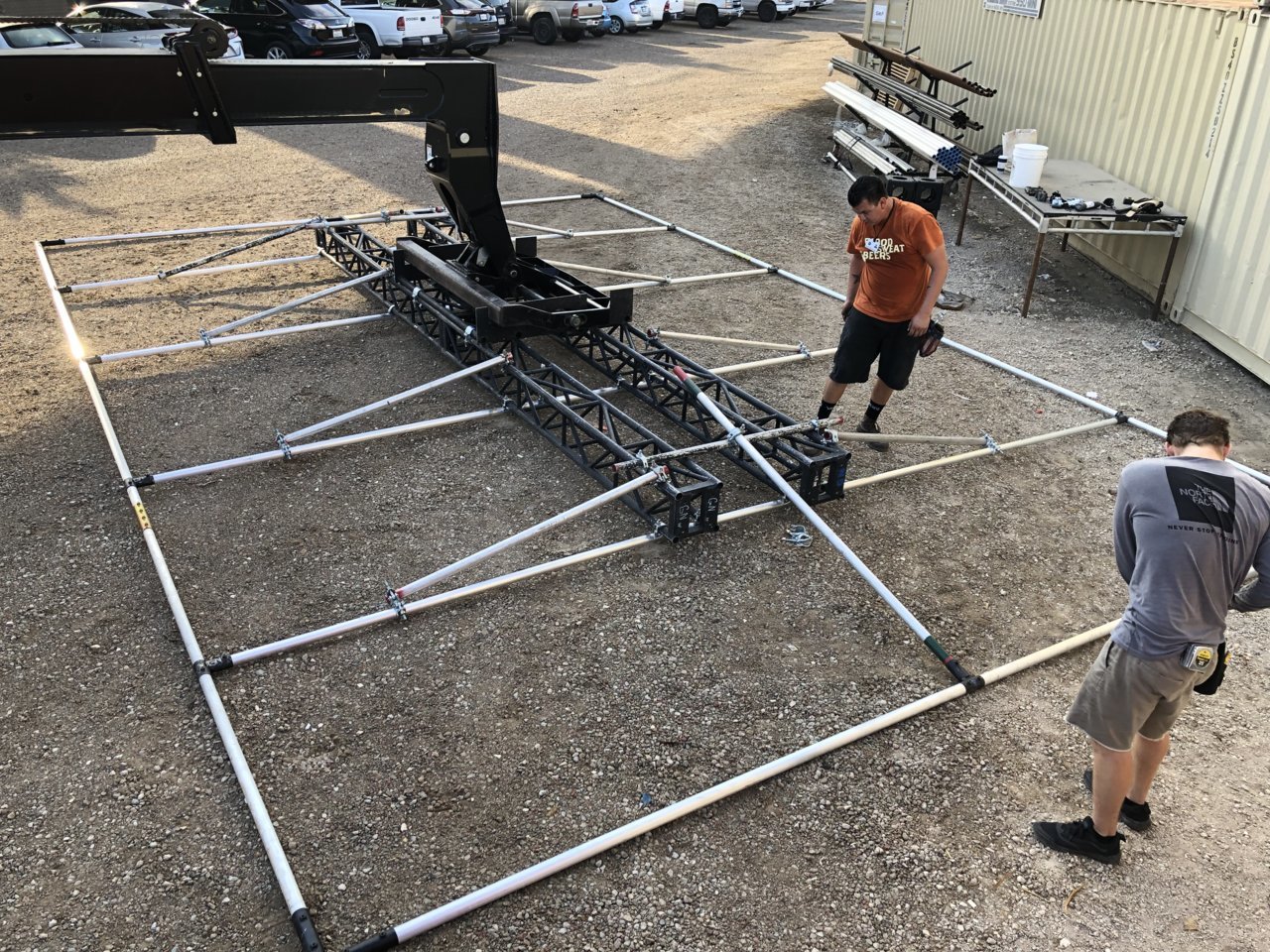

    Cooked up 4 more of these brackets that we use at work for attaching frames we build for portable blue screens/green screens on telehandler lifts

    Was it @koditten who said they made tie down points with half cut Dom tubing? We’re you using .120 wall?

    1/8" wall pipe is what I used...I think. I'll verify. I'm building a ttailer pfresently.

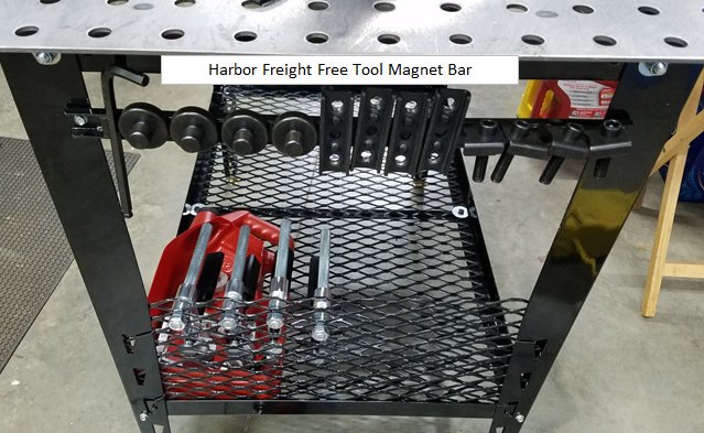

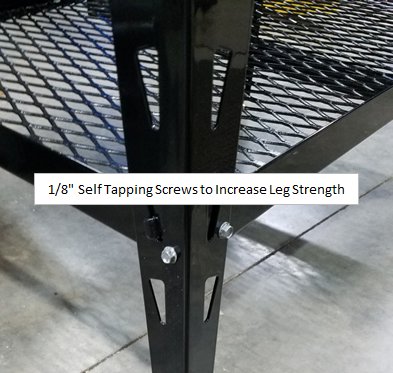

    I got my table yesterday. I started pimping it last night, and made more progress this evening.
    Bought some 5/8" bolts. Bought both types and the ones with some unthreaded area definitely work best. Much tighter fit.
    Have an idea for my casters (ordered). I am going to mount them to the leg, but leave the levelers in place. That way, I can still use the levers to raise it up, and the casters will be elevated above the floor. I will post update after I mount them.
    Also, have the beginning of idea for making some extensions for welding longer items. Will share later.
