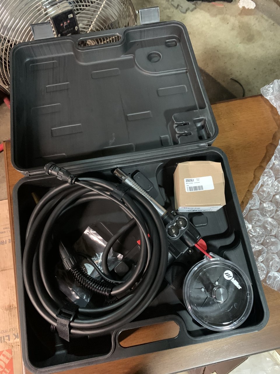

    New toy :)ACDD0FF4-9226-4C34-9481-91FAFD3F9653.jpg

    I have that Milwaukee, it’s a beast, but $100 it isn’t cheap- I have a $40 Bosch that’s 20 years old and still going strong

    How much?
    18 years ago I paid $1100 for my 30A. I honestly think it's kind of chintzy. Never was impressed with the quality.

    $350ish, then the bottle of argon and a bunch of consumables specific to aluminum
    Yeah, it’s definitely entry level, only option for a Millermatic 180. I work in a lot with a fabricator in the warehouse next door so if I need to go thicker than 1/4” aluminum in a single pass I’ll hit them up. Can’t see a need now and couldn’t justify $2500 for a new machine and a better spool gun

    I think as for Spoolguns the 30A is the best one out there of all I have used and worked on.
    Though if you have that much aluminum work to justify going to a aluma pro or python set up foolish not to .

    I got mine for $40 in the clearance section at my local home depot. In fact Ive picked up so many good tool deals in that section I can't go to home depot without checking it.

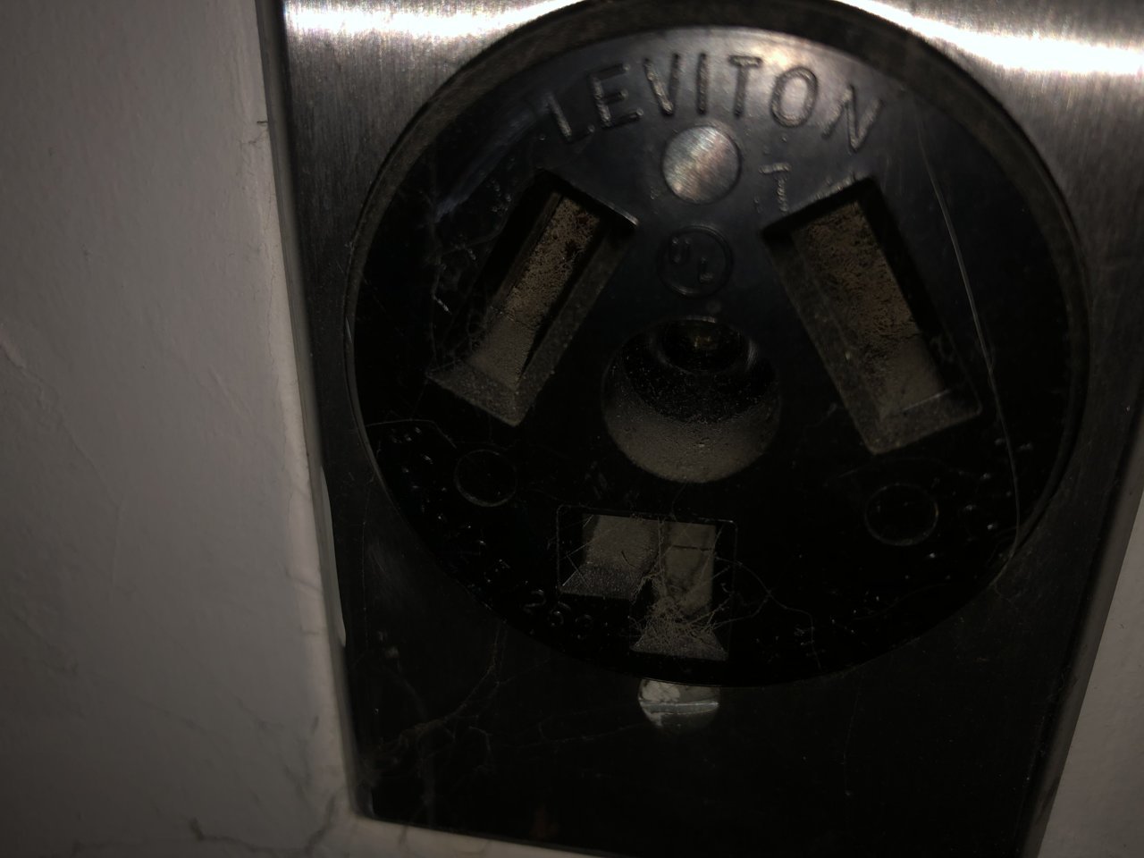

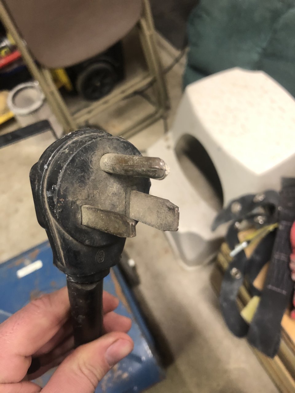

    Would anyone happen to know if I should swap out this plug (Miller thunderbolt 225, style No JA-49) or should I swap out the outlet (assuming an old dryer outlet)? Or am I wrong completely

    Its the 1st thing I do. I even get rid of the stupid, rigid power cord. As long as I use 10 gauge, there is no issue.

    Are you still planning on using the outlet for a dryer or other appliance? I use my dryer receptacle for my welder extension cord, so I changed the plug on the extension cord to match the dryer. If you don't plan on using that receptacle for anything else, it's your choice at that point.

    unfortunately I put the multimeter to it and it’s only 120v. On the bright side it’s not used anymore. So I think if possible I’ll have to bump those numbers up a bit somehow, maybe a bigger breaker? I’ll have to look into it

    Up to you. Welder plug is NEMA 6-50. May be worth replacing the cord and plug with SOOW cable in 10ga.
    Wall socket, I’d either convert it to 6-50 if you’ll dedicate it to welder or keep it as-is if you expect to keep using it for whatever is in place. It’s NEMA 10-30 I believe
