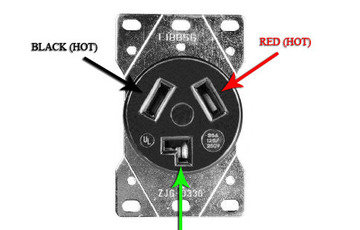

    sure on the 120? Should be 240 across the two hot lines. 120 between a hot and the neutral.
    I’d suggest rewiring to include a ground line if possible tho.

    Oh thank you I wasn’t aware of that! Rechecked it and it read out 241 thank you! Thanks everyone for the information!

    A 240 volt load doesnt require a neutral, so the receptacle should already be grounded.

    Where were you measuring? It should measure 220-240 between the two big spades, and 120 between the spades and the 90° lower and center socket.

    Dryers often use both 240 and 120. These days they use a 4 prong to provide neutral for the 120v usage. Old installs with just three wires might be using neutral or might be using ground. Best to make sure it’s not neutral.

    the outlet ended up checking out exactly as you described

    how does that get checked?

    You can follow the wire where it comes back into the panel board and see if it connects with the other grounds or goes to the neutral bar.

    Perfect. Now just go to Home Depot or any other hardware store and find a plug kit made for that receptacle configuration. I've had to buy a few different plugs for my extension cord depending on the dryer receptacle for the last few houses that I've lived in.
    Are you wiring a 220-240 machine?

    yeah I’ll be wiring a 220-240

    As @Mojo Jojo says, best is trace it back and see if the third leg goes to ground or neutral bar.
    As a first check tho, see if the outlet wires are white, black, and bare cobbler or if they’re black, red, and white. If the latter there’s a good chance it’s neutral not ground. Still would want to verify at the panel.

    Bring that picture of the receptacle with you, it'll help ensure that you get the correct plug. Follow the instructions with the plug (paying attention to which terminations are hot vs neutral vs ground).
    Make good terminations on the plug kit and you'll be set.

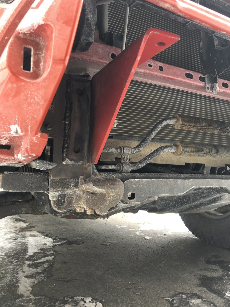

    working on learning to weld 1/4” plate. Earlier in the day on a separate machine I didn’t own, I was using a 7018 rod with it turned all the way up. Long story short, someone I knew was selling this machine I currently am trying to set up, just trying to make sure I’ll have everything set up properly. These were the welds from earlier, I didn’t do them was just more or less shown a few things
