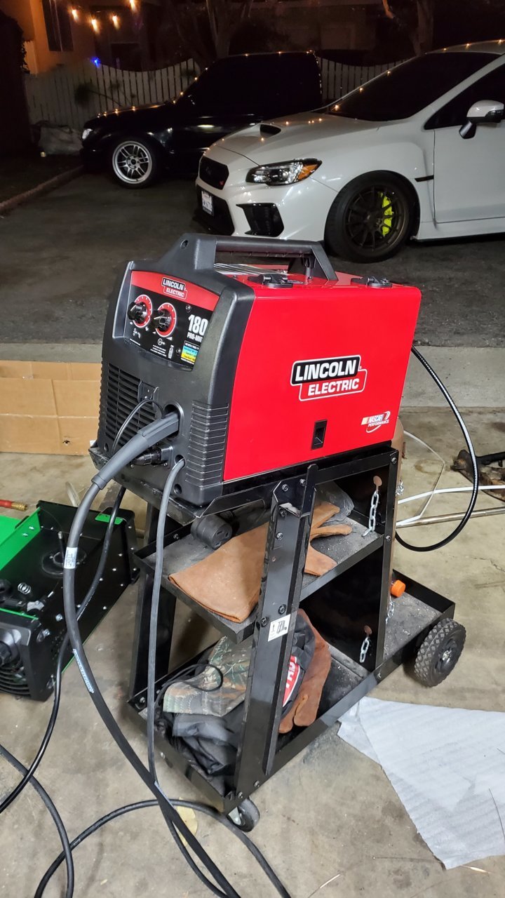

    Well I unexpectedly upgraded my mig today.

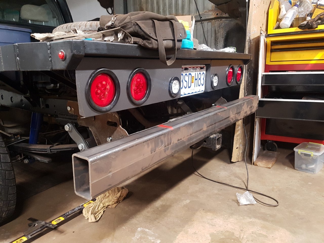

    So, what say y'all about building receiver hitches into bumpers? I'm needing to put together something for the rear end of this thing. I figure either I can reuse the existing hitch by getting new plates made that connect the ends to the frame but don't drop down like the oem ones. Or, I could save some weight and departure angle by just integrating a receiver into the new bumper.
    I did some rough numbers and it seems like I'd have to fuck up the design pretty bad to have a failure with the small amount this truck is rated for, but I'm still chewing on it.
    Here's my, uh, prototype :laughing:

    Do it. Any one can sue for anything. If you know your welding abilities, then go for it. If you are skeptical, then skip it.

    If you notched the bumper you could weld it on 8 sides and for a class II I think it would be fine. I'd not pull a car trailer or bull dozer with it...lol
    I'd move it up too a little.

    Yeah, that is true. The more I think about it, getting the receiver itself stuck to the bumper is the easy part. I need to sit down and draw up some ideas for connecting the bumper to the frame.

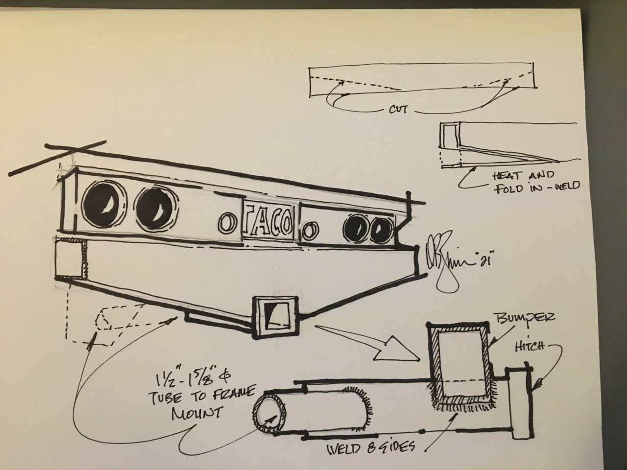

    Give me a hour or so and I'll sketch it up. Not done this before here but we'll blow the place up..LOL

    So far connecting it to the truck frame is easy, its mostly just a flat plate bolted to the frame. At the other end, its either a butt weld to the bumper, or a reinforcement welded intside the bumper that its then bolted to, or there's a bend in the plate and then thats bolted to the bumper. Butt weld seems like the worst plan.
    Maybe I should draw pictures.

    stand by....

    Damn, wanted you to be a millionaire. LOL. Thank you for bringing this to the front. I've been grinding for decades and never seen this and I consider myself up on lots of things. Old age sucks...Ahahahahahahaha.

    You didn't say you were going to create a work of art! Thats fantastic! :fistbump:
    I like the idea of the tube to the frame. Hummmmm. I need to go stare at it outside and see where that would all line up.
    Thank you so much!
