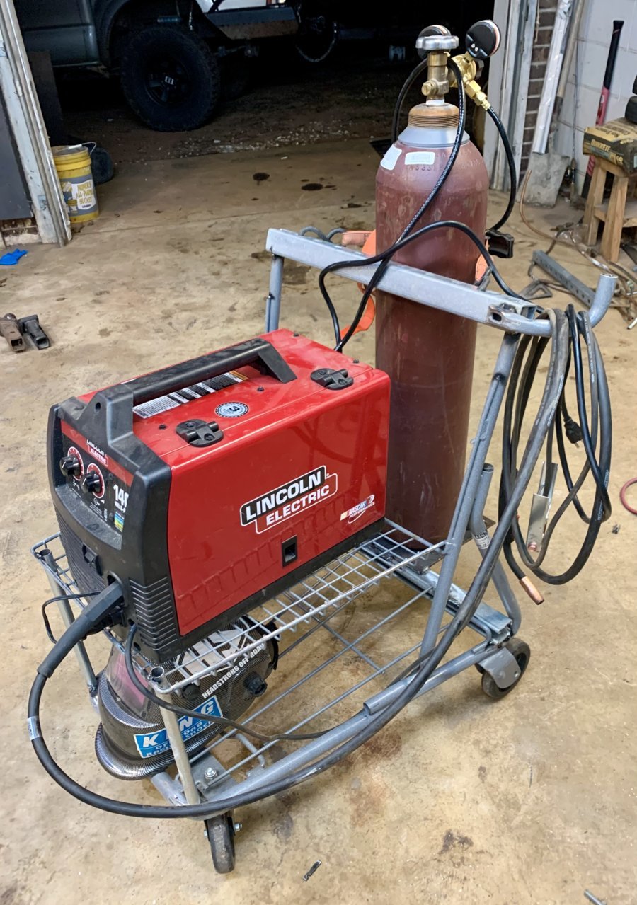

    Dayman Karate
    Dayman Karate Well-Known Member
    Dec 18, 2017
    #238838
    4,720
    Clay
    Central Alabama
    JKU Rubicon
    https://www.tacomaworld.com/threads/daymans-karate-class-but-you-wont-learn-nothin-4-link-lt-and-previous-iterations.755134/
    I would like to give a shout out to Walgreens and the homeless person who provided this buggy for me to turn into a ghetto ass welding cart.
    A8FCD826-3727-4BD6-9A69-C7C8FBD710A6.jpg AA827F10-93A0-4EA5-948D-4D4EEEF3314E.jpg
