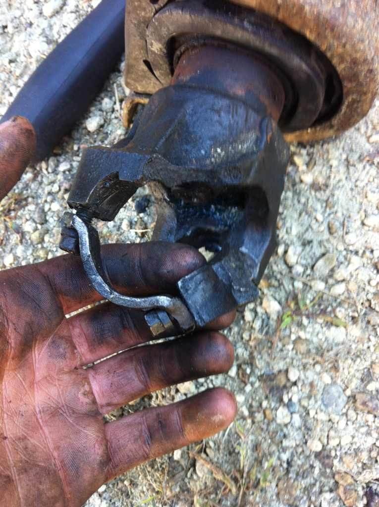

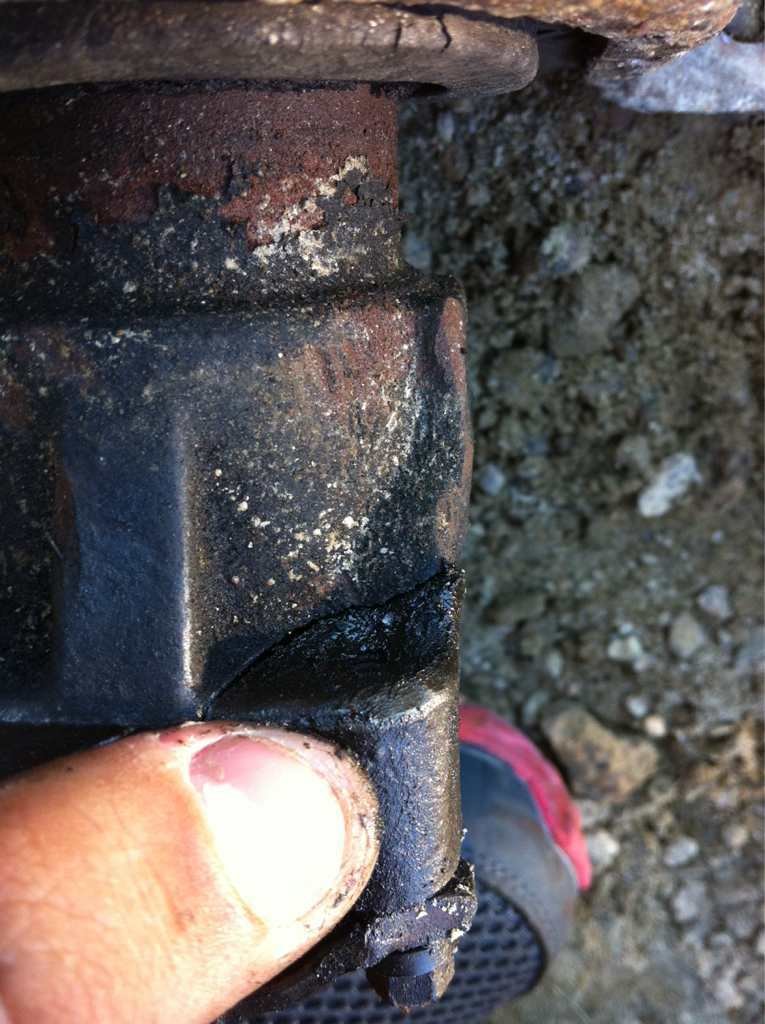

    Going to attempt this later what do you think?

    With the amount of work it takes to remove the Yoke I would just replace it. You will need to remove it anyway to pre heat it to 400 degrees anyway so just get a new one.

    It's on my trail truck, not that worried about it. Gonna heat it like it is then tack put joint in and go too town. It's just for moving the truck around right now. No way would I run the 408ci with this little shaft, thats how this happened

    What I think he's trying to tell you is that without pre-heat, you'll end up with lots of weld and little penetration.

    if your not familiar with cast welding, don't expect it to even make it up the driveway. as stated you need to pre-heat at least to prevent most cracks. I think post-heat is a major plus too.
    I only tried it once and was told to use Ni rod. lots of nickel in it. I did not pre or post heat and I could hear cracks happening as I welded. the welds themselves still hold, but they are just holding old brake rotors to 4x4 tube for an ash tray. . . . .beyond redneck, but I still think they look cool
