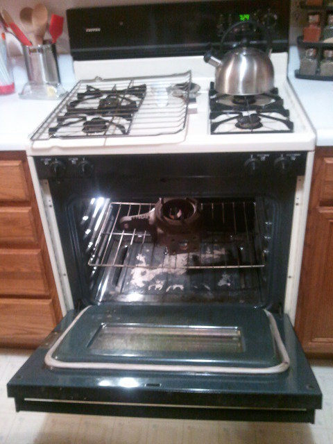

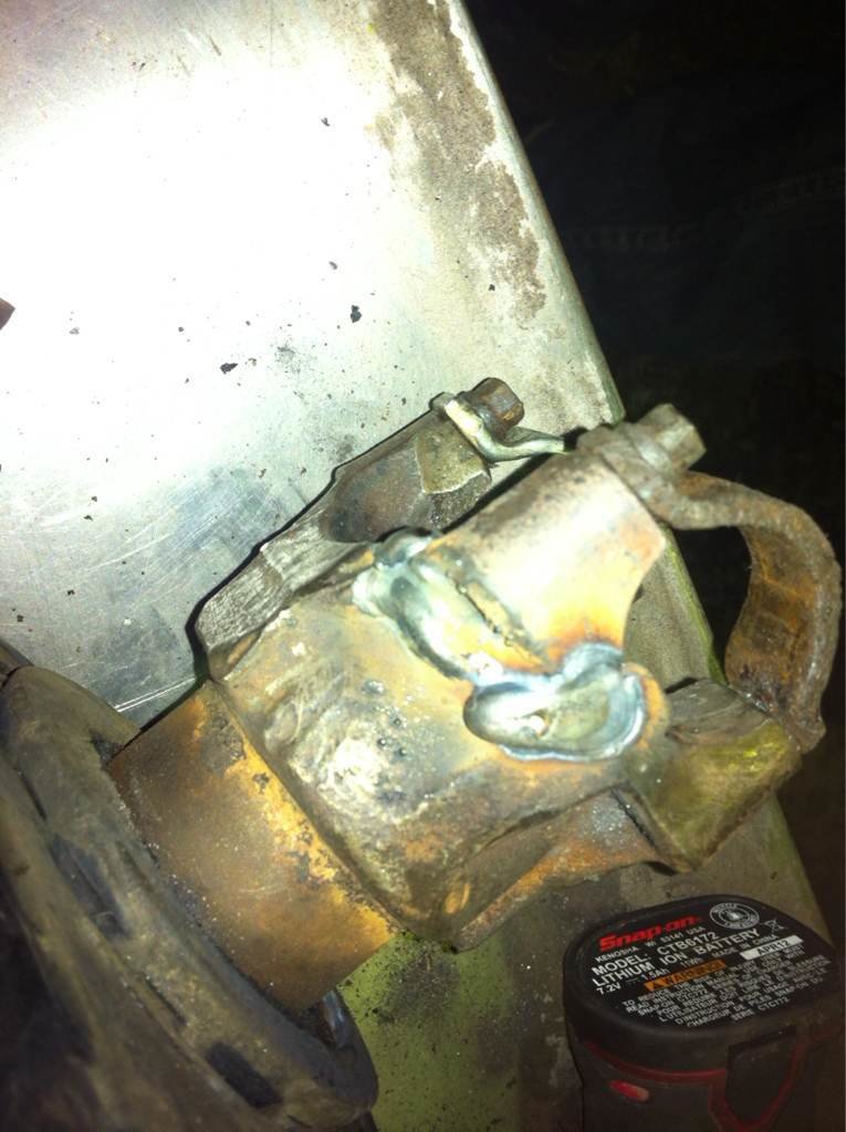

    This ^ when I weld cast the parts are preheated to around 400 degrees In my powder coat curing oven welded and stuck right back in the 400 degree oven for about 10 to 15 min then we turn it off and crack the door to let it cool SLOW! I haven't had any issues with this method and i weld a lot of cast pipe fittings and other things for the oil guys next door.

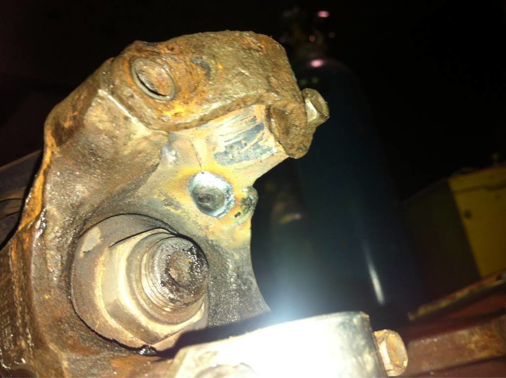

    Heated till hot. Welded hot. And used the oven method used above.

    Screw pretty, if it holds it holds! I mighta sprung for a scrap yard replacement considering 1. It already grenaded on you, and 2. If I read correctly in the other thread you're putting more than the designed HP and TQ through it.

    Couldn't find one. But yea it's slightly torquey.

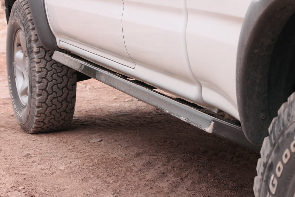

    I think best bet is to avoid anything on your trip that you may need sliders for. Wait and do it right. Thrown together bolt on sliders are probably not the best idea, especially if you're drilling a bunch of new holes in the frame. That could easily turn into a weekend project.

    No need for 1/4" unless your truck is a competition buggy. Mine are .120" wall and I've hit mine pretty hard and used a hi-lift on mine a bunch of times without issue.

    Wouldn't be a biggie on the rocks. You're not dragging horizontally over the corners or anything and if you're hitting the front and back corners you're probably doin it wrong. Square tube is stronger too. It's really about look preference

    Be careful with this statement.
    Square tube is not stronger in all cases. It is stronger in bending when flat top and bottom, due to the increased material located away from the neutral axis.
    When placed in bending with corners top and bottom it is not stronger.
    Also the dent or crush resistance of square tube is much lower than round tubing as well.
    But yeah, mainly a matter of preference.

    I have dents in my 1.75'' x .120'' wall DOM sliders. i can't imagine what equall thickness box would look like at this point. box does slide realy nicely along things though, due to thetypically lower pressures at the contact point.

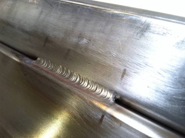

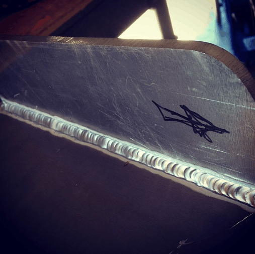

    My welds are actually improving a lot. :eek: I think the biggest improvement came when I did practice runs for each bead, just to check and make sure my elbow wouldn't hit anything and I had a decent grip. Both of which contributed a lot to the shitty welds I had before.

    I always do this, make sure nothing gets hooked when trying to move, space, grip, etc. So many times I find I am stepping on the leads or something stupid too
