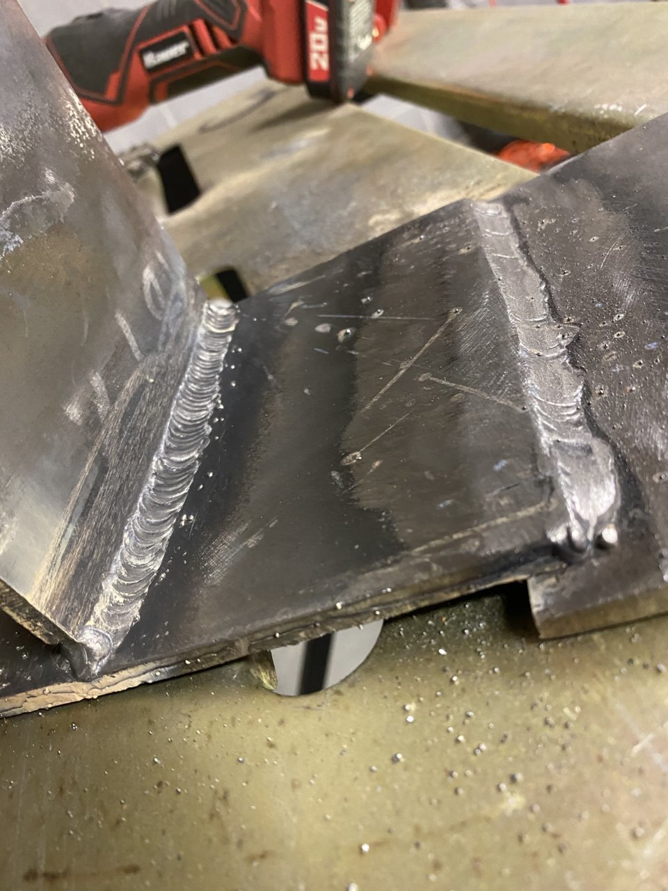

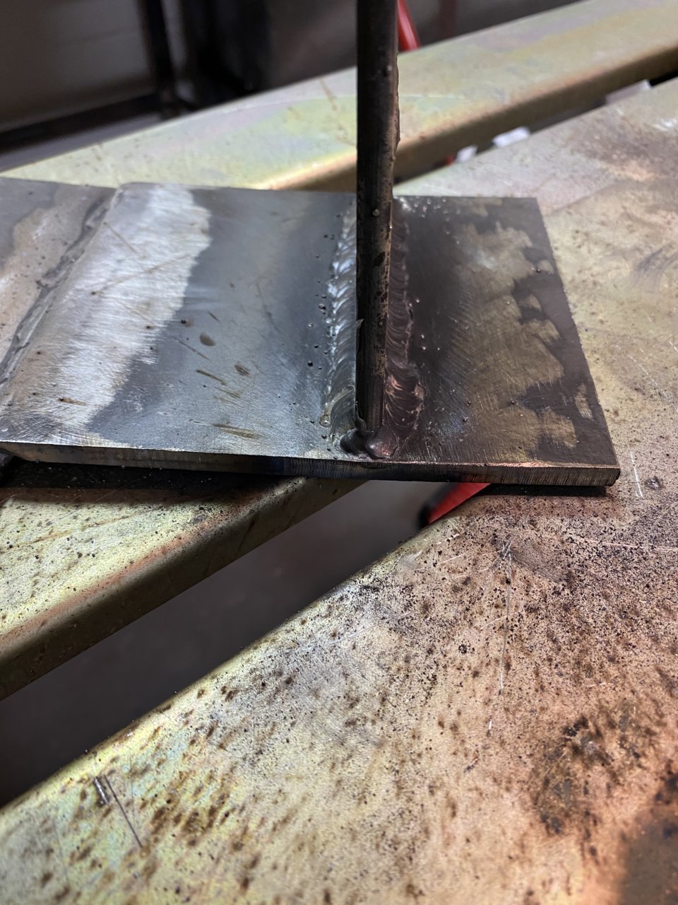

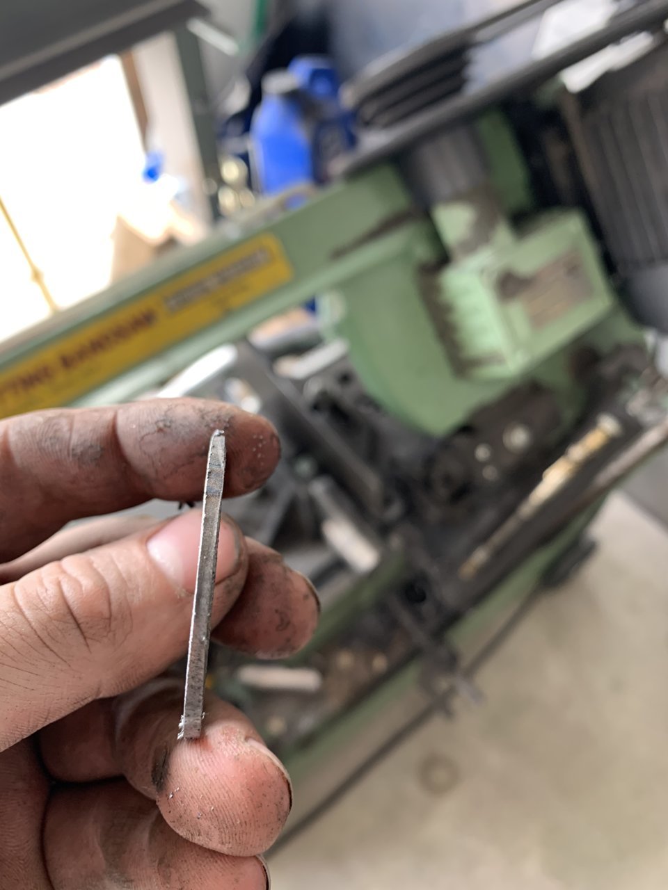

  13. Feb 13, 2021 at 12:18 AM
    malburg114
    malburg114 Well-Known Member
    Dec 26, 2012
    #93766
    3,820
    Las Vegas, NV
    2001 Toyota Tacoma TRD
    For those hesitant on a bandsaw vs chop saw, this is on my 10+ year old harbor freight band saw that’s had a bunch of heavy use. With a decent blade they cut really well. This was a clean up cut from a not so straight looking cut originally. If I slowed the speed on the Ram down more I have no doubt it could cut thinner.
    and a welding a picture
  14. Feb 13, 2021 at 4:29 AM
    2008taco
    2008taco Well-Known Member
    Mar 4, 2011
    #52323
    2,831
    chris
    san diego
    I rocked a HF bandsaw for almost 2 decades. It's slow, but fairly reliable. Throw a quality blade in it and it will go pretty much forever. Chop saws are faster, but they will cost you more than the bandsaw in blades. A good bandsaw with a coolant system will almost match the chop saw in speed. And the holy grail is a cold cut saw. Fast as a chop saw with the longevity of a bandsaw, and you can even get them sharpened.

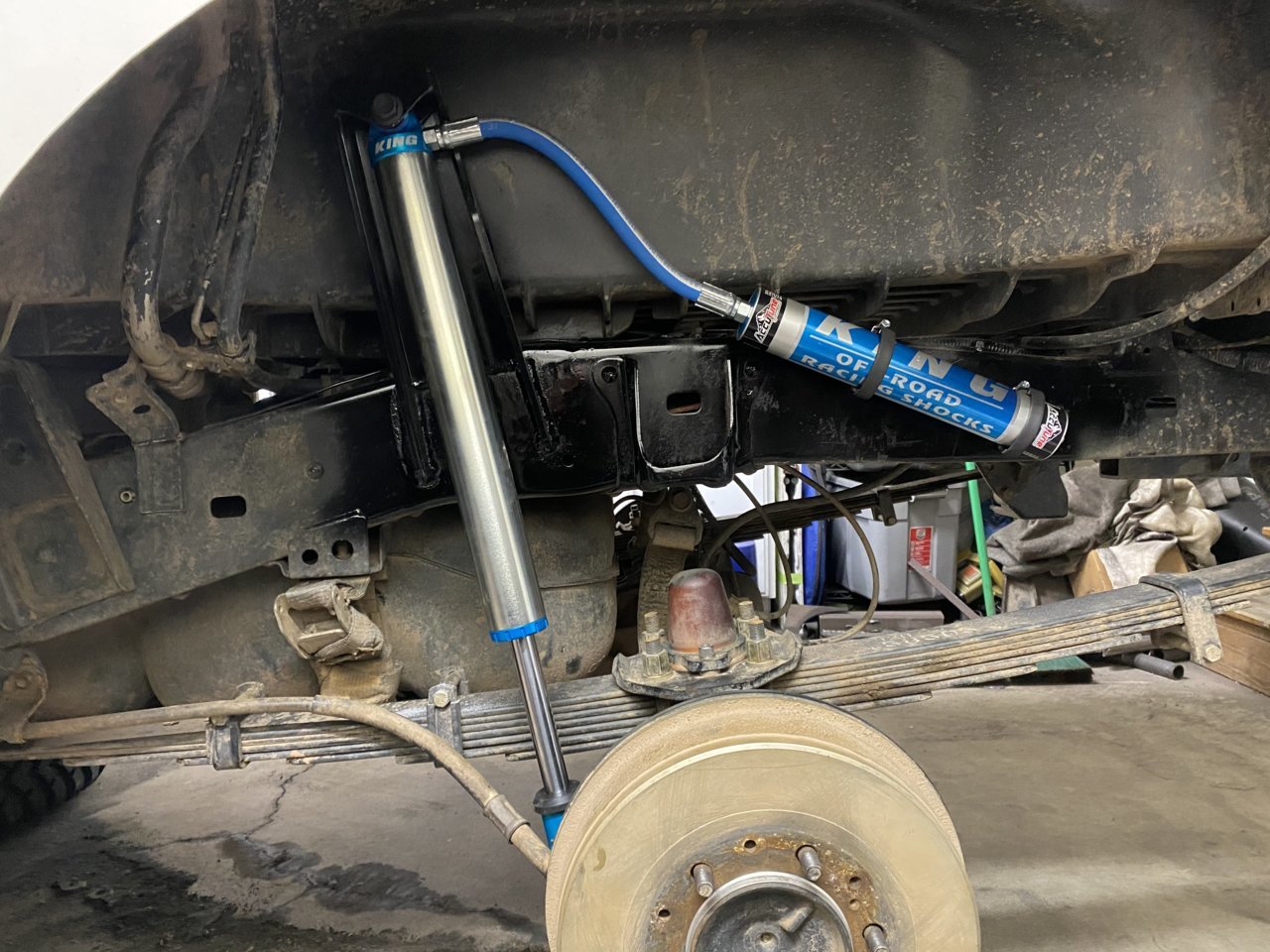

  18. Feb 13, 2021 at 4:28 PM
    EatSleepTacos
    Mar 24, 2015
    #151688
    59,846
    Randy
    West Valley, AZ
    2017 4Runner
    Lower shock mount
    Vmax88 likes this.

  20. Feb 13, 2021 at 4:33 PM
    EatSleepTacos
    Mar 24, 2015
    #151688
    59,846
    Randy
    West Valley, AZ
    2017 4Runner
    I wasn’t sure if that’s the answer you were looking for since I thought it was obvious :anonymous: I put a new relocate on to move both mounts up and gain ground clearance at the lower mount.
