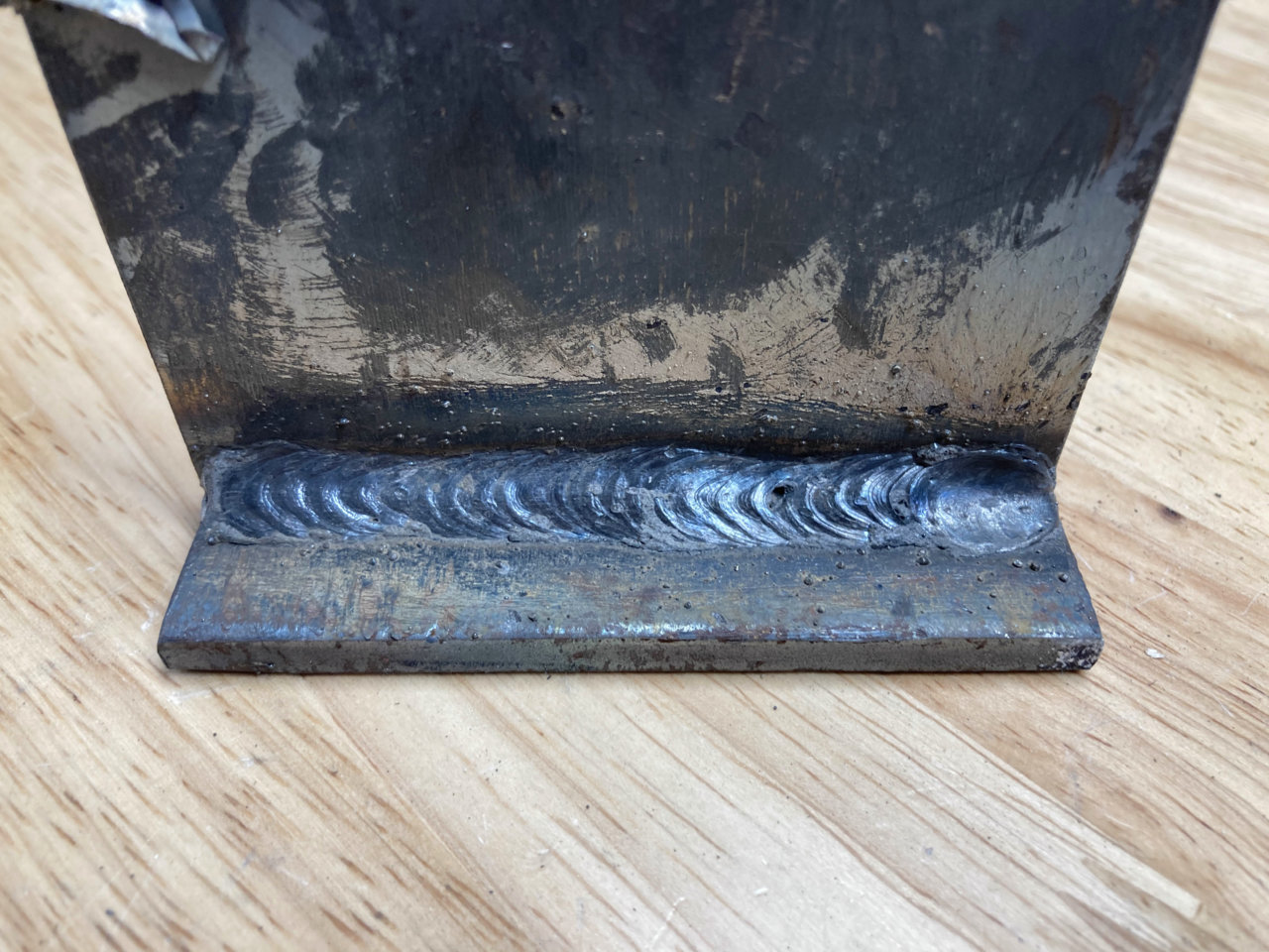

    Beautiful work. Looking at these welds tells me you're really happy to be doing this and proud of your work. This is what we need in America. Respect for the trades, and Pride of our work.

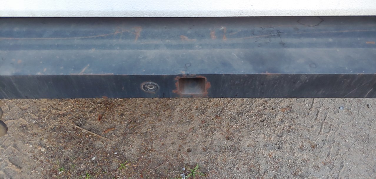

    Speaking of bumpers.
    Cut out the recess for the license plate

    Looking good. Will you be putting in a hitch?
    Edit: Would you mind posting some pics from behind the bumper? I'm curious to see how everything is connected.

    I’ll probably add a hitch behind the license late. I’m building the bumper to be low profile so it only protrudes past the tailgate about 2 inches. That doesn’t leave a lot of room for the receiver tube to be reinforced for towing. Good new is that I don’t tow anything but I use a hitch mounted spare tire carrier so it’ll be strong enough for that. I’ll have to rebuild the tire carrier as well to compensate for the higher location of the new receiver.
