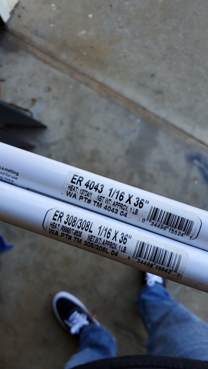

    First day of tig welding aluminum and stainless was a huge fail lol not even gonna post pictures. I'm practicing on thin stuff (1/16) for both because I'll mainly be doing exhaust and intercooler piping for my build. Any tips?

    Everyone has opinions. I’ve seen very experienced welders give some really bad advice. Practice and find what works for you. I’ve been in the field for +two decades and what works for me doesn’t always work for the next guy.
    For SS keep your amps as low as possible once you have a puddle. If you dwell too long or use too much amperage you’ll overheat the base metal causing what some guys call “sugar”. Looks like black sand. It’s “technical name” is chromium carbide precipitation.
    This means you’ve dissolved the chromium (where most of the corrosion resistance comes from) out of solution and causes it to bond with carbon. This greatly reduces corrosion resistance along the grain boundaries.
    This is why you see some SS exhausts with slightly rusty welds. Usually means the guy overheated the weld.
    So with SS as soon as you see your puddle wet out get moving.
    As for aluminum it absorbs your heat quickly so hit it with the amps and get it wetting out ASAP. Add filler and get moving.
    As for filler metal a good starting point is using a filler rod close in diameter as the base metal thickness. For example if you’re welding 1/16 then try to use a 1/16” diameter filler rod.
    Don’t get frustrated it takes most welders lots of practice. A lucky few catch on naturally and some really never get it.
    If you have any questions at all feel free to ask.

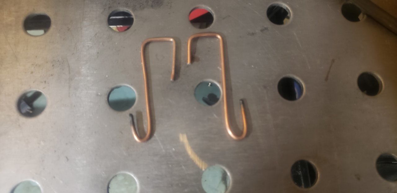

    Earlier today while out on the shop trying to get motivated to clean up a bit. I had idea to help keep a couple of the wrenches.for the die grinder and the angle grinders handy.
    Took a couple short pieces of filler rod and bent them into a S shape with one end being squares off to fit in one of the unusable holes(due to the leg bolts) in the table.

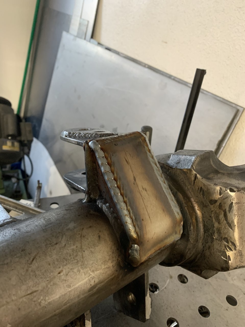

    Huge thanks for this you pretty much described the issues I was having with ss. I was blowing through the aluminum and I was using too thick a filler. Going back to the weld supply tomorrow to pick up 1/16 filler. I accidentally grabbed 3/32 filler and didn't realize it till I started welding and it would stick in the puddle. I'll try some more tomorrow. Thanks again man.

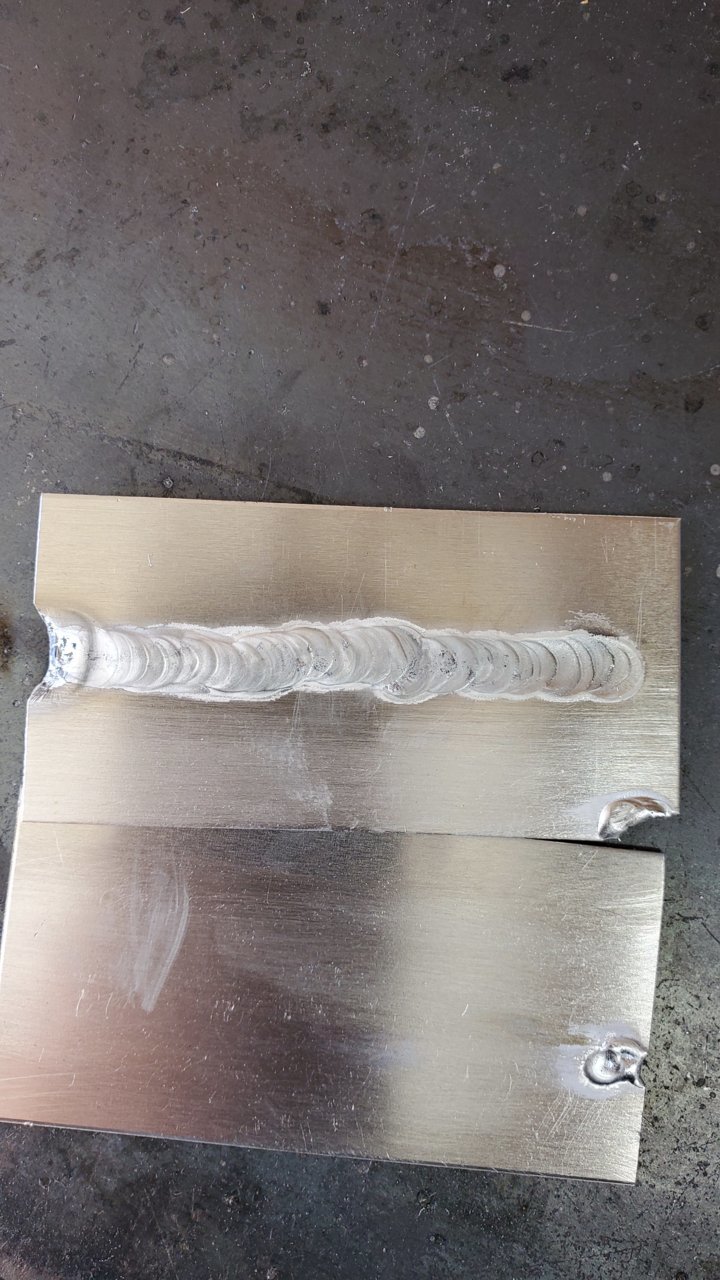

    Lol ill give you one on aluminum that I just ran flat not welding anything together haha. You can see my failed tack weld and blow through hahaha

    You did remember to switch polarity and tungsten depending what flavor you were using.
    Sometimes it is the simple things.
    If your doing butt welds in thin material using a copper back strip makes it much easier .
    Thicker material is some what easier till you get your muscle memory .
    2008taco likes this.

    Once you get more practiced you’ll likely be able to use that 3/32 or maybe even 1/8 “ on 1/16 base metal but til you get the hang of it a bit better stick with that 1:1 rule (filler rod diameter to base metal)
