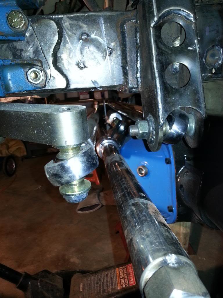

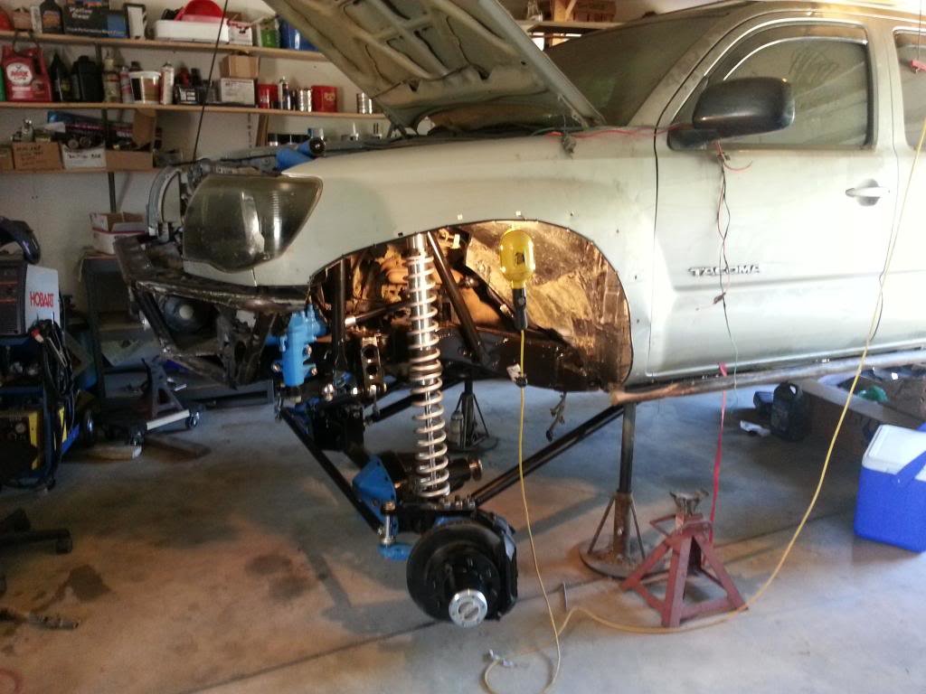

    Been working on this lately:
    Lots of welding here. :eek:

    not seeing any warping in the last pics. You need some tools to blend yo welds.

    How thick is the plate?

    1/4" will still warp if over heated as well so just watch out for that.

    Try cutting those sides with an angle grinder to avoid warping.

    You could also use some agle or channel with a slight bend in it, and weld it to the inside. A lot of the armor plate I used to weld had to have "bars" installed to keep everything straight and square. Used lots of gussets too, but removed them after material was cool. 1/4"- 3/4" steel armor, & 1/2"-2" aluminum armor. All done with tig and spray arc. Shit would bow like CRAZY without the gussets and reinforcement bars

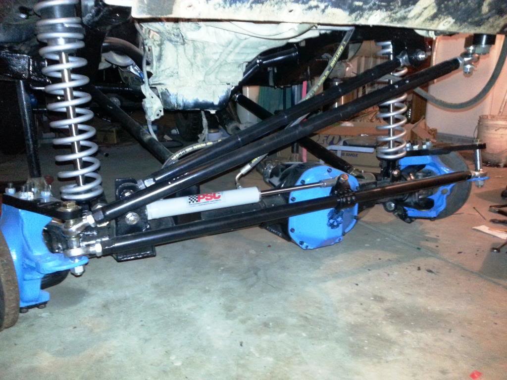

    Its a 1979 Ford KingPin Dana 60-upgraded with:
    -35 spline Cromo Yukon Shafts
    -Spartan locker
    -Ballistic diff cover
    -Longfield Spindle Bearing eliminator bushings
    -Chassis Unlimited High Steer arms (custom double shear)
    -Yukon Hardcore Locking Hubs :D
    Leaf Sprung doesn't articulate as much, and generally speaking you end up with a high ride height.
    Links I can stay low, lots of travel, and no axle wrap. :cool:
    I do have files to make replicas of my frame end brackets, which is really the hardest part of the second gen SAS since the frames aren't straight, if anyone is interested in a set down the road, shoot me a PM.
