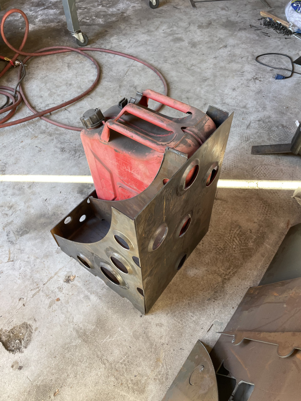

    As many as I can fabricate

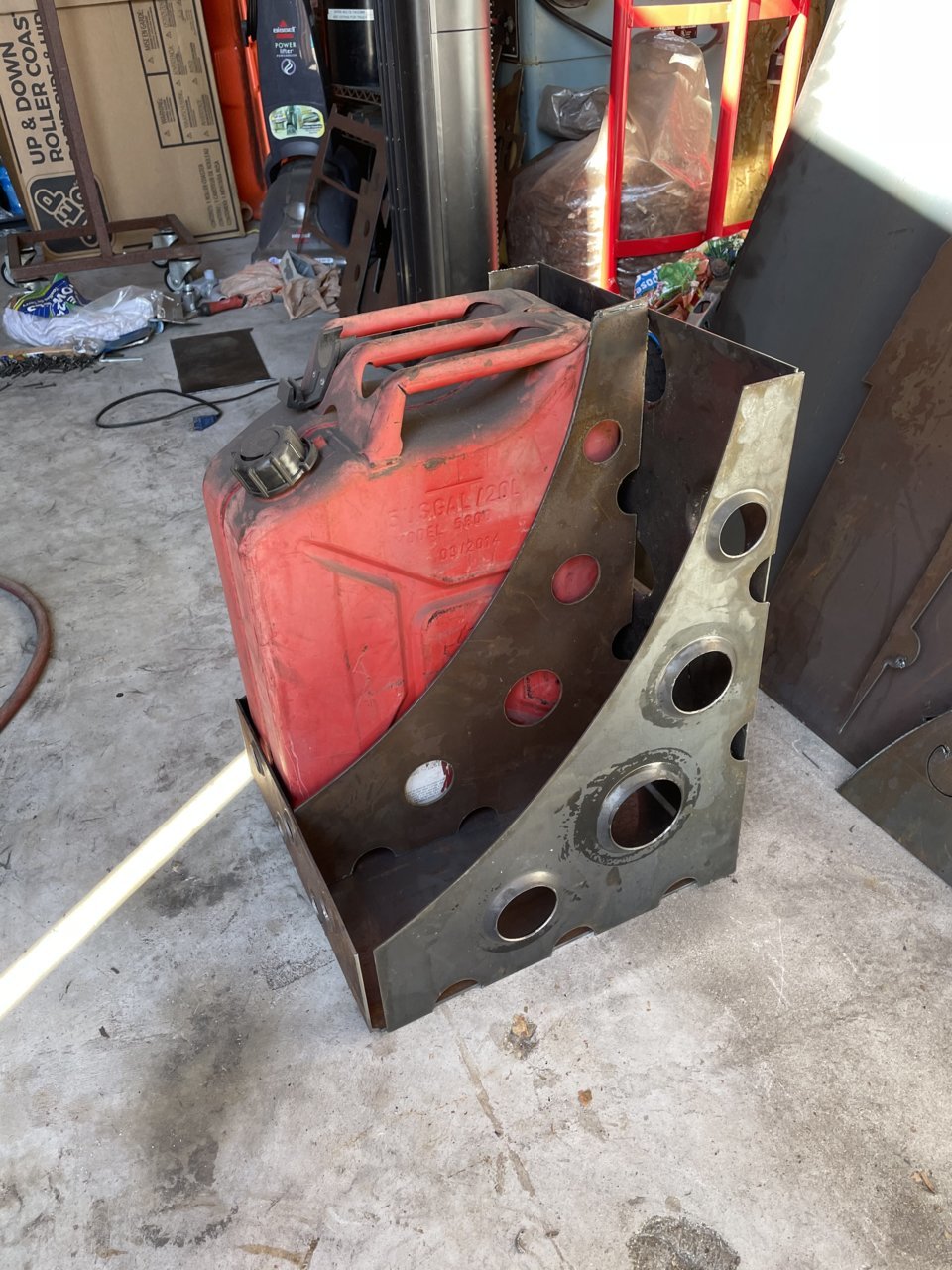

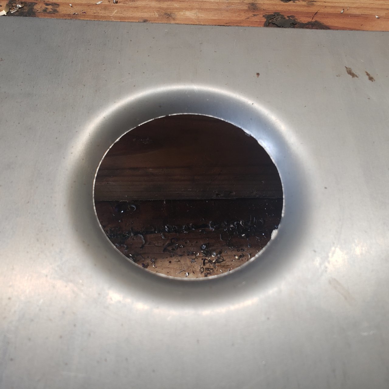

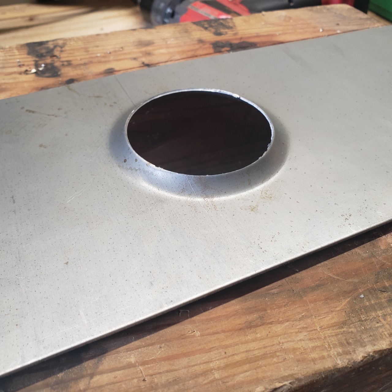

    Looks good. Did you have the dimple die kit? Those seem to be expensive.
    Zim
    Shmellmopwho[QUOTED] likes this.

    Thanks man. Yeah I got a set a while back
    1/2”
    1”
    1.5”
    2
    2.5”
    they aren’t cheap but they paid for themselves very quickly

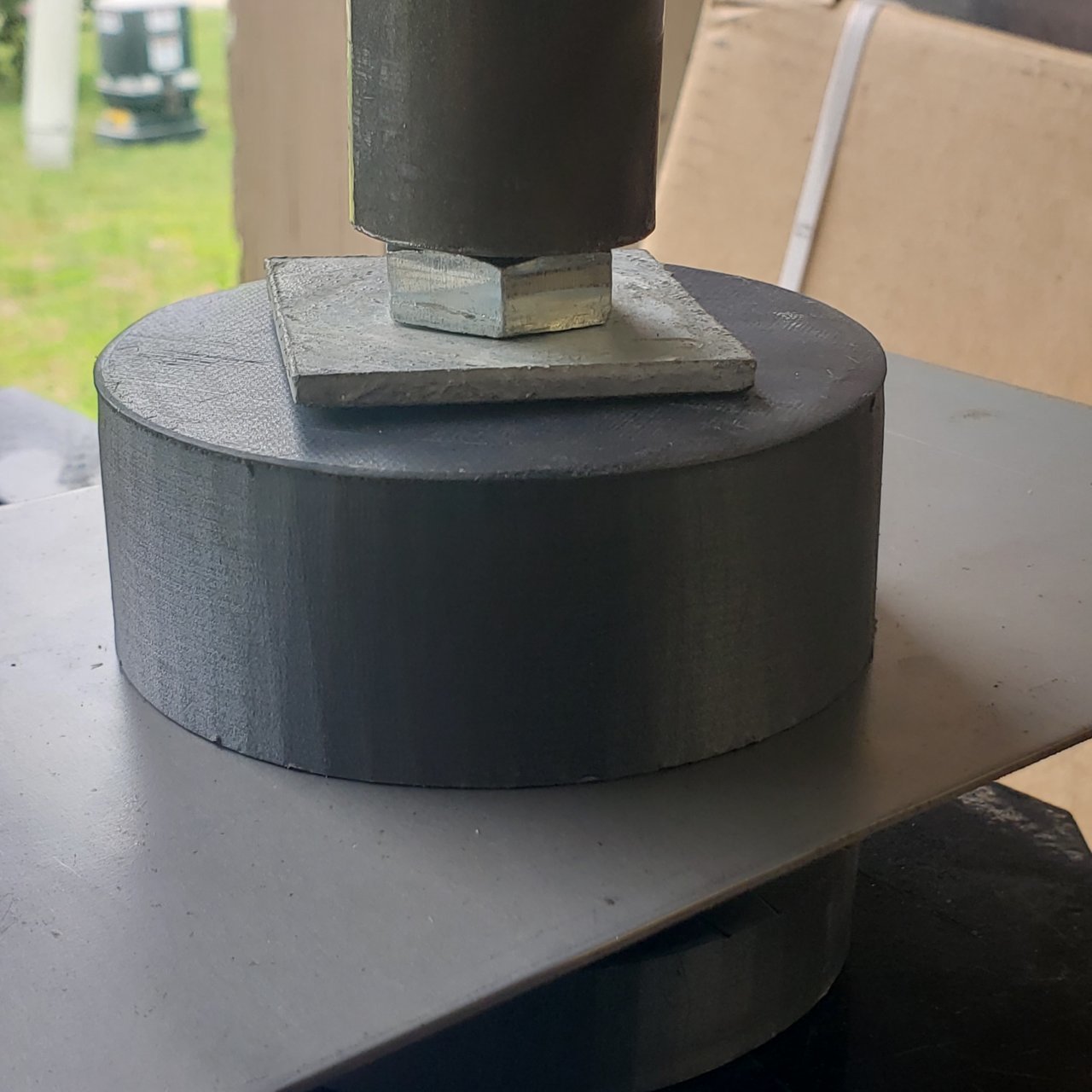

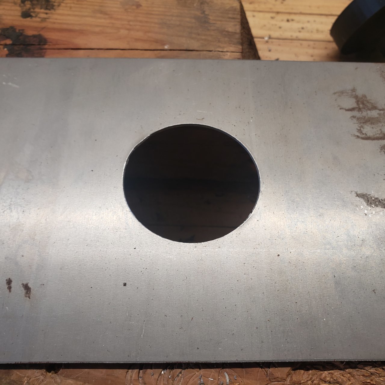

    could always 3d print one out of carbon fiber nylon... works pretty good on 16g mild steel
    the 3/4" bolt is to keep the two halves aligned, and I figured since I had the big square washer it would not hurt to put in on as well

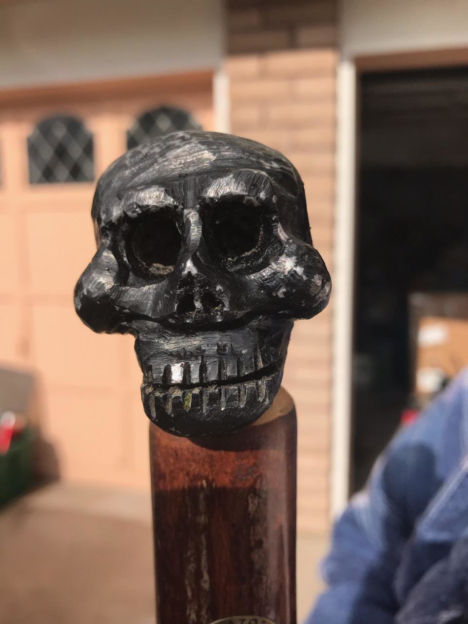

    A cane topper I made with some spare time and the welder at workIMG950379 (1) (1) (1).jpg
