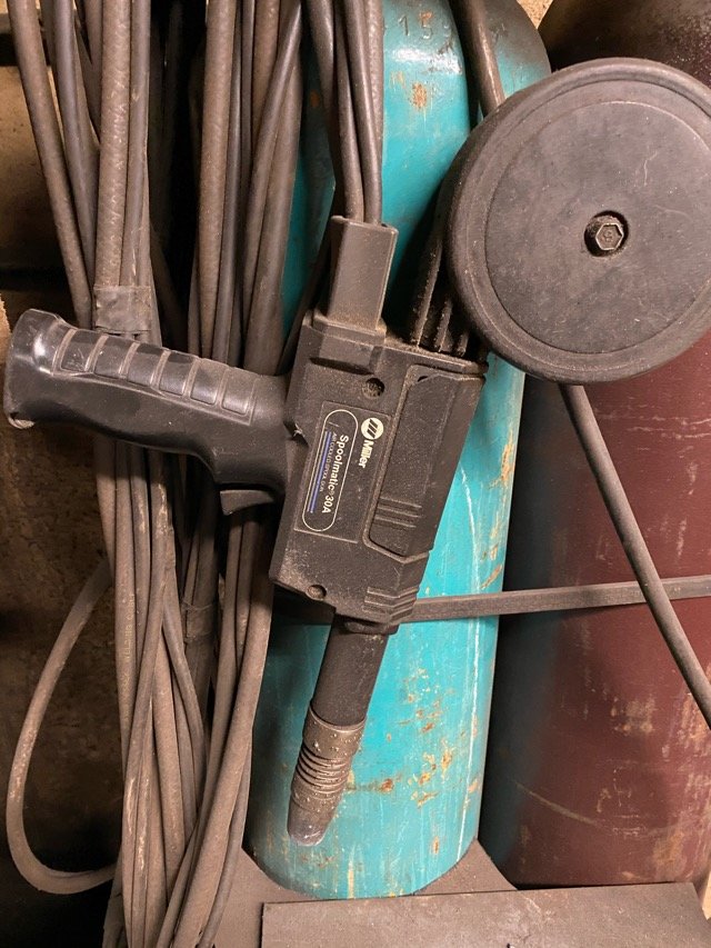

    We have a Miller spoolgun here at work, while it does work the burn back can sometimes be frustrating with aluminum wire in it.

    I have the Miller 30A spool gun. I honestly am not impressed with the build quality and feel. I never thought it was worth the $1k or so I gave for it.
    I would think those guns listed above would be fine. Technology has improved in 20 years.
