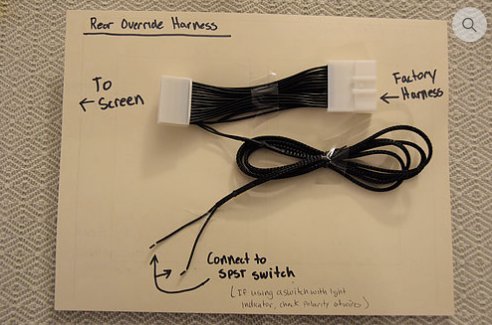

    Any body try these Anytime Back up Camera kits?
    $35 for a plug and play seems like a pretty good deal to me. Been wanting to add a switch to my backup camera for a long time.

    I recently bought the Front and Rear version. Easy install (except for running wires. I hate running wires) but it works great and worked properly the first time I tried it. I do have to install a better front camera. I one I bought was an El Cheapo eBay special and the video is reversed. I have one on order that is switchable for front or rear use.
    Here's my video:
    https://www.youtube.com/watch?v=tDWXk2OocQs

    Strange that the the site claims "Made for the following Models: Most 2009+ Toyota vehicles" but drop-down menus list only 2014 and newer Tacomas. o_O

    I just ordered the full $100 kit and figured Id try to coupon codes to see if anything stuck, TW10 worked to get 10% off! Ordered last night and it shipped already this morning.

    I'm pretty sure the video screen is integrated into the rear view mirror through the '13 MY. (It is in my 2013, anyway.)
