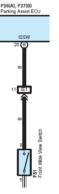

    Hey guys, I'm hoping someone here can help me figure this out. When I first installed the Anytime Backup Camera harness (and the upgraded front camera) on my 2020 TRD OR, it would only display the front camera (when the switch was selected to the front) and give me a blank screen when I selected the rear camera or shifted into reverse (stock rear camera).
    I emailed the company, and they asked what happens when I switched the RCA jacks. It then made it so the reverse camera would display, but not the front one. I emailed that answer back and haven't been able to get any more answers (or even acknowledgement that I emailed).
    So I did some troubleshooting on my own. I'd heard some folks talk about hearing the relay click, so I thought maybe I got a bad relay. Ordered new ones (and waited 2 weeks for them to come in...), but no change. I thought maybe it was a bad ground, so I extended the ground from the switch and grounded it with the relay harness on the radio mount. I'm assuming that's a good spot, as the instructions show grounding it there.
    edit to add: After moving the grounds together, now the front camera is the only one that works. Even when I swap the RCA plugs, the back camera no longer works!

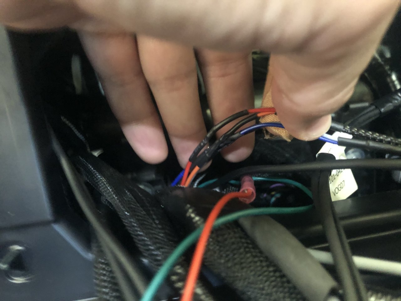

    I looked over the connectors, and don't see or feel a loose or bent pin. I soldered and shrink-wrapped the connections, so I'm assuming they're good. I'll attach some pics below.
    Thanks for any ideas you've got!

    Make sure nothing came depinned in radio harness.
    Taco_mike73 likes this.

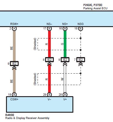

    The cameras are always ON after IGN. The Parking Assist ECU receives the input to send rear, front or panoramic feed to the Head Unit.
    Since there's a switch select for the front view only:
    My guess is the added harness has an issue. Or maybe this does not pertain to your OR.

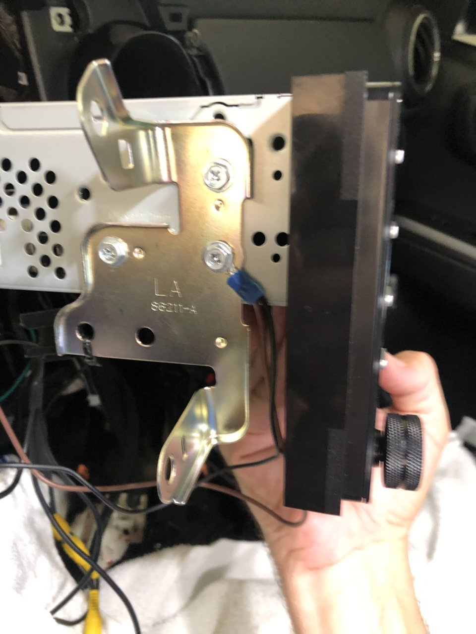

    I had an issue with this about a year ago. It turned out I had the wrong 24(?) pin connector from the back of the head unit. I had watched a bunch of videos related to the install but they were for previous model years. I found a pic on the anytime sight that showed the correct harness connection. Let me see if I can find it again.

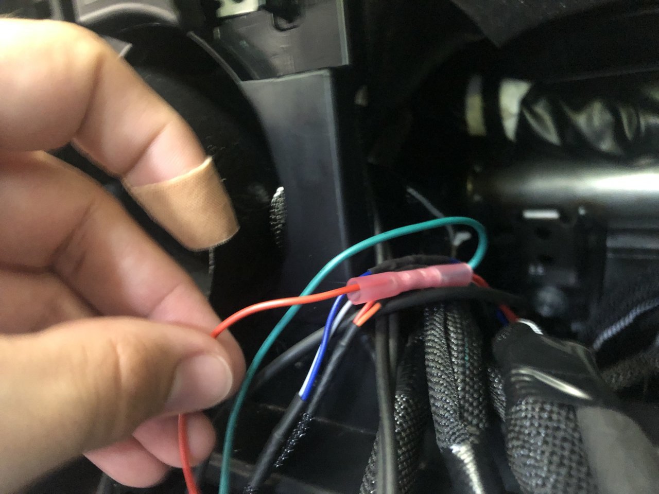

    I had tremendous trouble with connecting all the little wires together. Especially the orange one off the front camera and to ground wire with it. I had to use these heat shrink tubing things with solder in them to get good connection with all the wires you have to splice. I tried in my first attempt to use crimp connectors to splice the wires together but the small thin ones on the camera wire(orange and black) kept pulling apart on me. My first attempt was a total fail other than getting the camera in the grille and the wire through the fire wall.
    I did eventually get mine installed and working but it was the hardest, most frustrating mod I think I've done so far.

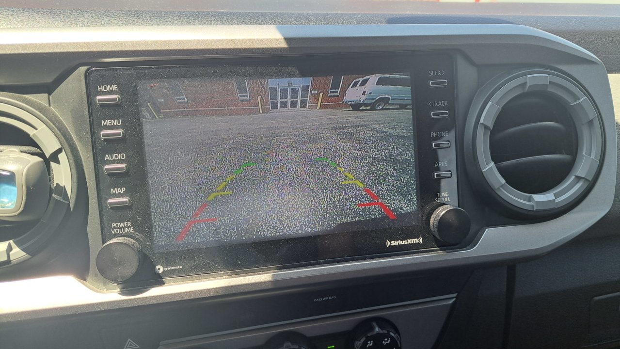

    I have the standard front camera this is how mine looks. I could've cut the wire to remove the lines but didn't 20220811_133459.jpg
