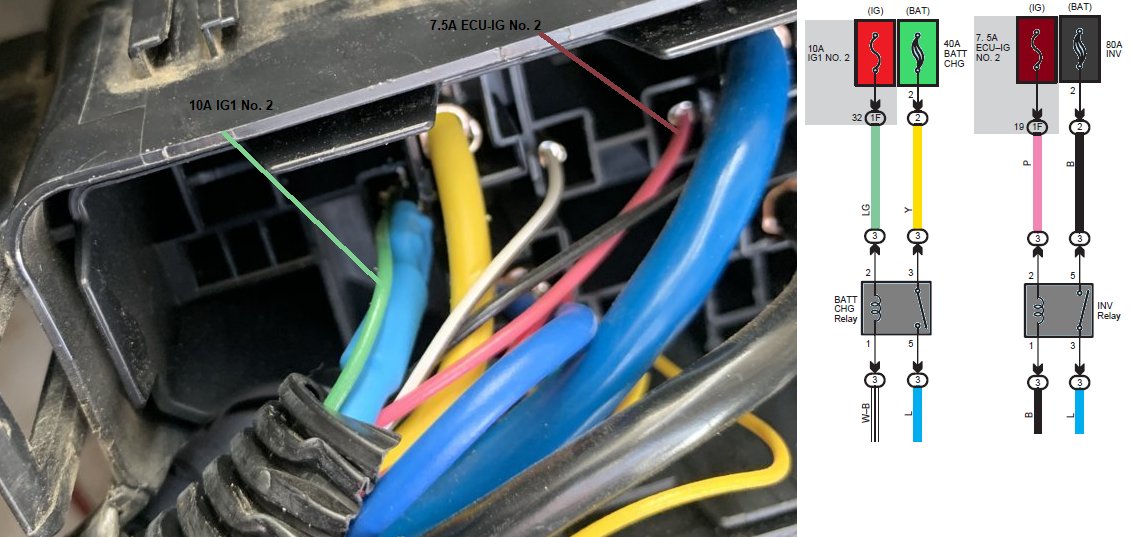

    Hey guys,
    I'm in the middle of installing the Anytime backup camera front camera kit. The front camera has surround LED lights. I have it all worked in but do not know how to connect the front camera in to the fusebox... if I do connect the camera in to the fuse box, it ends ups with the front camera's LED always on even with the truck turned off. I only want the lights on when the camera is switched on. (I had to use a different RCA cable because the pin on mine broke pushing through the rubber grommet.)
    I'll kill the LED camera lights or battery eventually if always "on".
    How have you connected the system in?

    Two choices to tap into for IGN ON in the side relay box, from underneath.

    Perfect! That works. Thanks!
