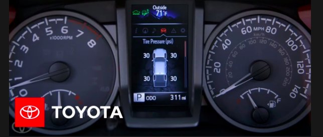

    I thought long and hard about this and decided I'd rather have the switch in the middle of the dash where it's easy access. I'm afraid the steering wheel controls will be in the wrong setting, and I'd have to start pressing buttons to find it, whereas with the button visible on the dash.
    Myself I have my steering buttons set for the 4 tire psi setting.

    The buttons you press - MODE, CH up, and CH down on the left hand side of the steering wheel are the only buttons used. The buttons to change those screens your talking about use the directional pad and return button on the right hand side of the steering wheel.
