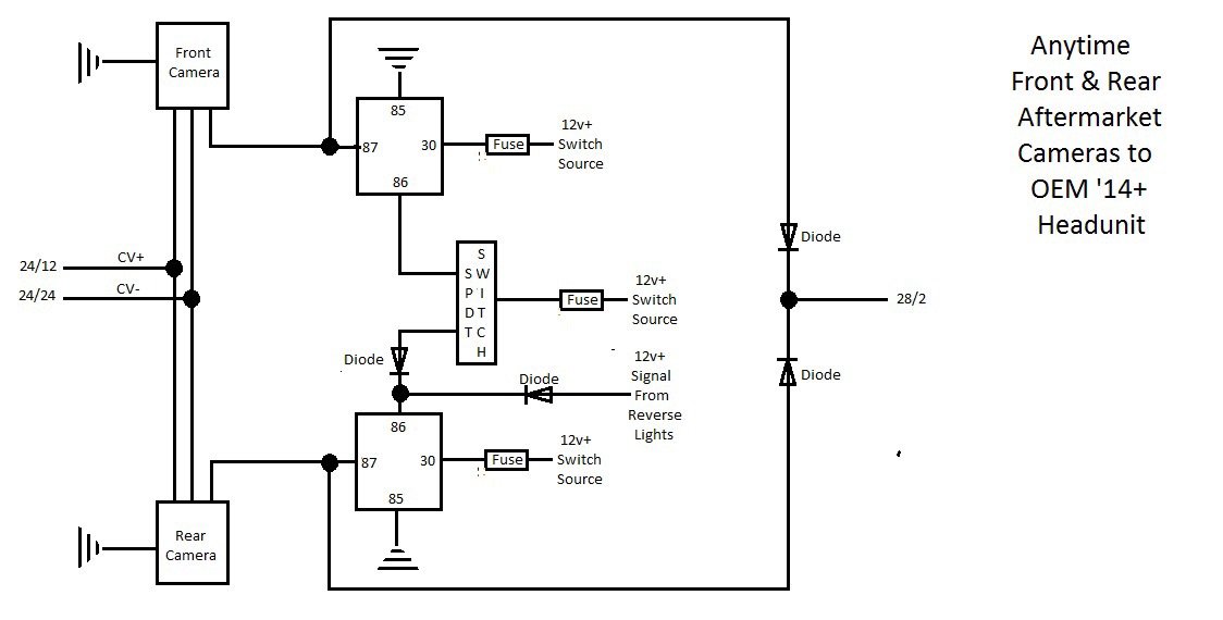

    When it first came out I have installed the the anytime camera that requires the two switches one for the front camera and one for the back camera. Know I want to change to the single switch that toggles between front and rear camera. Is it possible? If so how do I go by wiring it. Or do I need to buy the new version. Thanks

    Welcome to the forum. You can do it easily with a small relay. See attached schematic.
