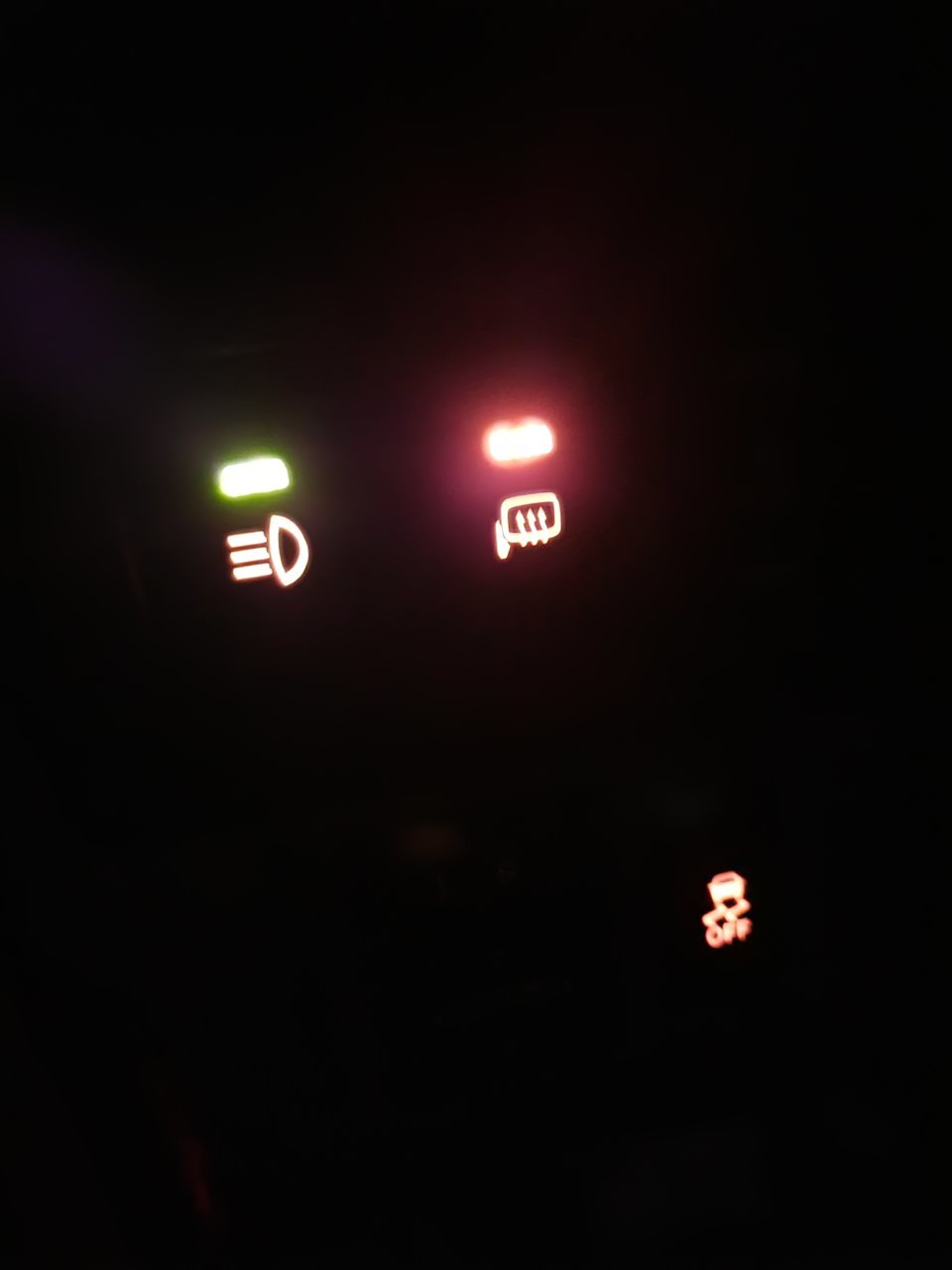

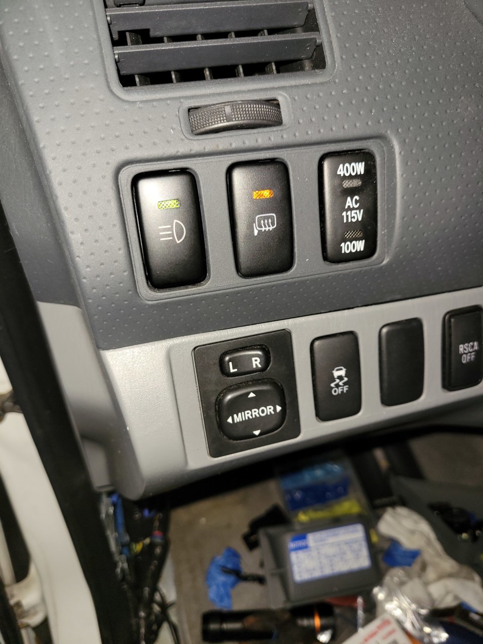

    Today I did the anytime fog light mod using the FJ switch. I also installed heated mirrors. Remote starter will be next.

    The anytime fog lights is a common mod on here. Requires one wire for the most part and takes all of 5 minutes. The FJ switch is more complicated. It requires installing a relay in addition to the switch. The factory switch uses a negative trigger to turn on the fog lights. The FJ switch uses a positive trigger. You wire the positive from the FJ switch to a relay that then sends negative to the factory relay to turn on the fogs. The switch and wire harness for the switch was about $100 on Amazon. There are wiring instructions I found using Google.
