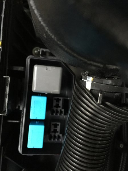

    Hi Everyone,
    I'm hoping someone can tell me specifically what this AC relay controls. I did the anytime mod where you connect the power to the AC relay. Worked well for a couple of months. Recently my fogs would not come on. I unplugged everything and returned it to stock. Fogs worked as designed. So I am thinking that somehow there is no power going to that relay anymore. My AC seems to be working fine. There one time where it wasn't blowing any cold air but it seems to be working fine now. I was hoping someone could tell me what specifically the gray AC relay controls (see pic) so that I can have Toyota look to see if something is shorted.
    Thanks in advance,
    Alvin

    It's the relay to the Inverter
