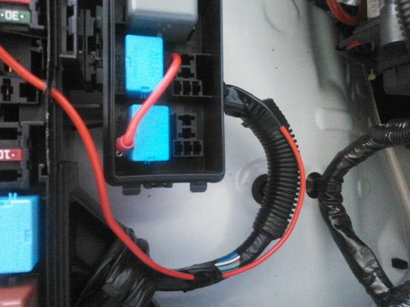

    I ended up just splicing mine . I could not get it to fit snug . 2764f2f98fa40ad4eb300330097d18f5_79fa19e1e7d0ccff3e25d845008f7a4d6470cbac.jpge7c9ab3f750088603c32af3d0cac1ad1_1a5f8e5876375b9345079b2c19ba90dbd8bd3d4e.jpgfae026829a345ad063954d5bb3340aa2_18a3e649df9ce8083711f8635831d15a647106f7.jpg

    What all did you splice? Could you do a close of of where the wire from the ac relay went to?

    I spliced into the green wire .. I taped it up but you can see in the second to last photo the blue square with black electrical tape on it..

    Oh sweet okay!

    this is exactly how i rigged mine as well, I used really small gauge wire i think 20 gauge and just put on a female spade terminal on it and connected it to the bent terminal of the relay. I didnt cut anything from the fuse bux as i got it to fit without having to do that. On the main fuse area, I just twisted the end and plugged it right into the terminal port, no splicing for me. Havent had any issues with it falling out yet as the lid keeps it pretty snug.

    You just stuffed it next to the green/ white wire?

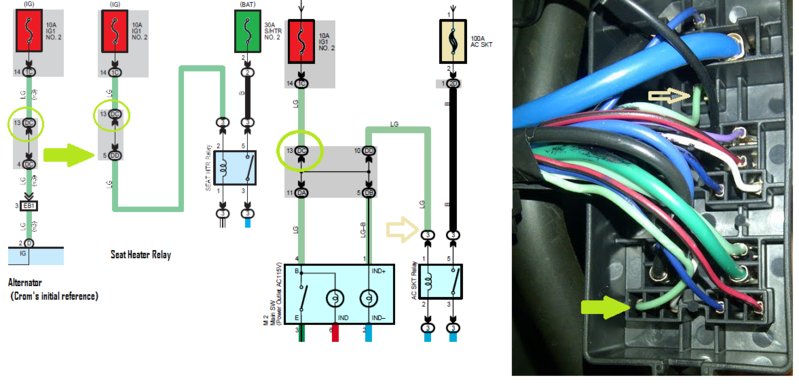

    Thread intrusion Crom. :poking:
    Trying to clear the round about way for all the different model issues.
    As shown here, there is a junction box which 10A IG1 divides it's juice to many other circuits, mostly actuation, as in very low amps.
    The newer models have the added larger relay box added to main fuse box.
    Some other threads on this mod is hacking into the engine sensors (blue with black runner).:facepalm:
    IronPeak, TRDSport10 and Crom[OP] like this.
