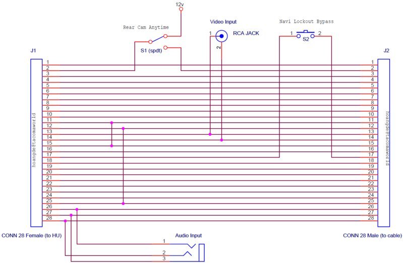

    This is for second gen. I'm not 100% sure it's the same on 3rd gen.upload_2017-1-17_13-41-9.jpg

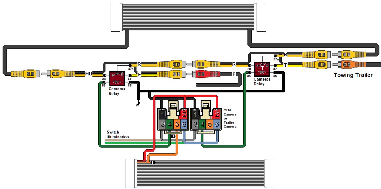

    You'd require a relay to switch the feeds at the bumper connection and a plug for when you have no towing to do.
    Something like this:
    If you don't have the front camera or don't want it, mod to only one relay to choose tailgate or trailer.

  10. May 12, 2023 at 6:13 PM
    caribe makaira
    caribe makaira Well-Known Member
    Feb 13, 2011
    #51121
    11,733
    Caribbean, Puerto Rico
    05 PreRunner TRD Offroad AutoTrans
    Hood Struts, My version Fogs always ON, Map & Overhead Light Mod,
    Firn and pdxTacoSR5 like this.

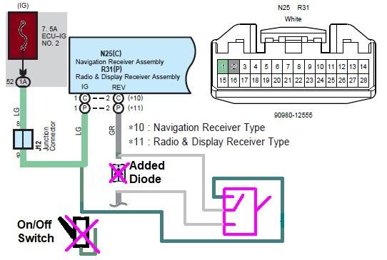

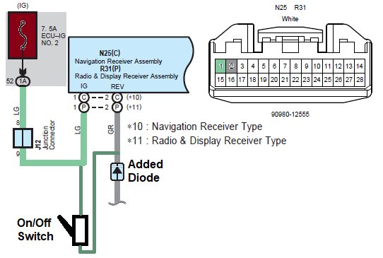

    Caribe Makaira:
    If you use a SPDT switch, you don't need the diode to decouple REV from the rest of the truck when applying +12 to Pin #2.
    I have seen diodes fail in other projects. Rare but it happens.
    And diode fwd bias typically drops voltage by 0.7 V.
    Nice getting +12 from nearby pin 1.

    In my view, allowing the OEM reverse signal function when selected makes an added switch an interference.
  15. May 14, 2023 at 11:09 AM
    pdxTacoSR5
    pdxTacoSR5 Well-Known Member
    Jul 14, 2018
    #259301
    725
    PDX area
    2018 Tacoma SR5, V6 Auto, Access Cab, 4x4, Silver Sky Metallic
    not sure what you mean. maybe i was not clear. i think this is less intrusive to OEM. please forgive artistic failings :)
  16. May 14, 2023 at 11:22 AM
    #16
    caribe makaira
    Feb 13, 2011
    #51121
    11,733
    That would require an ON/ON switch type. The aftermarket switch most have purchased are the ON/OFF/ON type, so that at OFF -OEM takes over.
    The cat can be skinned in so many different ways...:burp:

    Thanks again for all the input. I was able to get the project done today, but there might be a problem I'll get to that in a moment.
    FWIW, putting a diode in as Caribe detailed is necessary. Without it, when to put +12v to pin #2, your backup light illuminate. Also, if you accidentally put the diode in backwards, just sayin', your backup lights will also illuminate.

    The diode is only necessary if you use a SPST switch, as in Caribe Makaira's diagram. If you use a SPDT switch, as in pdxTacoSR5's diagram, it is completely unnecessary. dead horse.

    edit: I happened to look back thru thread and noticed post #3 by cmbondo also used a SPDT switch but I think we all ignored it (at least I did) since it was for Gen 2. Other useful stuff in that diagram too but don't know if applies directly to Gen 3.
