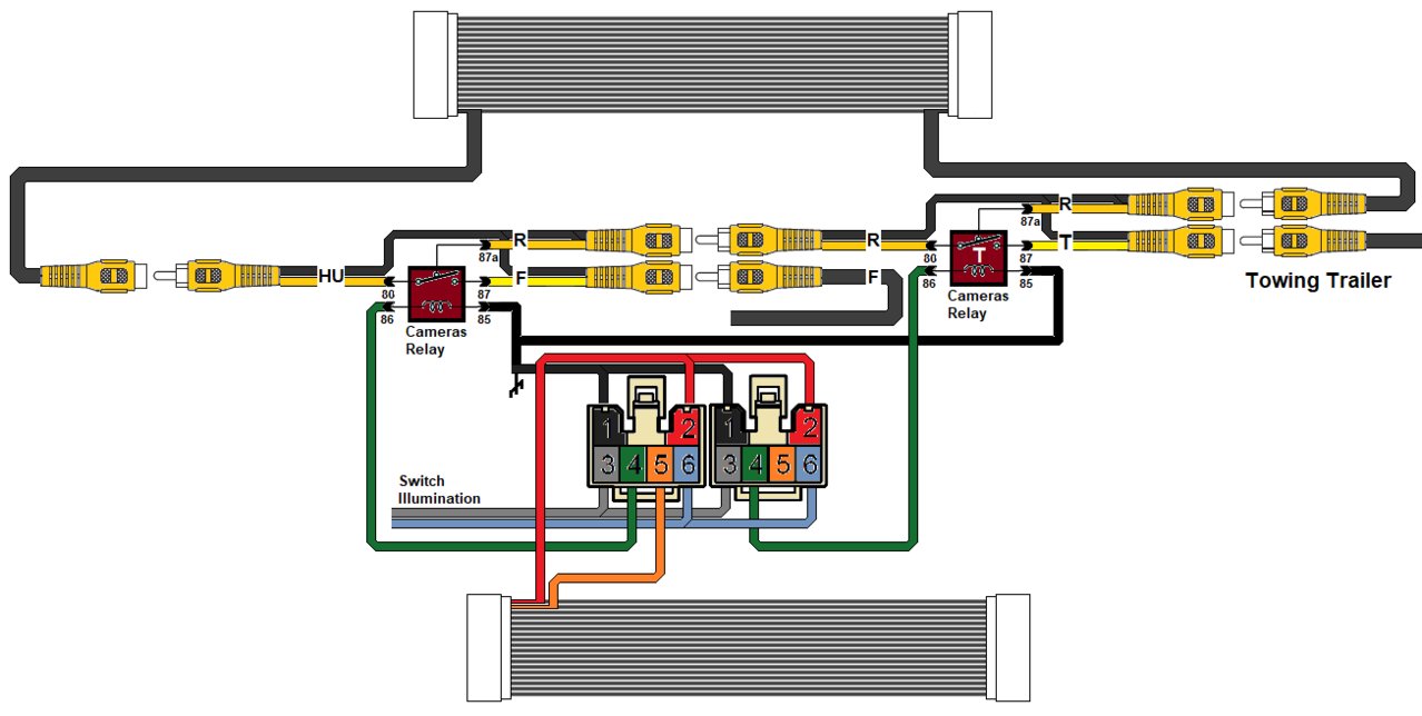

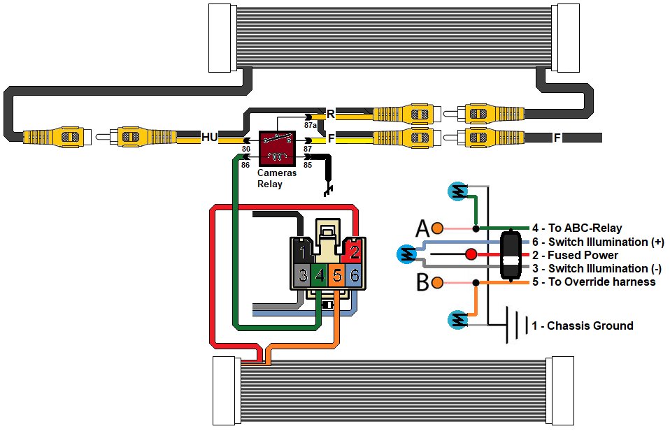

    Added switch and additional ABC relay with RCA pigtails and Trailer (Bed, etc) Camera

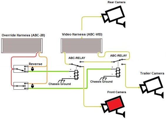

    Anytime Rear Camera selected

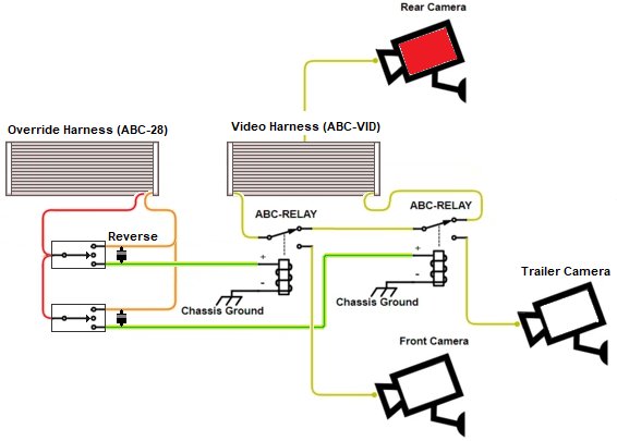

    Anytime Front Camera selected

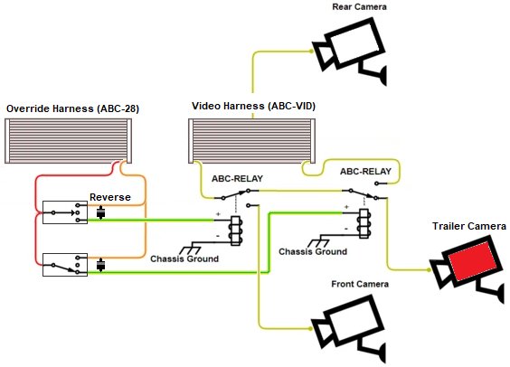

    Anytime TRAILER camera selected
    Trailer camera cable can be routed to rear bumper, to be attached when needed. Lots of choices for camera cable, camera choice...
