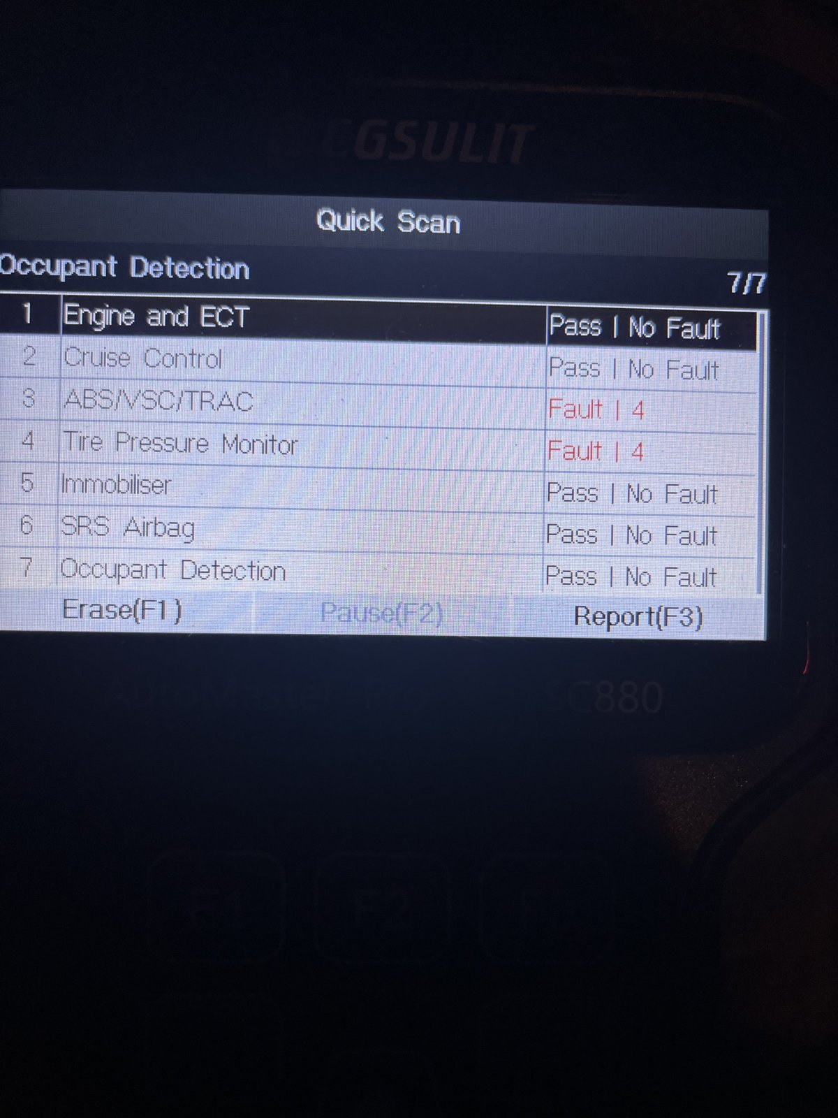

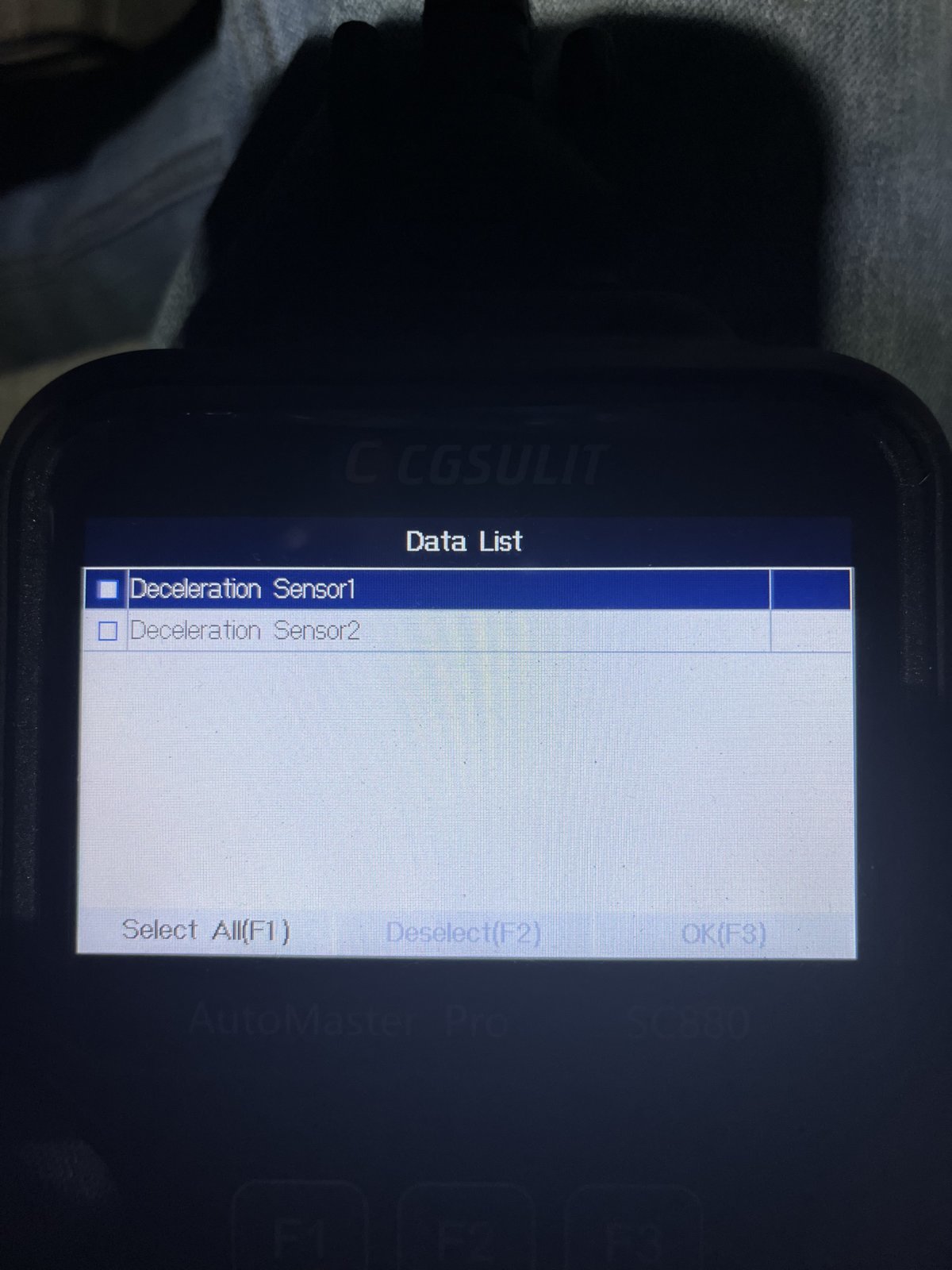

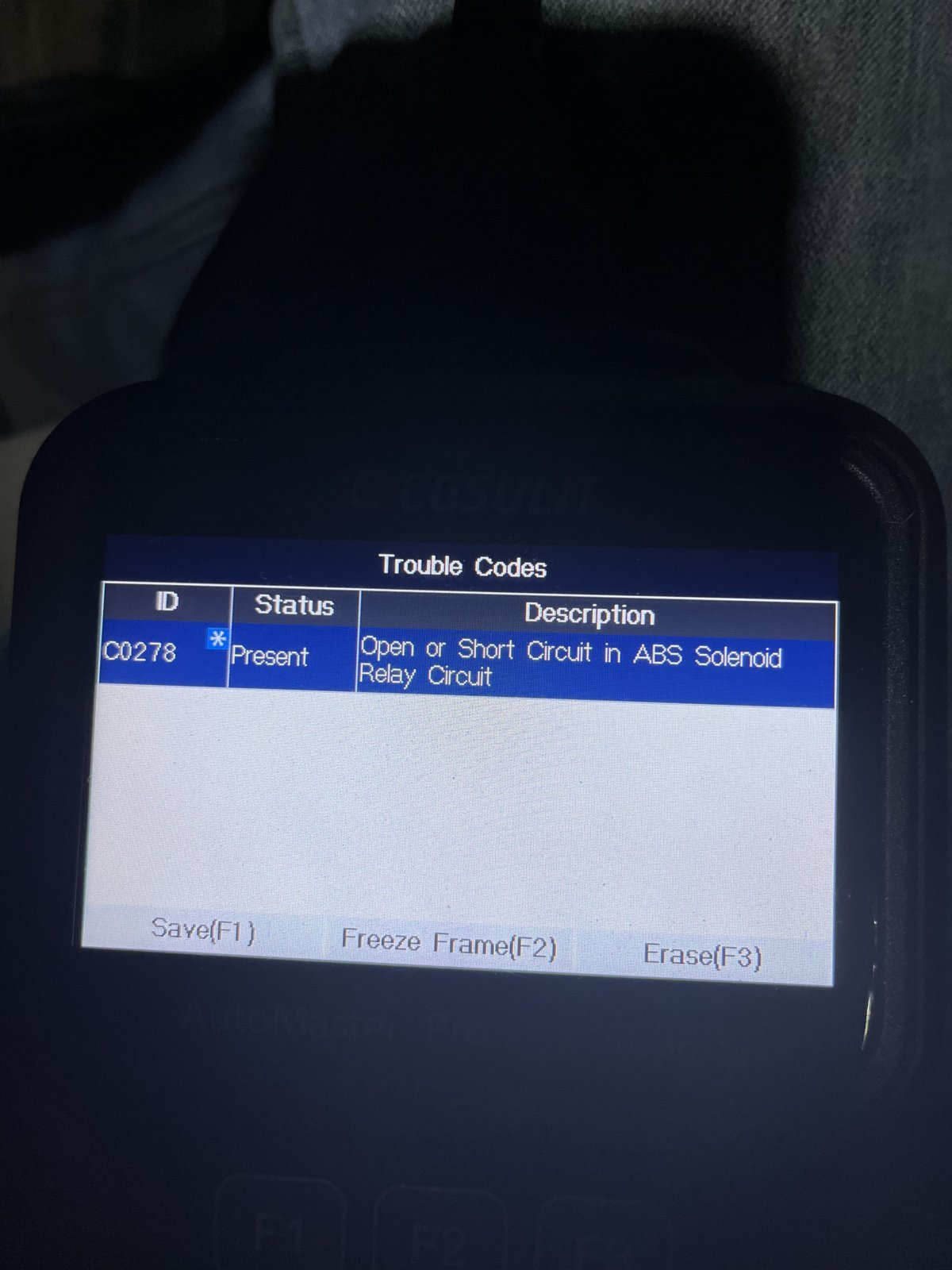

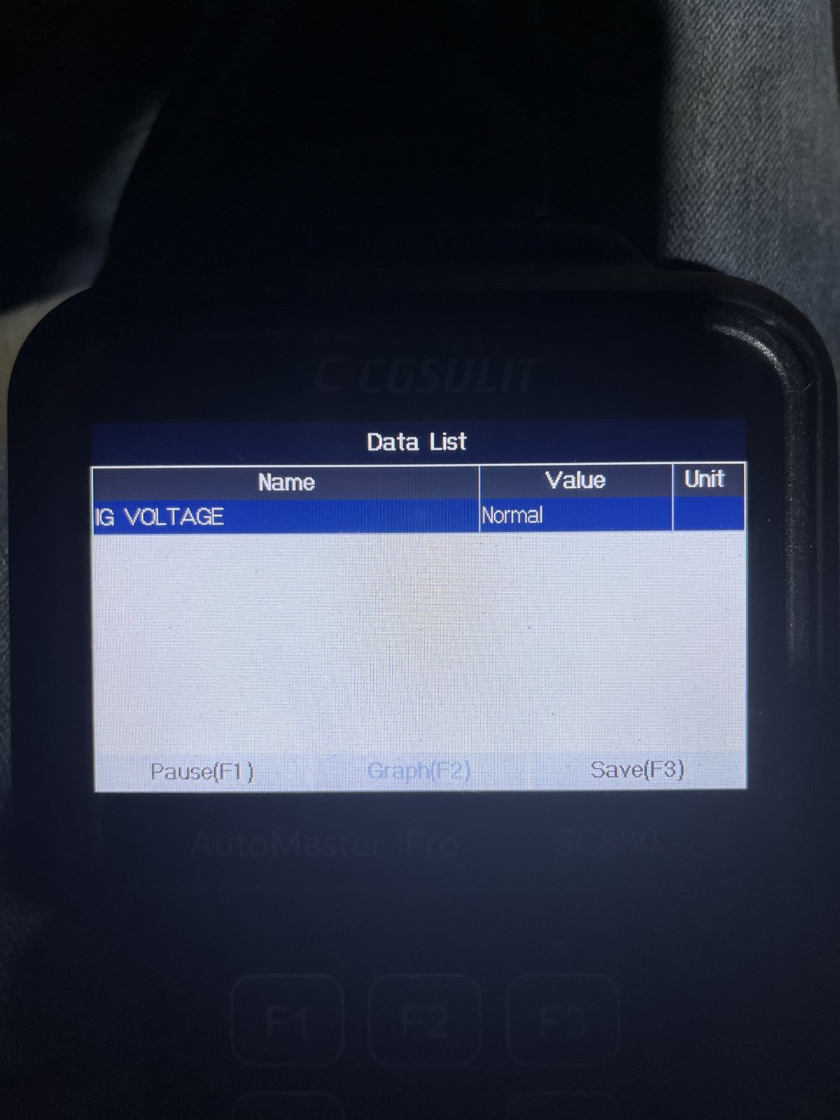

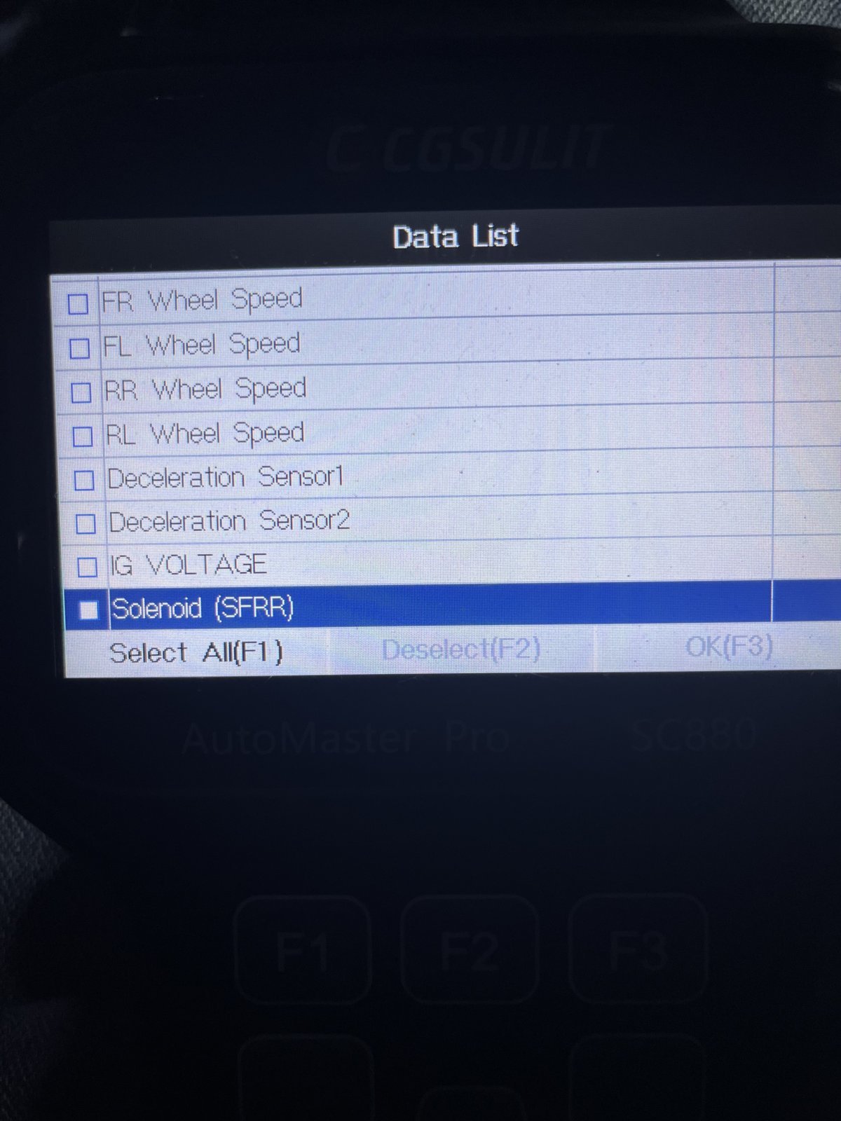

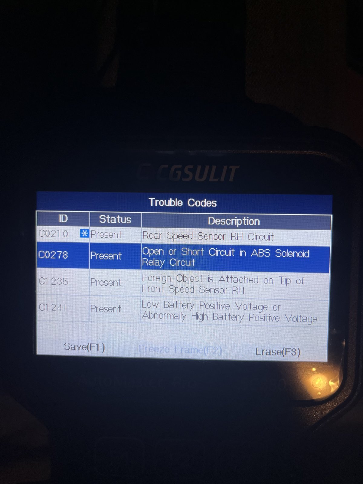

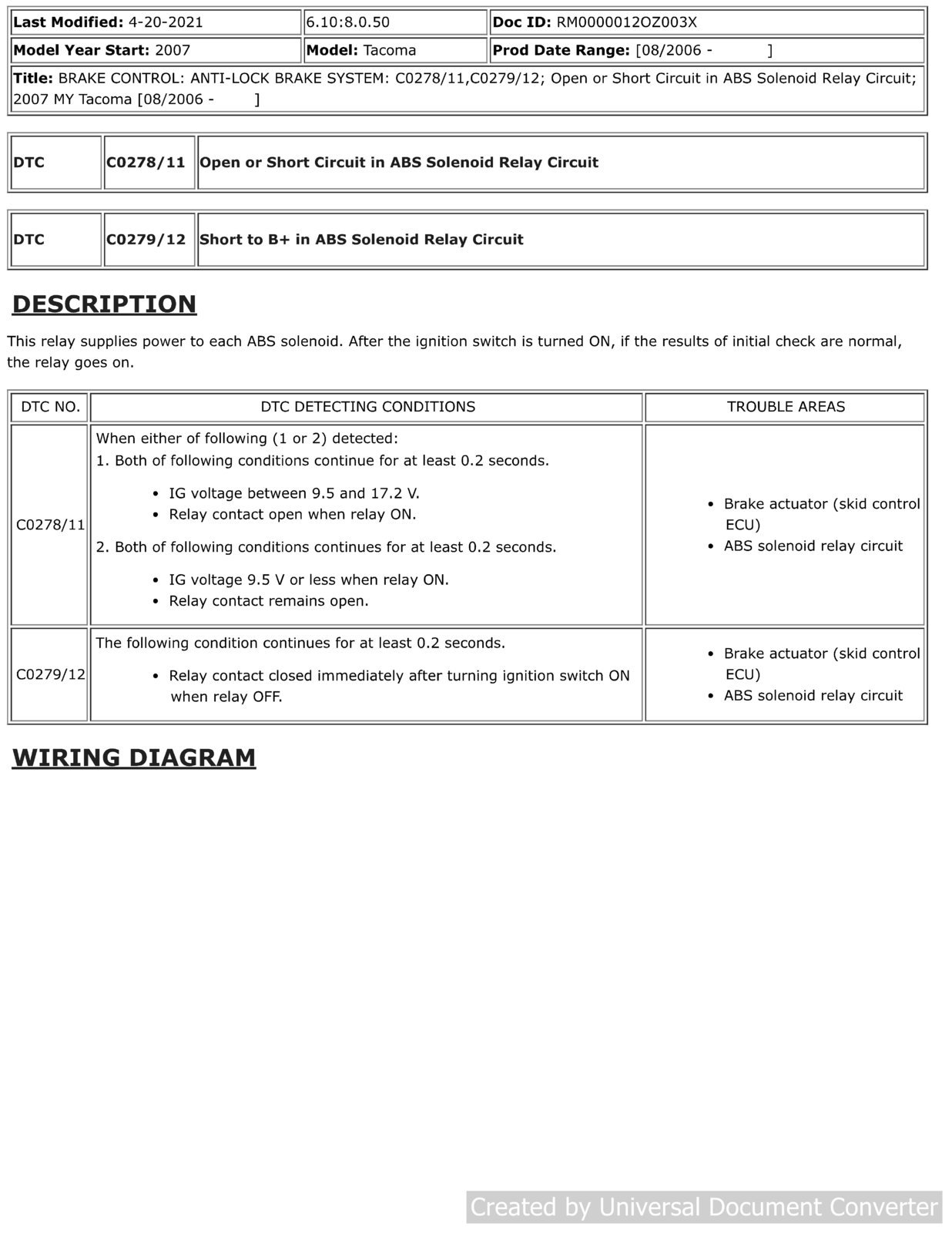

    So those codes all come back immediately if you clear them even when the fuses are installed?

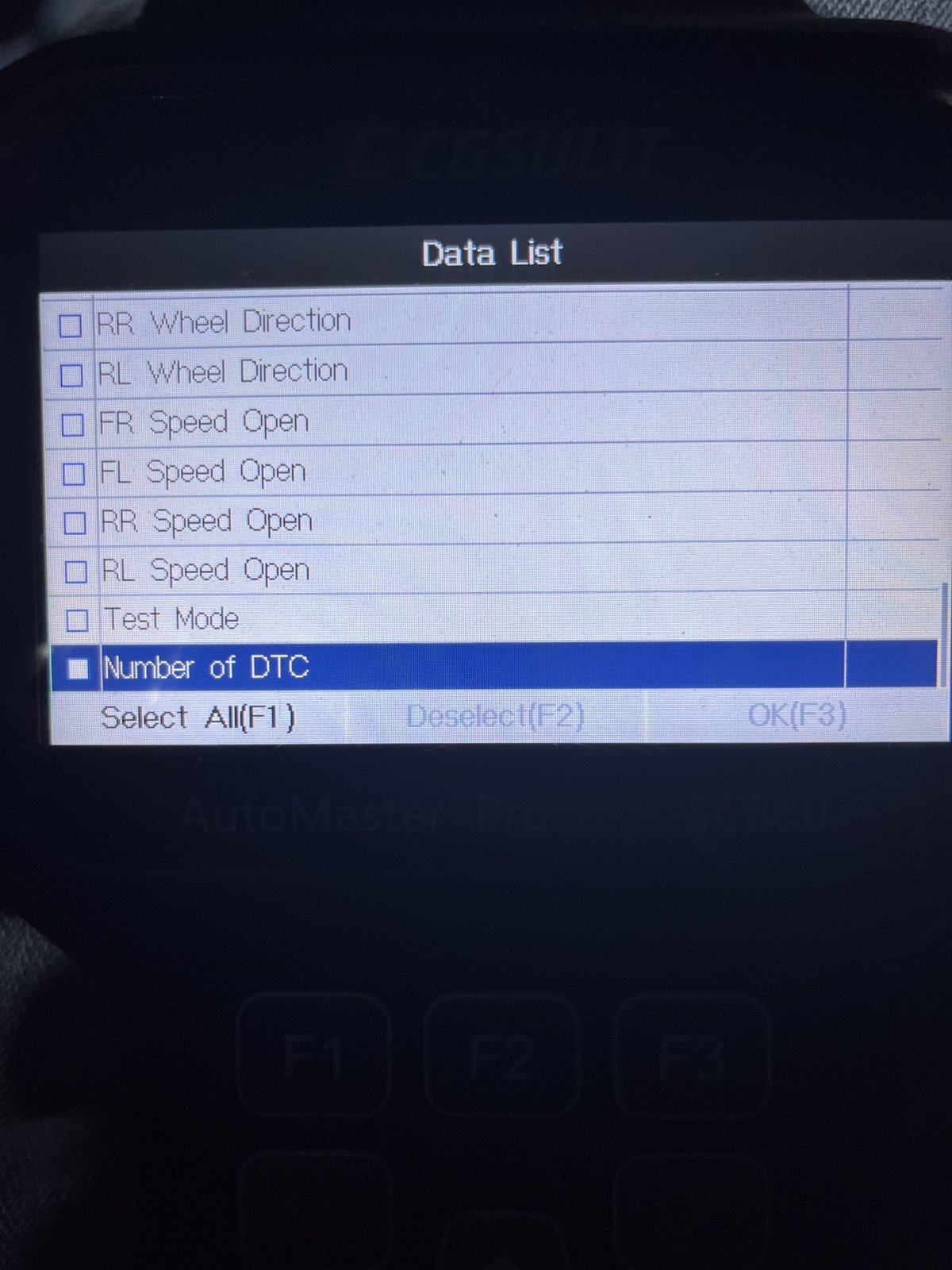

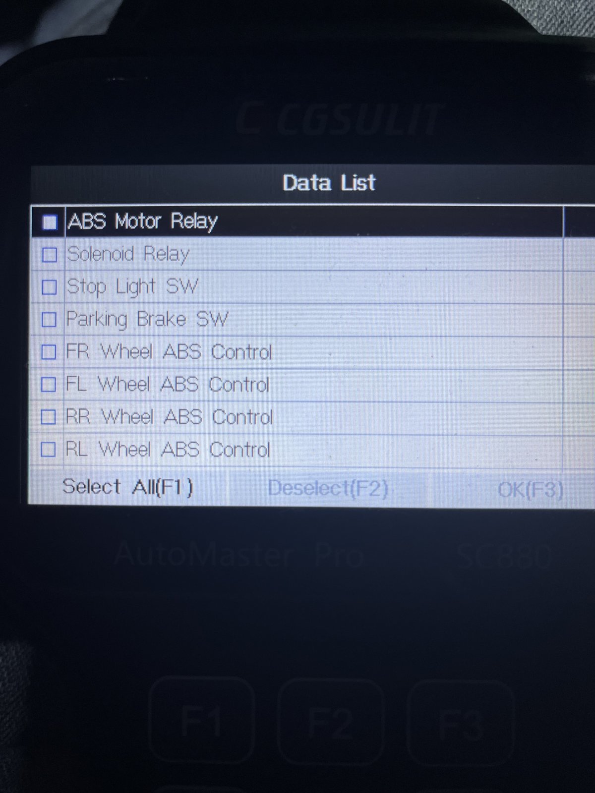

    Do you have wheel speed sensors and IG voltage in your data list?

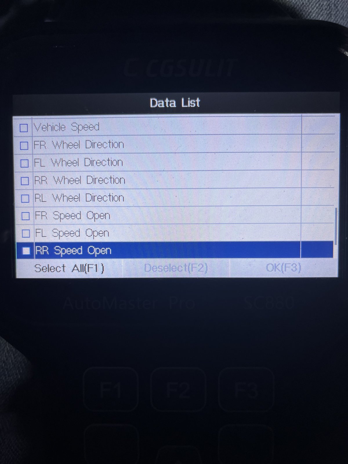

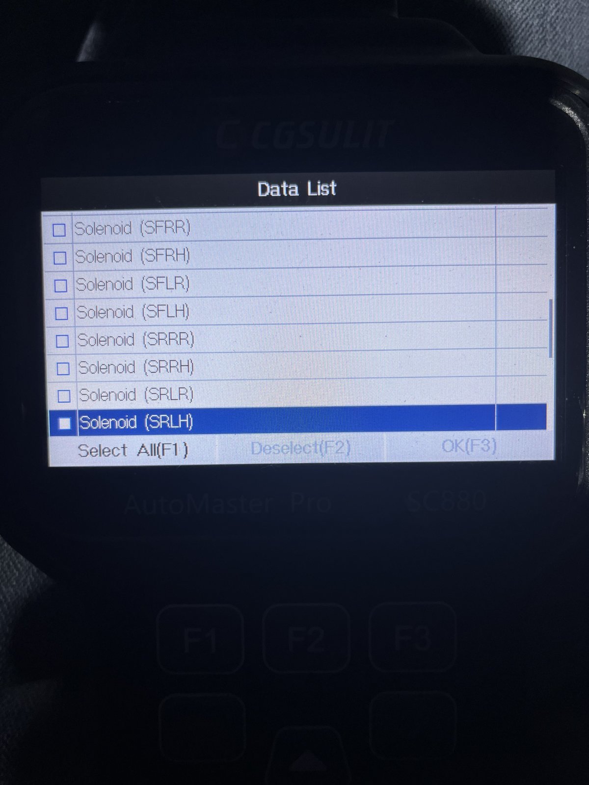

    2007 Toyota Tacoma

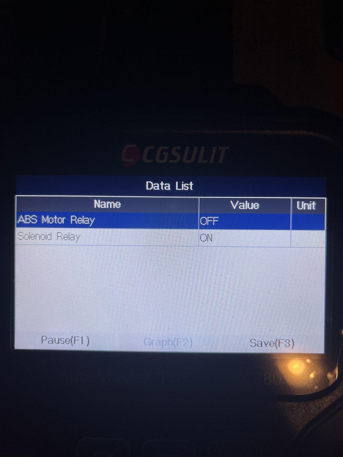

  6. Oct 13, 2023 at 6:55 PM
    #26
    Dm93
    Dm93 Test Don't Guess
    Mar 3, 2015
    #150066
    13,390
    Texas
    2014 DC OR 6spd 4x4
    Predator tube steps, Ranch Hand grill guard, Magnaflow CatBack exhaust, Toyota tool box & bed mat, 2LO Module by @Up2NoGood, Rearview Compass/Temp Mirror, Tune by @JustDSM.

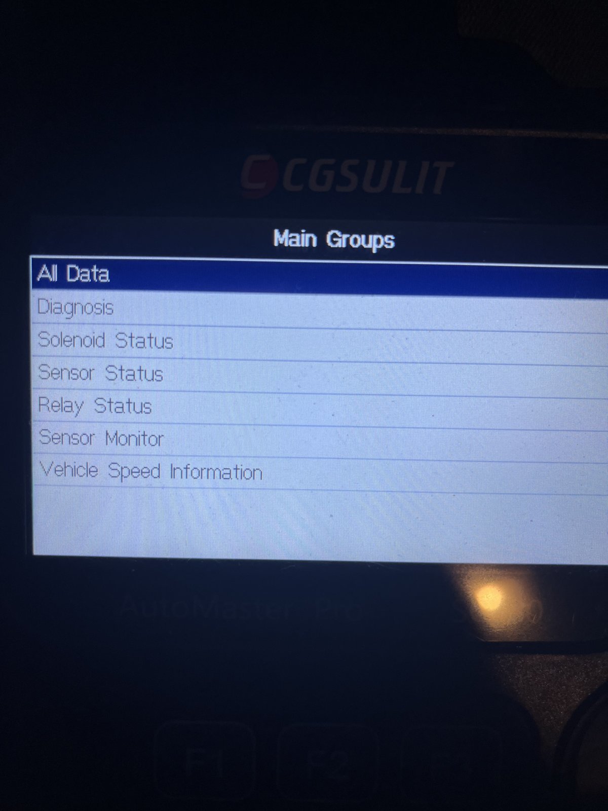

    Click all data.

    Last picture is with the fuses pulled and cleared and that code still shows there instantly.

    Well since the C0278 is persistent let's see if we can diagnose that first although I still don't see how that would affect your base brakes.

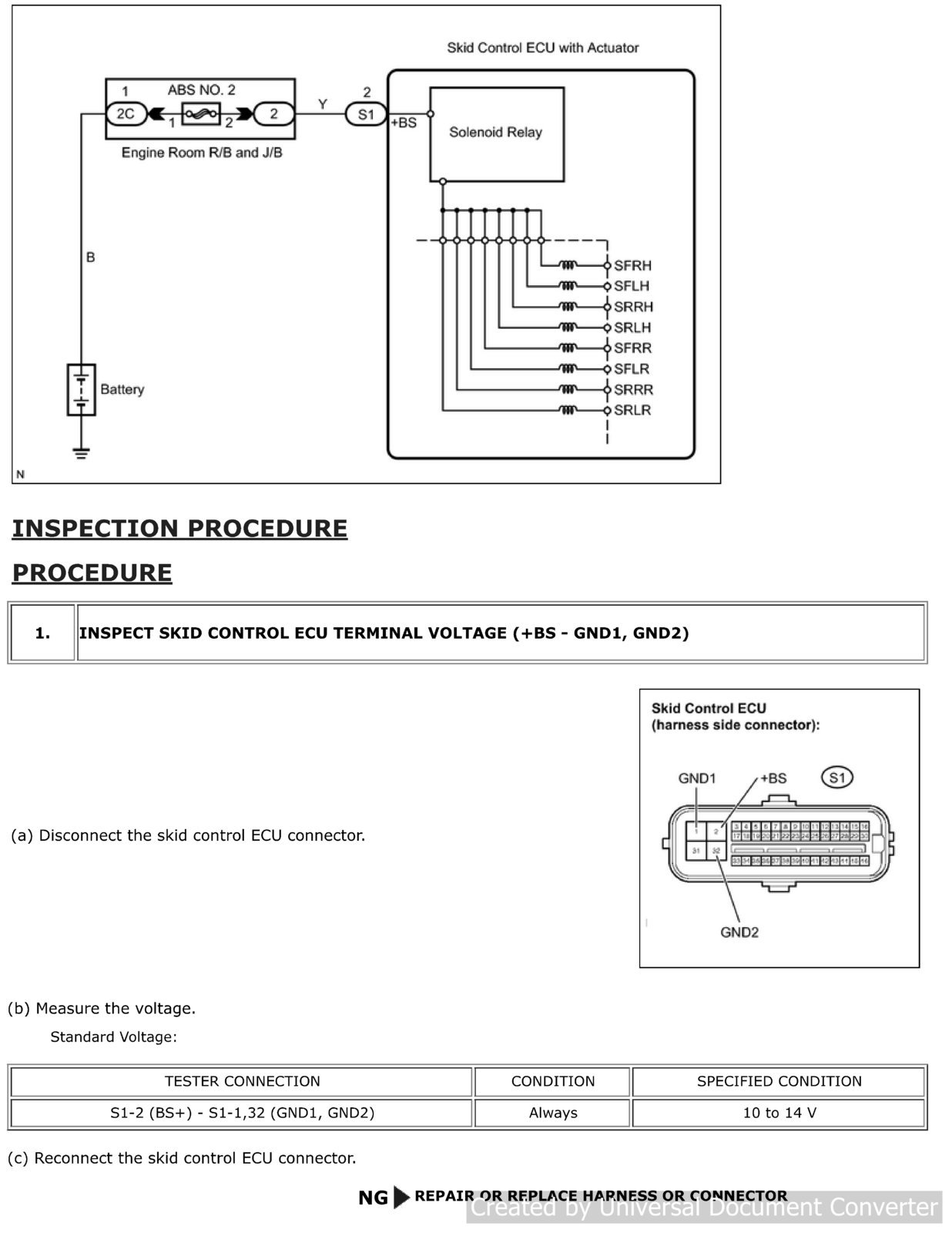

    Well check your powers and grounds, I posted it above.

    Any voltmeter should be sufficient, grab you a test light too.

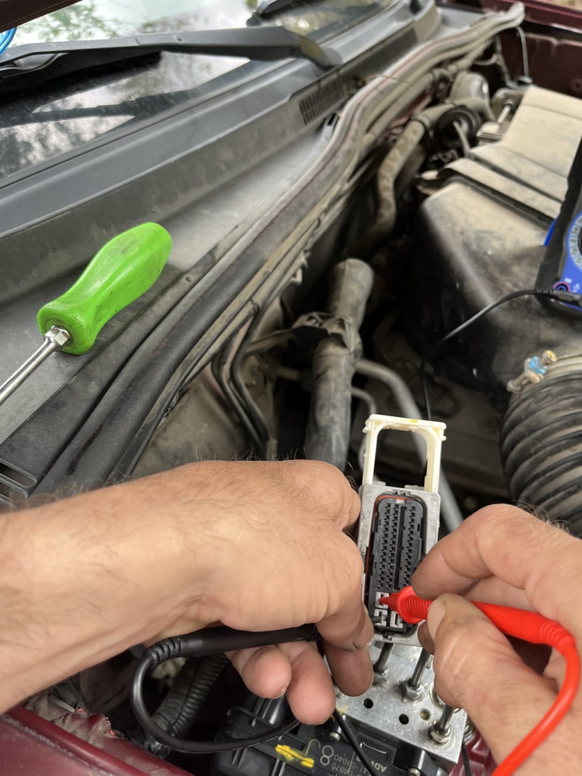

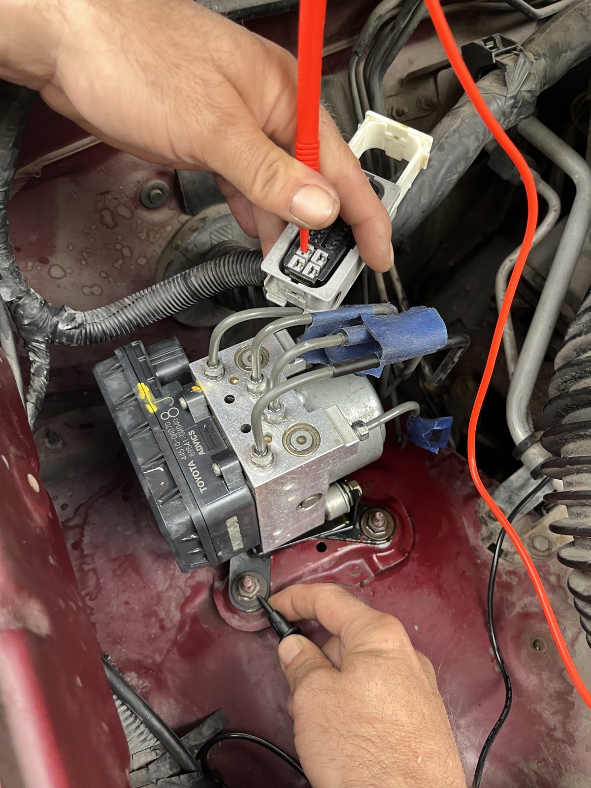

    And be careful not to shove anything into the connector and spread the terminals, all you need to do is touch the metal part of the pins.

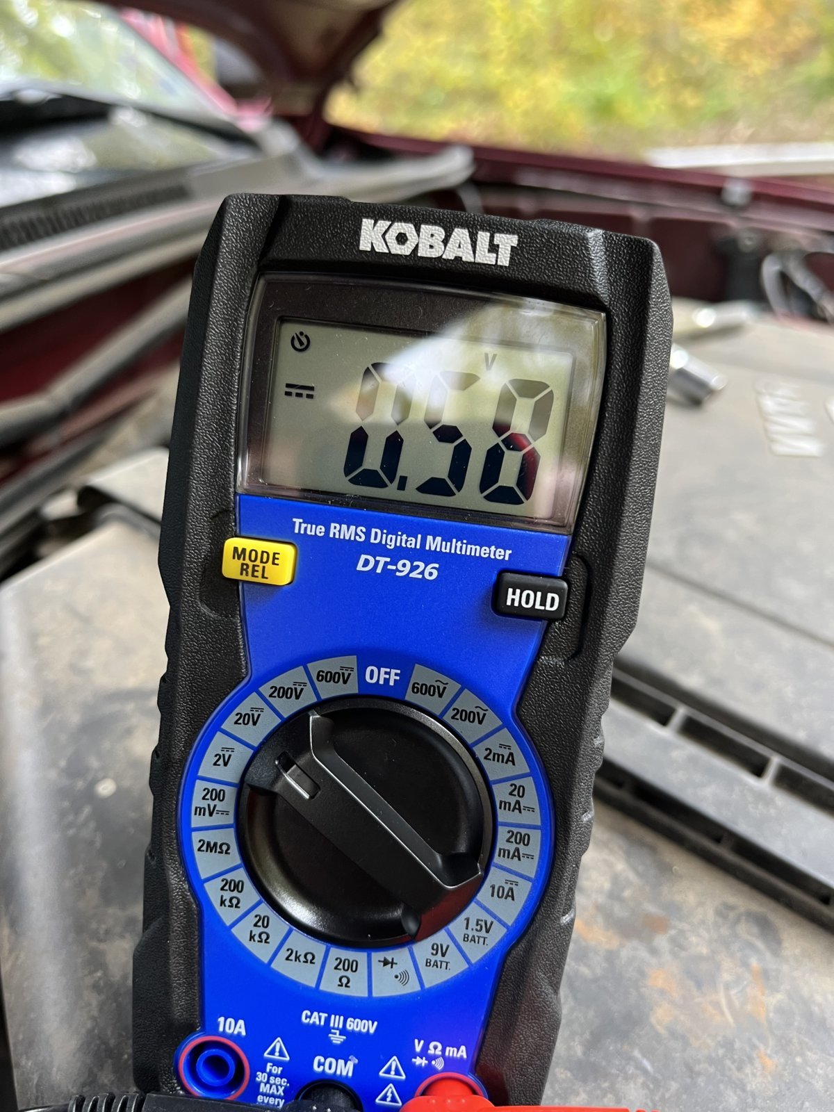

  17. Oct 14, 2023 at 12:21 PM

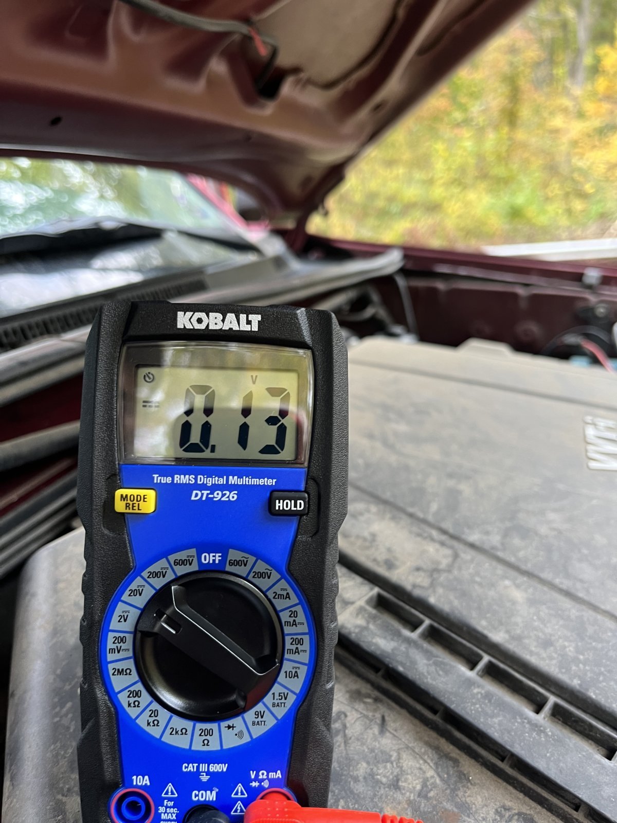

    Hope I’ve done this right.

  18. Oct 14, 2023 at 12:33 PM

    Also the longer you hold it the lower the number keeps dropping.

    Looks like your on the right pins, your fuses are installed correct?
    If so go from the B+ pin to a good body ground and see what you have.

    Yes they are installed correctly.
