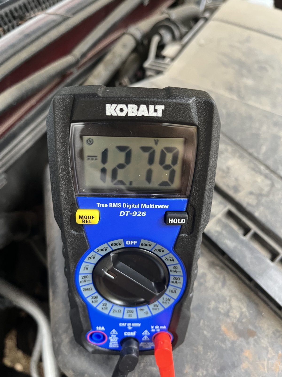

    All new numbers.

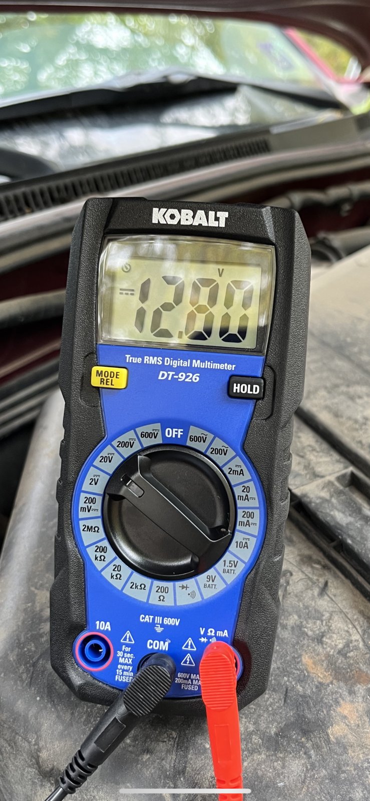

  5. Oct 14, 2023 at 1:06 PM
    #45
    Dm93
    Dm93 Test Don't Guess
    Mar 3, 2015
    #150066
    13,390
    Texas
    2014 DC OR 6spd 4x4
    Predator tube steps, Ranch Hand grill guard, Magnaflow CatBack exhaust, Toyota tool box & bed mat, 2LO Module by @Up2NoGood, Rearview Compass/Temp Mirror, Tune by @JustDSM.

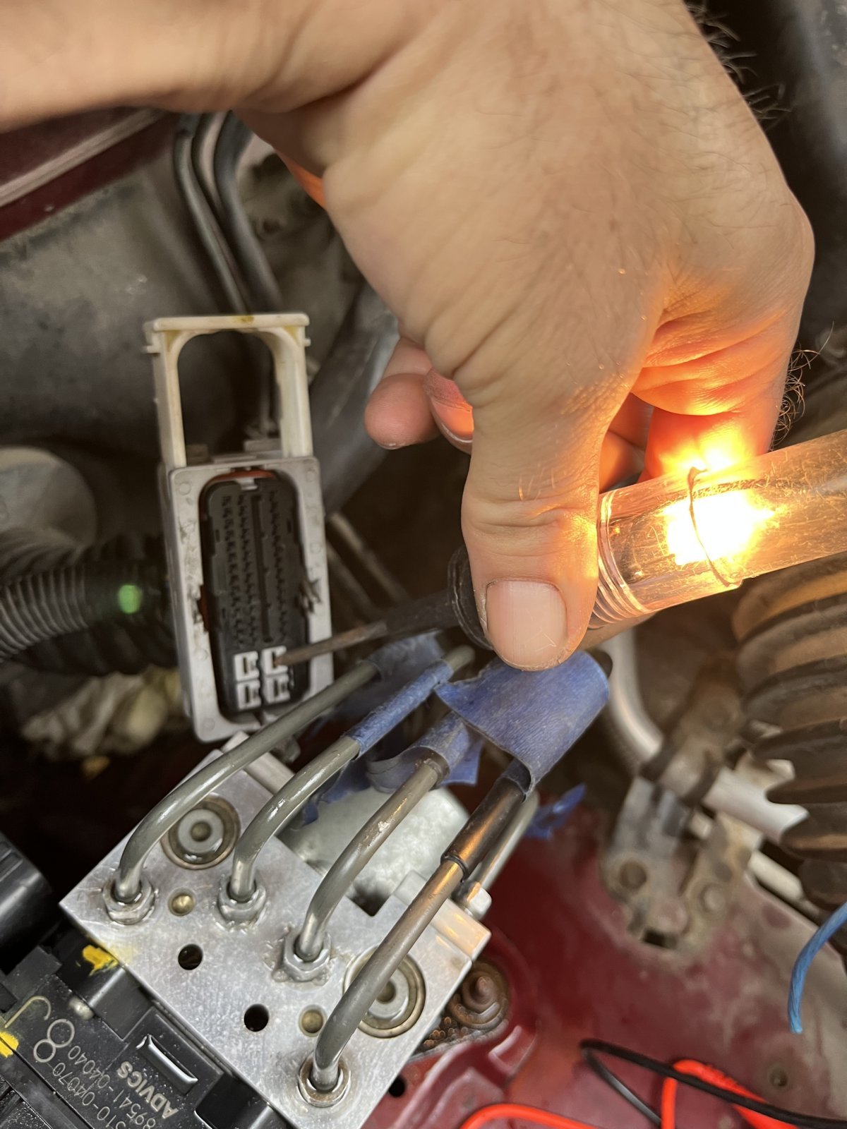

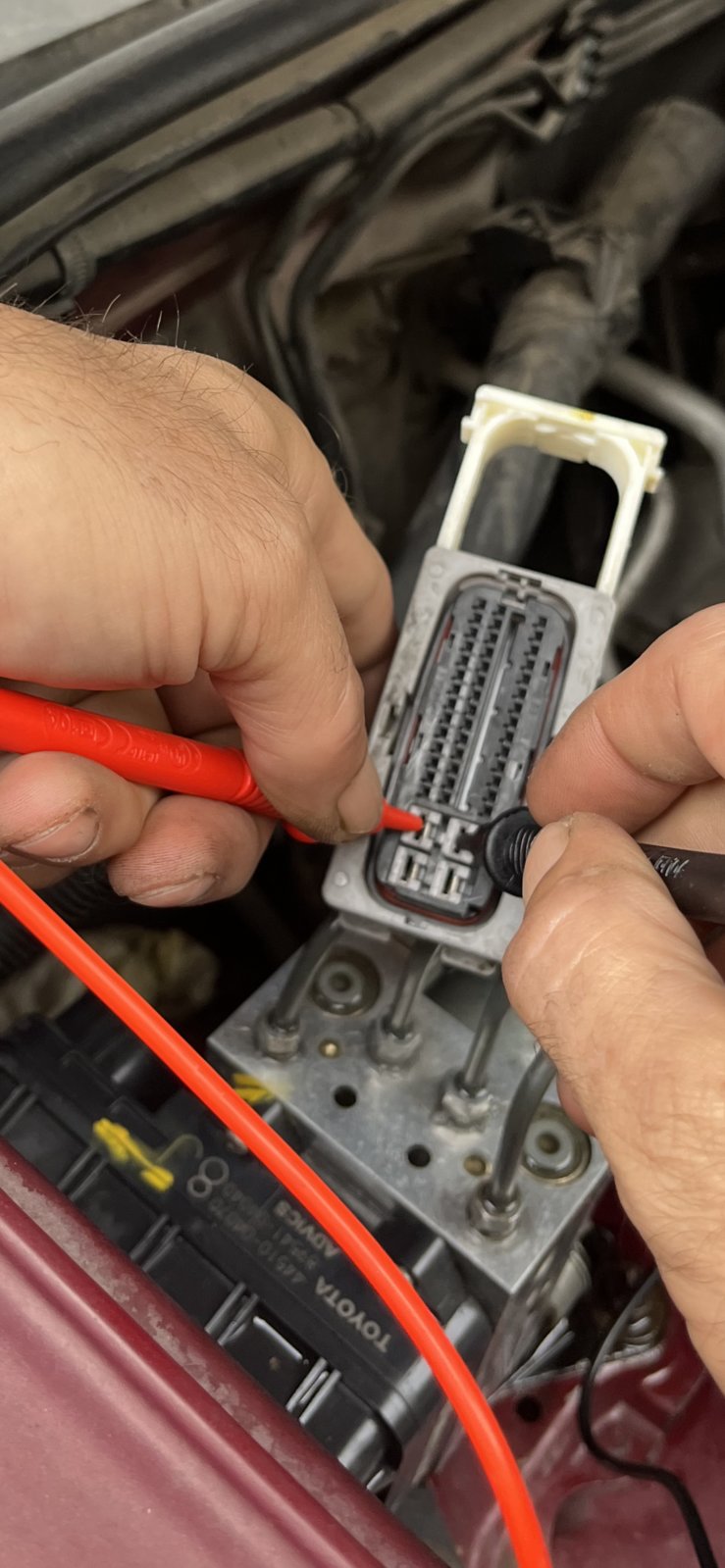

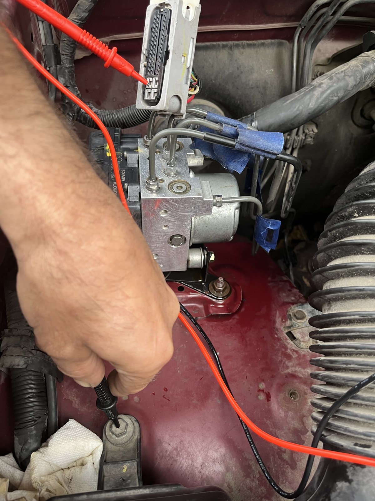

    So you have battery voltage there, that's good. What about from B+ to the other ground pin?

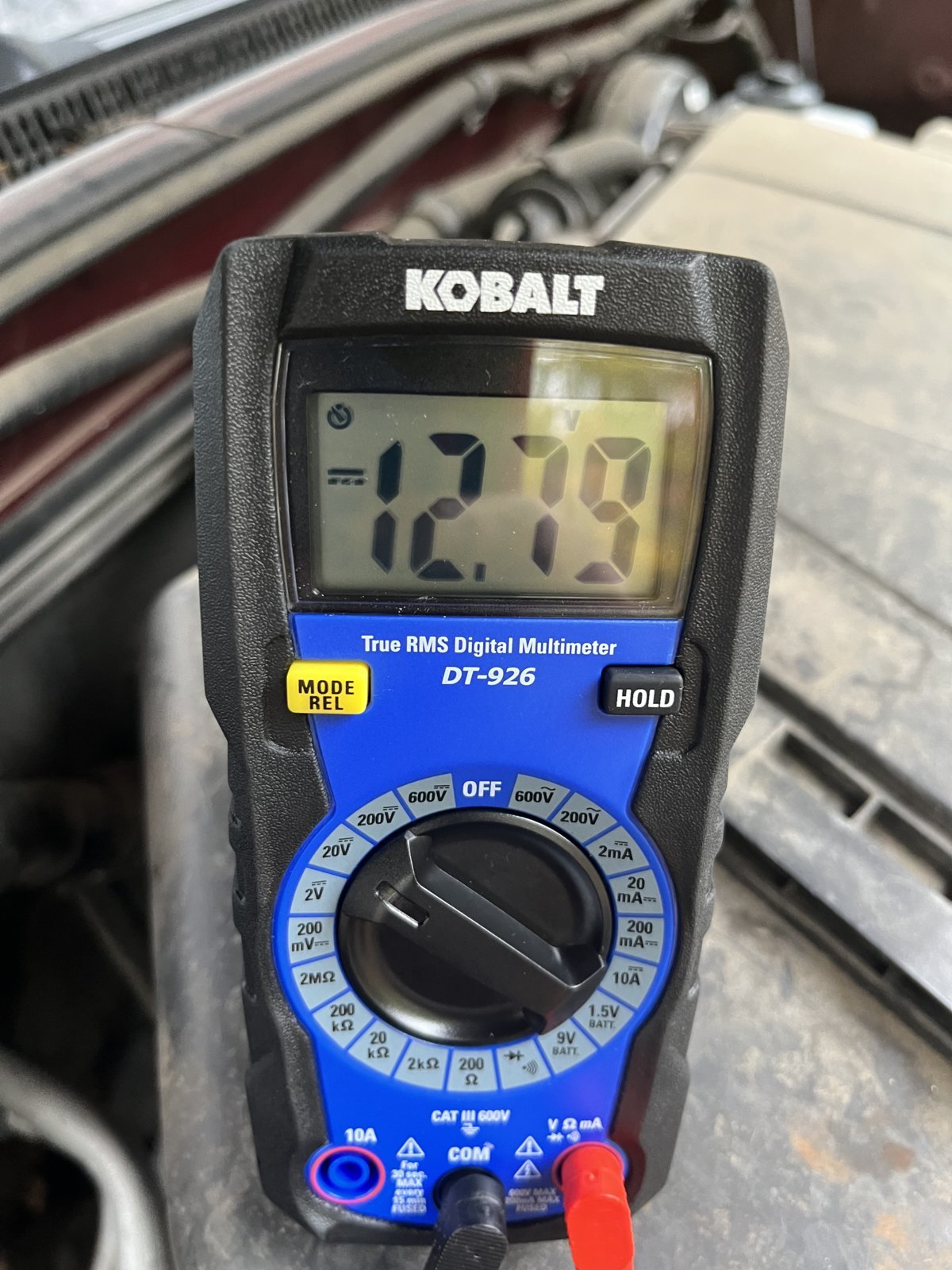

  6. Oct 14, 2023 at 1:13 PM
    #46
    Steel Mill
    Steel Mill [OP] Well-Known Member
    Jun 2, 2022
    #398598
    135
    Greg
    2007 Toyota Tacoma

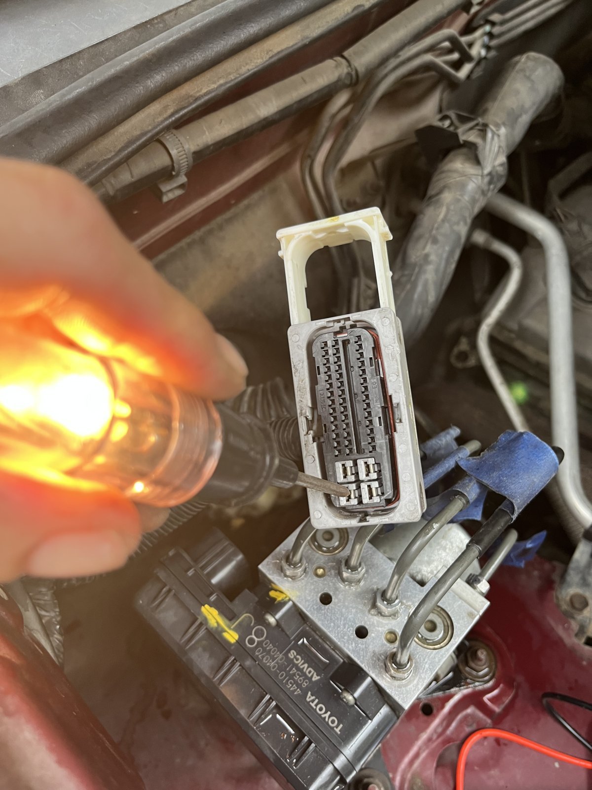

  7. Oct 14, 2023 at 1:17 PM

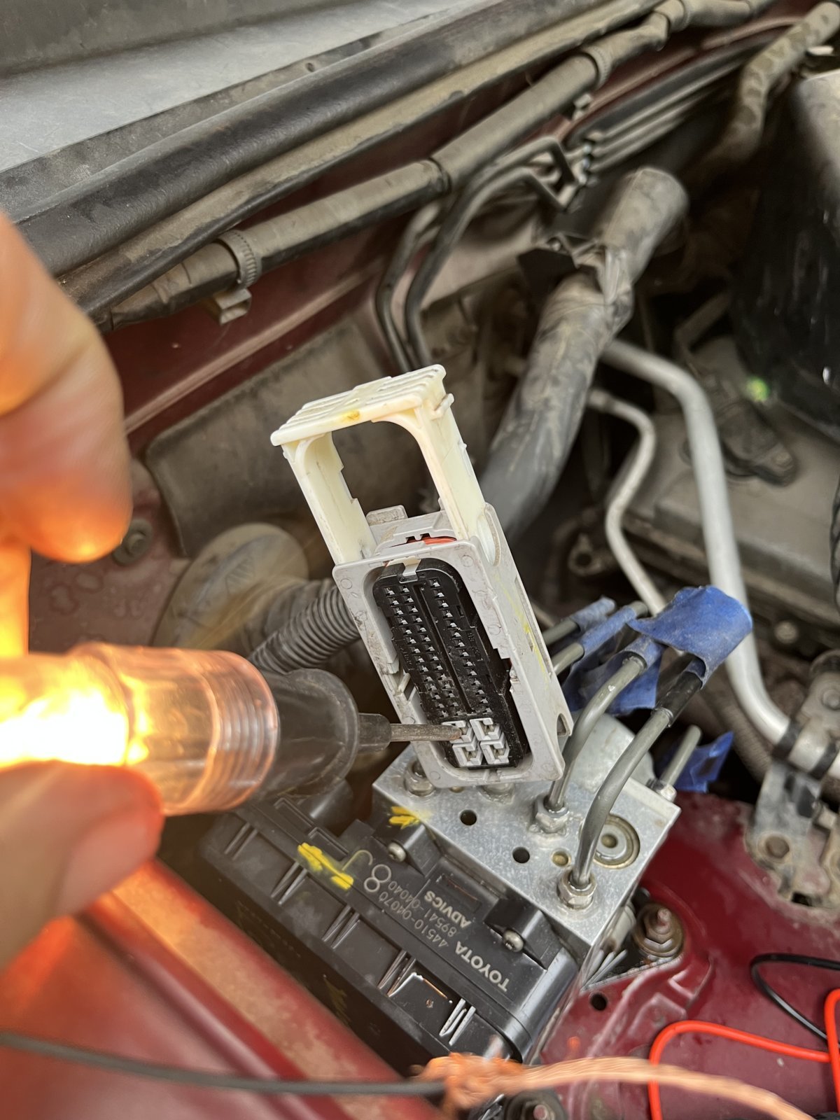

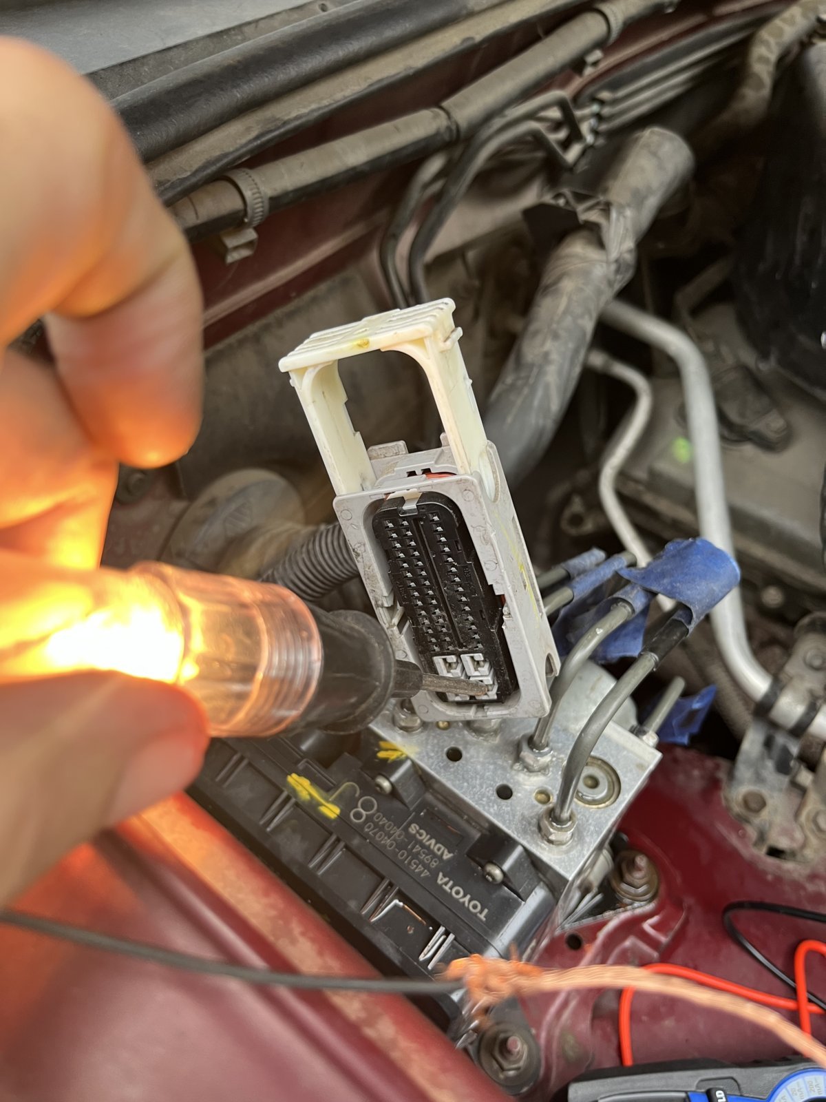

    Will the B+ pin light a test light connected to ground and the 2 ground pins light a test light connected to battery positive?
  8. Oct 14, 2023 at 1:27 PM
    #48
    Steel Mill
    Jun 2, 2022
    #398598
    135
    Greg
    2007 Toyota Tacoma
  9. Oct 14, 2023 at 1:37 PM
    #49
    Dm93
    Mar 3, 2015
    #150066
    13,390
    Texas
    2014 DC OR 6spd 4x4
    Certainly would appear you have a bad ABS module then since that code is persistent, I'm still not fully convinced that is your braking problem though.
    Did the original module have the exact same code and symptoms?
